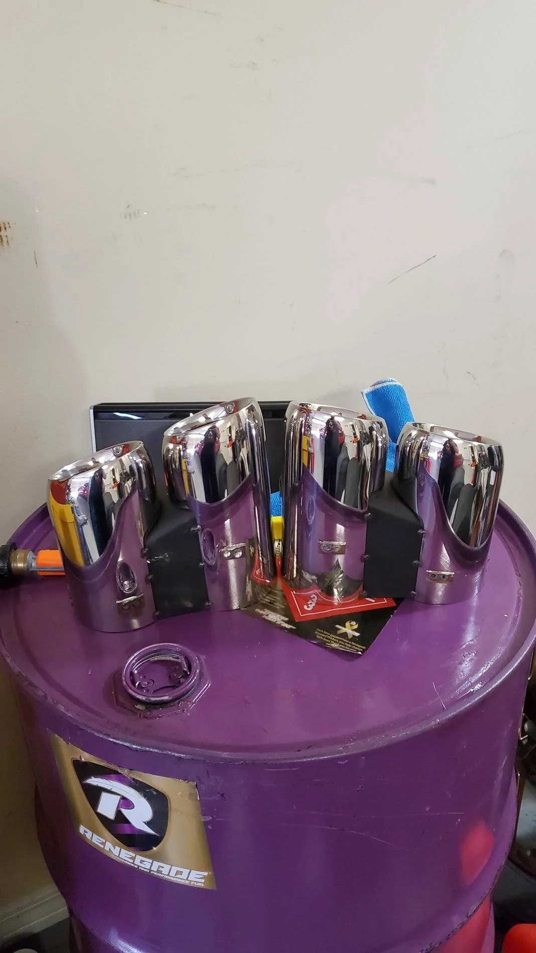

Sorry for the delay. Work and new born have occupying my time. But I finished modifying the tips this morning and I'm debating on buying a cheap welder and doing a couple tac welds to hold them on. Or wasting time at a muffler shop.
I was cutting the tabs off the tips and my 6yr old dremel crapped the bed so I grabbed a new one yesterday. Very happy with the upgrade.
I tried a Sawzall first but I was going to end up ruining the tips.

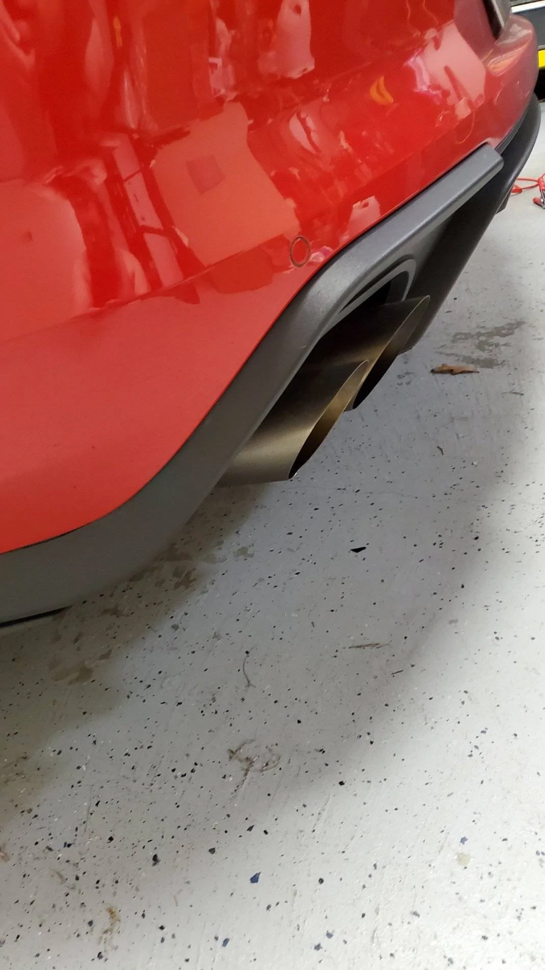

I cut the tabs off mine and slipped them on.... Super tight, wont slide completely on but close. Gonna have to re adjust my exhaust so the mufflers are in further. I do believe they will work, However, I plan to add more weld to the black areas that are tacked, inside and out. Then I was gonna add some exhaust wrap to the stock tips to make it tight, but they are very tight already so not needed. I was thinking once I add more weld to the tacked spots that I could drill a hole top and bottom of the black area and use some type of bolt set up to pull the top and bottom together therefore sandwiching on the stock tips. Then I will cerakote them black once they are ready. I think it should work.

The inner tip hits the inside of the rolled edge.
My mufflers are pulled further back than stock, so that's why I will have to adjust mine. They're about 1.5" further back than stock.
