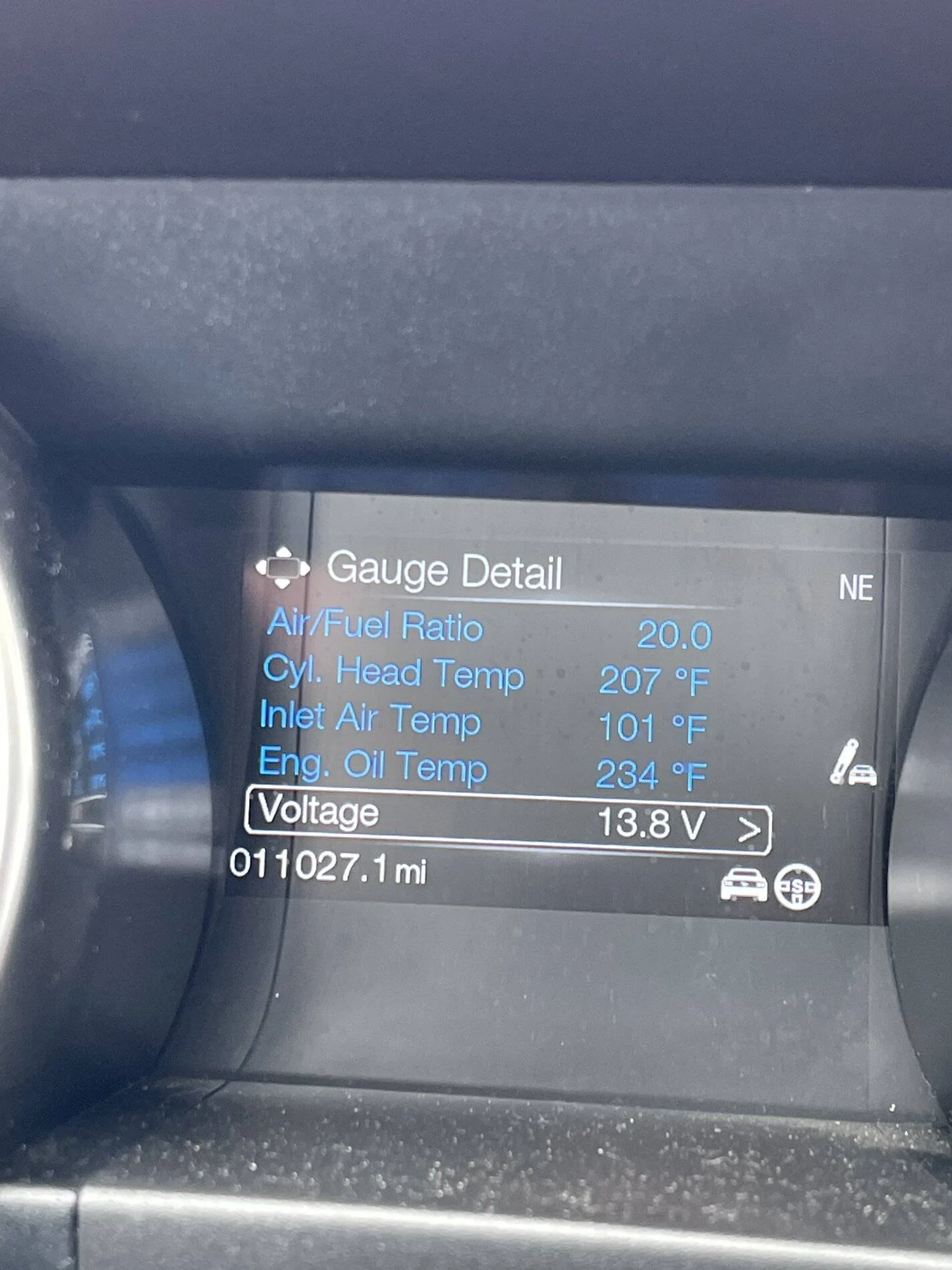

This was some of my gauges when it happens. However I have seen the cylinder head temp at 230° and my oil temp around 250°
Those temperature readings seem within range, at least that's what I've seen after some heavy driving. What seems out of range is the air/fuel ratio. From what I recall, I think I'm used to seeing something in the 13-14 range. 20 means it's very lean, which would cause low power.
I swear it was around 13 right before I took the picture. I’ll have to watch that
