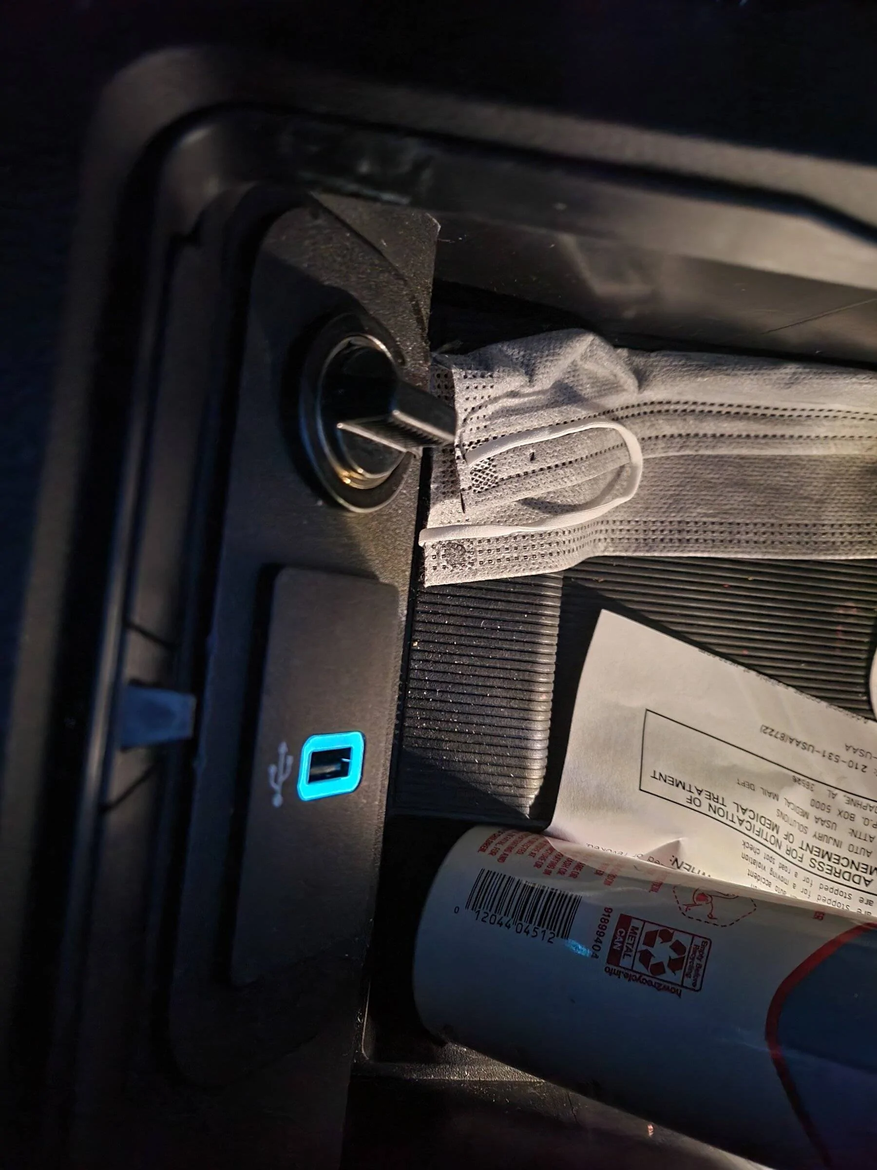

The USB port in the center console has a white-ish clear bezel on the android auto cars and a black bezel on non android auto capable cars

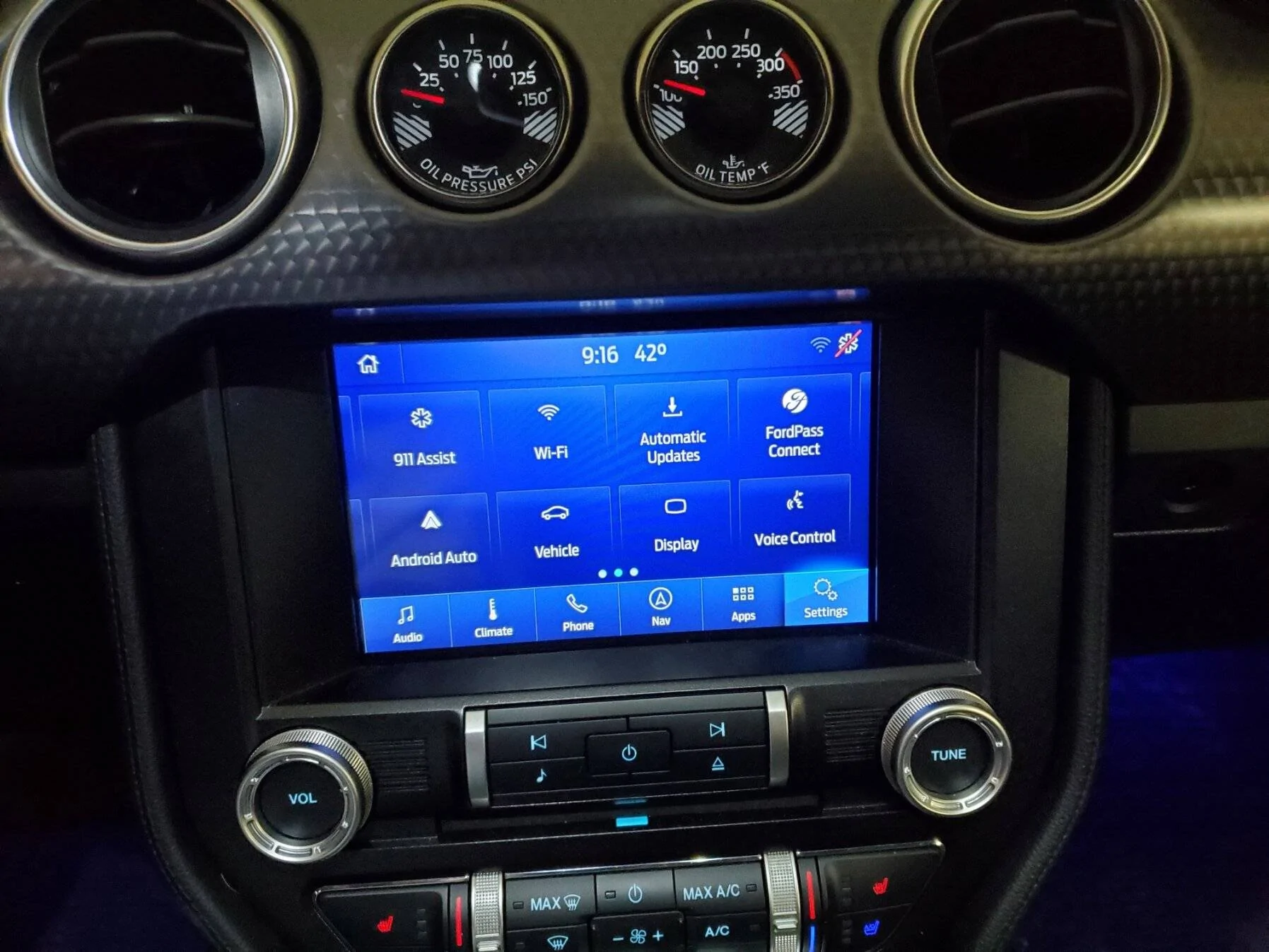

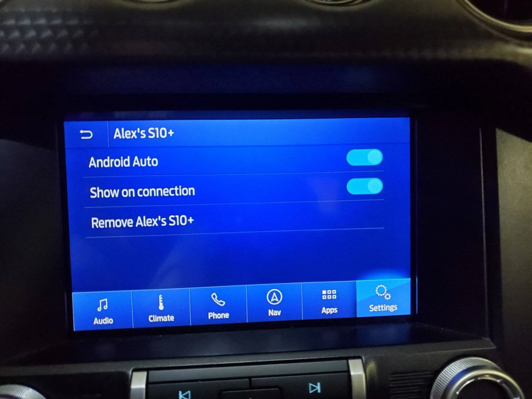

That's weird. You could try resetting your head unit to factory and try plugging in your phone again. Maybe you missed a prompt?
If that doesn't work your best bet might be to take it to a dealership with a good service center.
Below is how it is on my car.
USB:
Settings:
When I clicked on Android Auto.

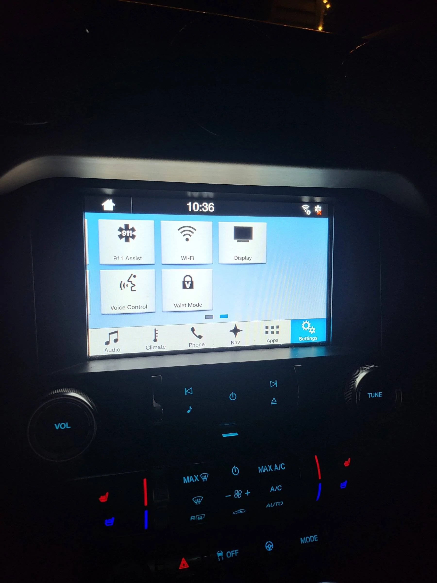

Tried again, mine still looks a little different since it's older but no AA. Cable is good and works for AA in a newer Lexus and Ram

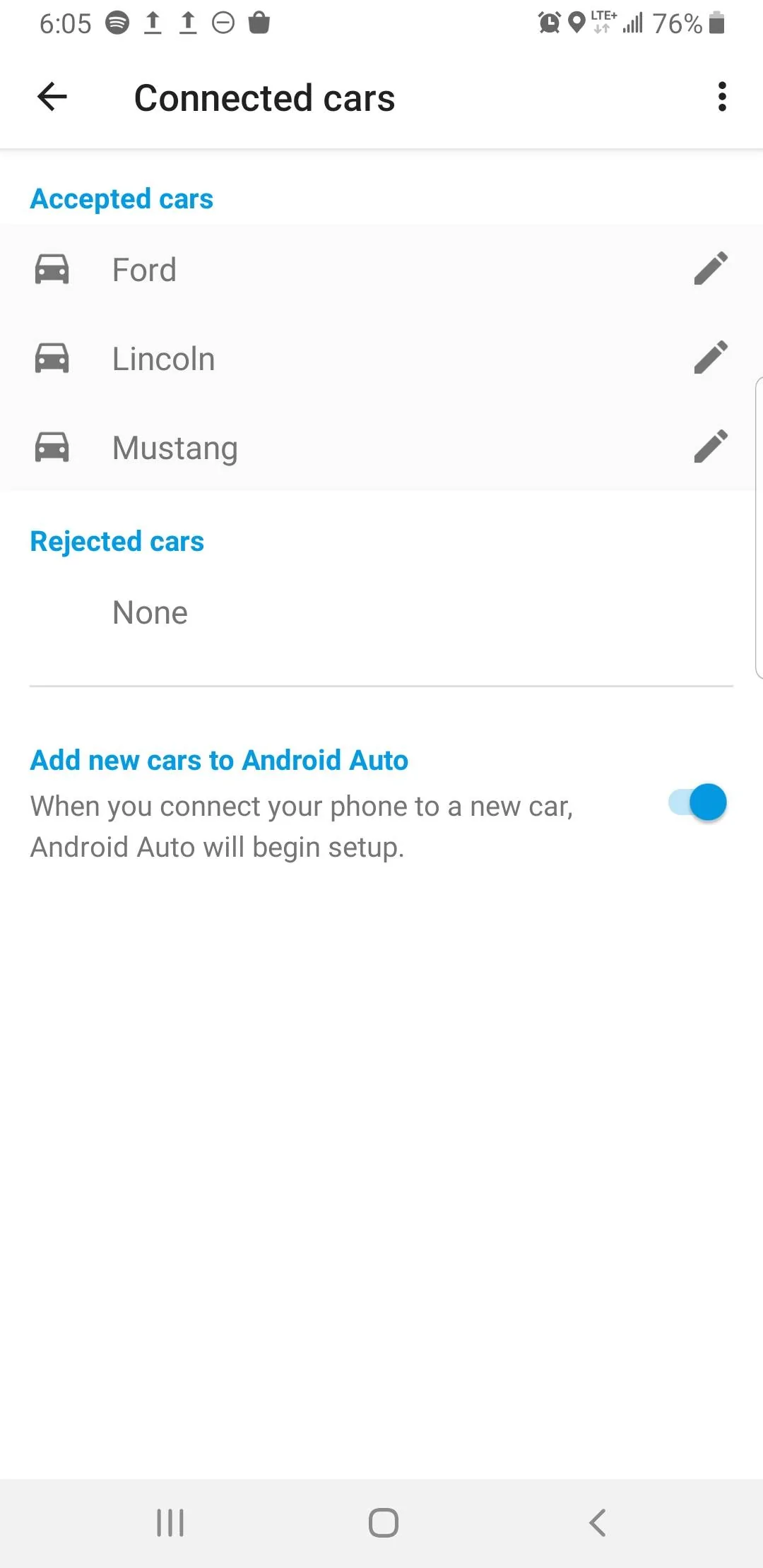

Before connecting the USB cable. Open Android Auto on your phone and go to settings.
The tap on "connected cars".
On this screen make sure "Add new cars" is ON.

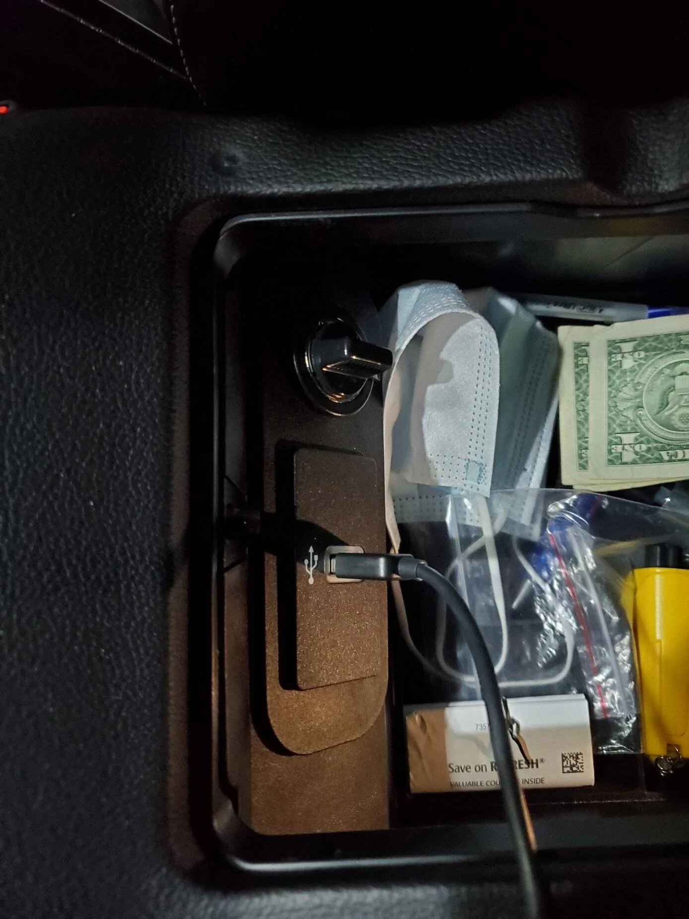

The 2016 models require a USB hub upgrade for Android Auto and Carplay. You can a new hub from Ford and it installs in your center armrest storage area. Once you have the upgraded USB hub, you'll be good to go from both USB ports. (the one below the dash is connected through the one in the armrest.
+19...
The USB hub is the fix. 5 minute install. Remove the hub in the armrest console and plug in the new one and you’re golden!
Removing the old USB was the first time I used a butter knife when working on a car. Fantastically effective.
OP, I’m voting with the masses here: scoop the new USB hub and give it a go.
