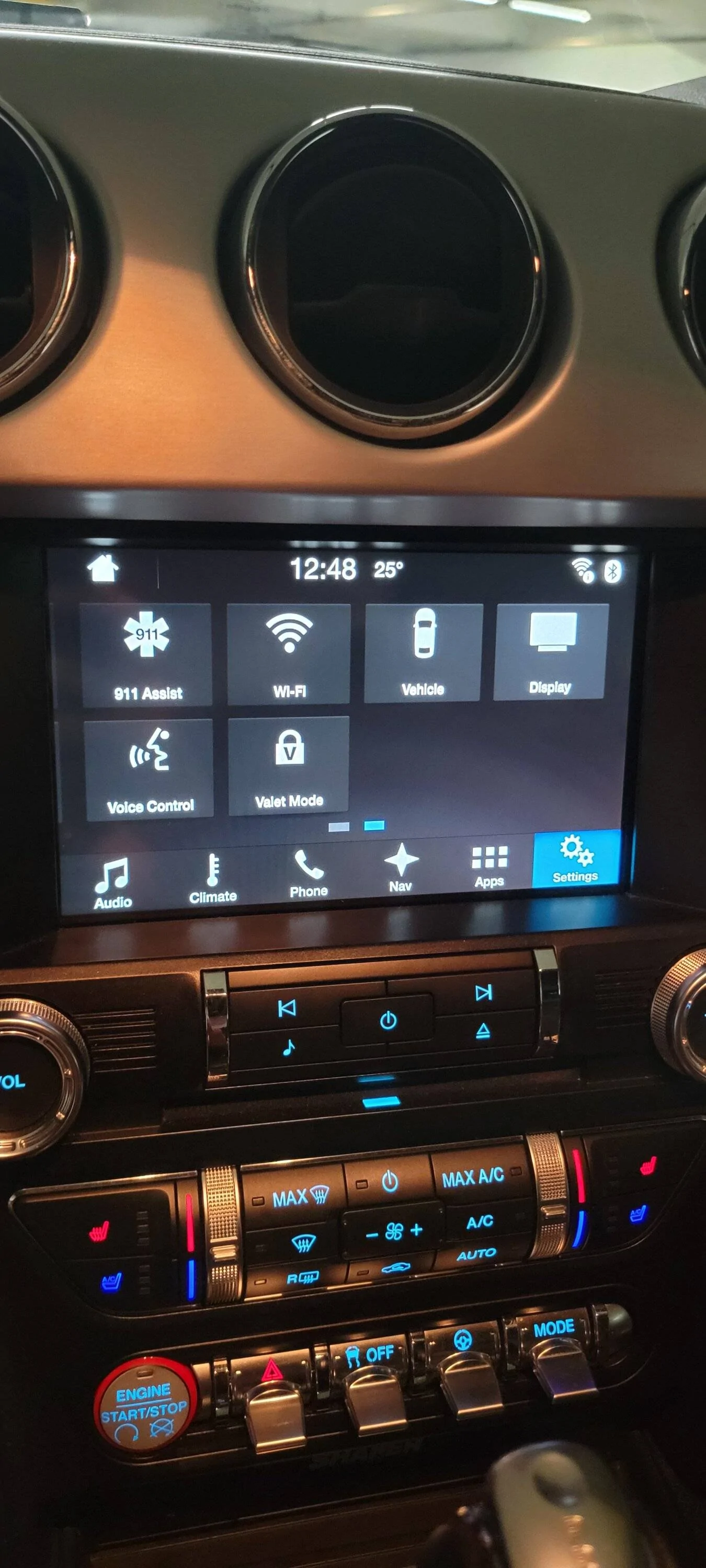

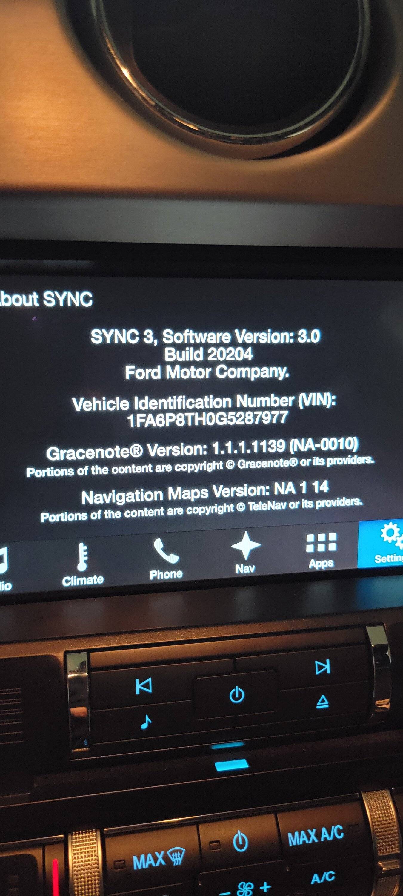

2016 Ford Mustang Ecoboost
Here's y Sync 3 version info and what I see on the settings tab.
OK, you have the latest version of Sync which supports Android Auto. Your phone connects to AA in other cars. Have you tried different cables. I now this can be an issue with Apple. If you have than maybe, just maybe the new hub is defective. Honestly at this point you may need to bring it to a dealer.
