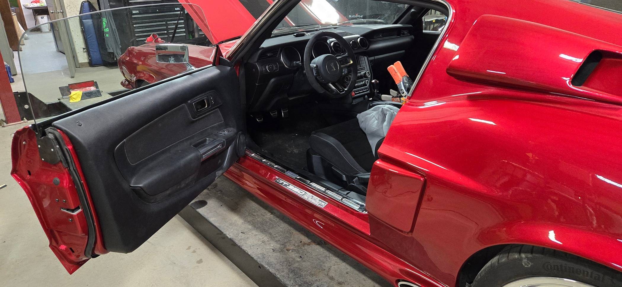

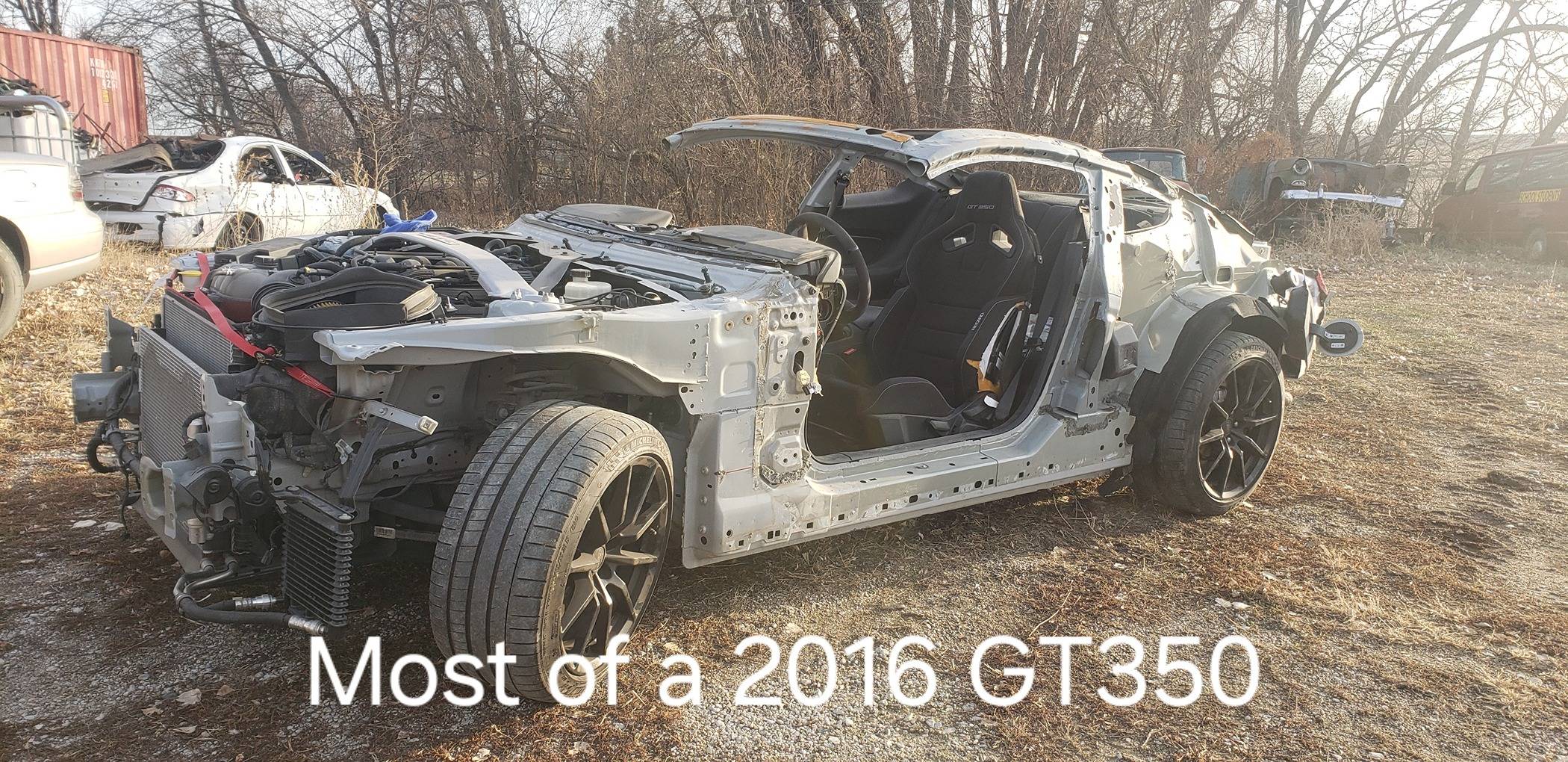

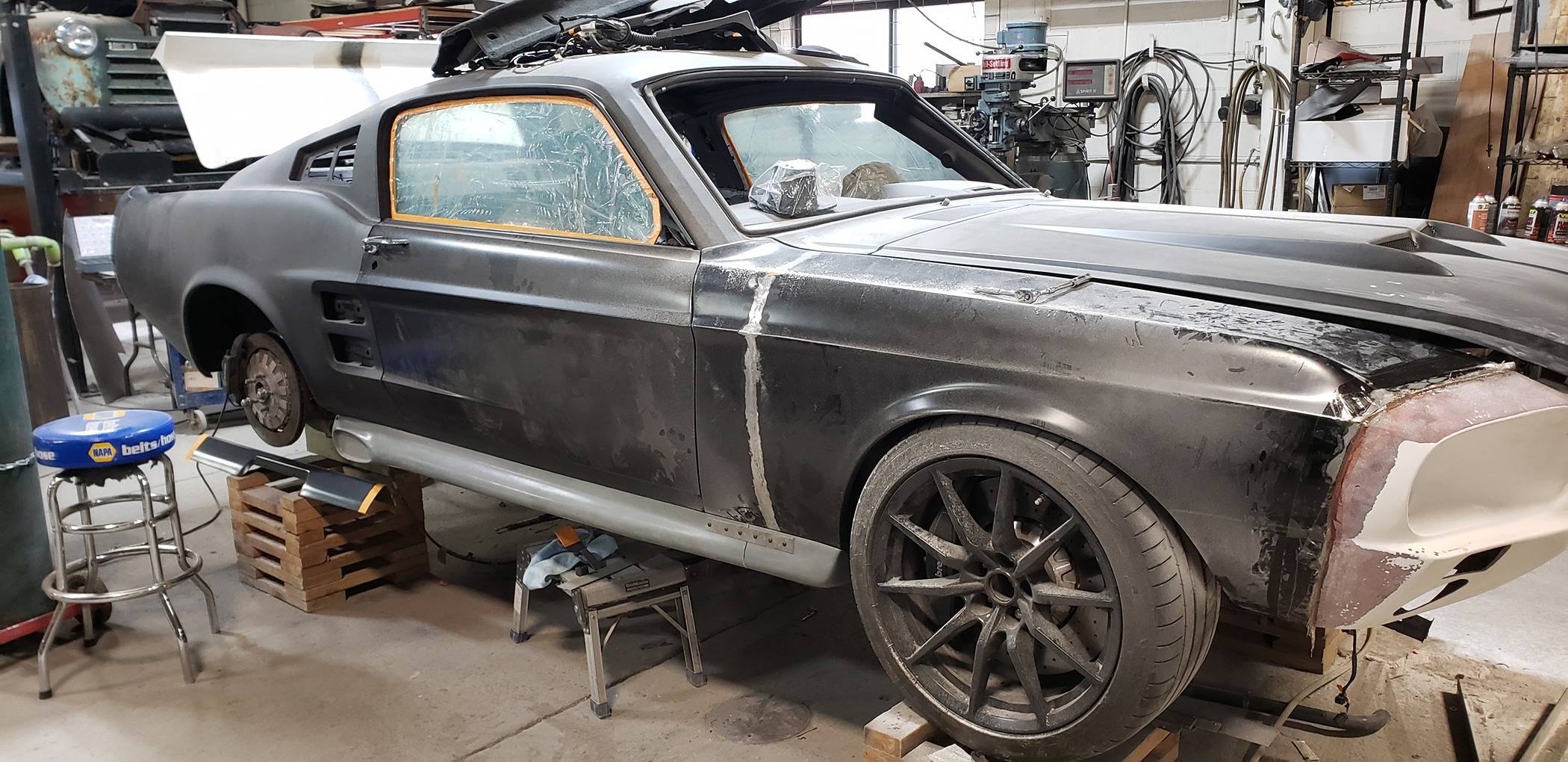

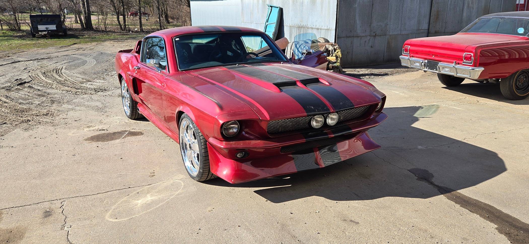

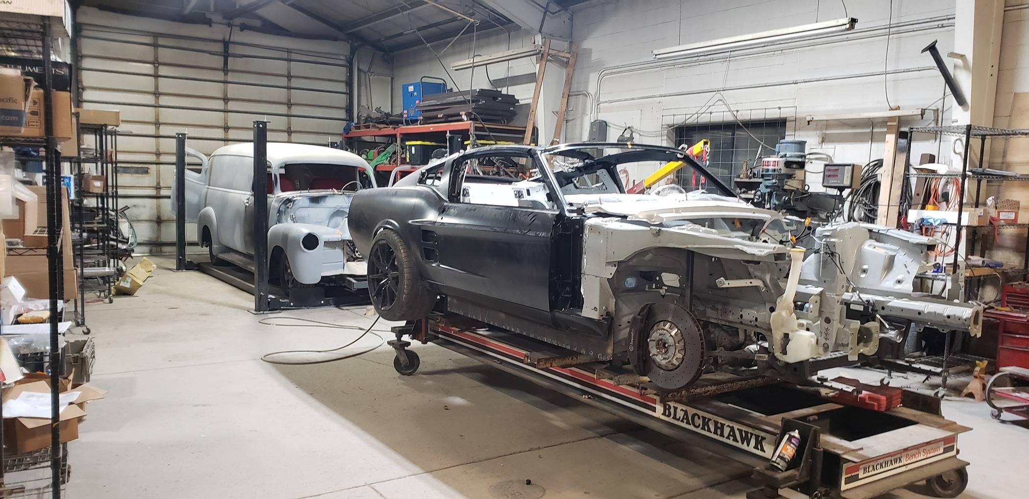

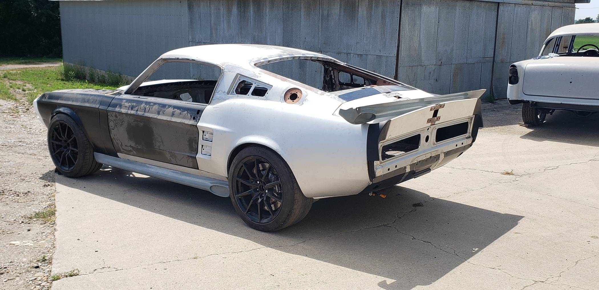

3 year customer build. Brought us a slightly wrecked 16 gt350. He wanted a 67 with the 16 powertrain and interior. Swapping that into an older chassis was not practical so we put the 67 body on the 16 chassis. Widened the body 4 inches and took 2 inches out of the front fenders so the wheelbase lines up with the fenders. Finished pulling the body off and cut the sides down to the pinch weld then built it back up with new panels. The only features from the 2016 that don't work now are the power mirrors and rear defroster.
