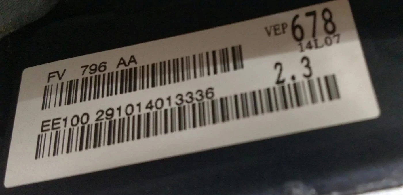

Production was moved to Cleveland in March of 2015 but there are some post March 2015 EB's with Spanish engines. You can look at the sticker on the front of the engine slightly below the cover to identify the build location. Here is a Spanish build.

FWIW, my car has a build date in early May 2015, and my engine was built March 27th in Cleveland.

Saying that all Spanish engines are more prone to failure than all Cleveland engines is not an accurate statement. The engine failures were early 2014 builds (July-Sept?) and mostly all tuned so perhaps the tuners adjusted the tunes over time as well as manufacturing abnormalities regarding the rod bolt torque were corrected. There are many more tuned 2015 running just fine than blown engines and the frequency of engine failure has diminished over time. To my knowledge the 678, 677, 676. and 675 Spanish engines have held up better than the previous engine numbers and are the fastest EB's setting records at the track. Also, some tuners have never had a blown engine. There are too many variables that are unknown and may have changed at some point to say that Cleveland engines are superior to all Spanish engines.
