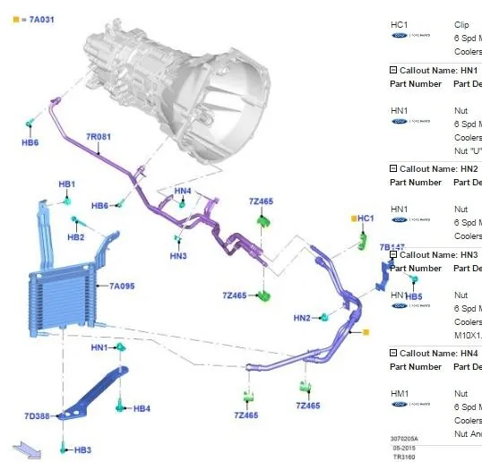

We are talking about the transmission. Not the rear axle on the Shelby.
I don't understand where you are getting all your numbers from. Sorry slight communication break down.
I just did a cost breakdown of the Transmission Parts (ALL FORD) with my rough costs (Not What I would sell them for but anyone could probably find a dealer to do this.
Retail: $848 My Cost would be $636-593
Transmission Retail $4141.20 My Cost would be $3105-2898 (Before Core)
My Point being is even at my Cost Ford coud offer a complete solution for $3500 all day long if they wanted to. Now if it is possible to retrofit the pump in the transmission and those parts where available for under $100 a kit could potentially run only $700 before labor and you would have the Track Pack set up.
