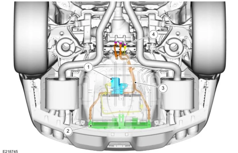

Dave,
If you follow the yellow harness from the pump module it gives you an idea where the factory harness comes out of the car. The temp sensor honestly no idea, I assume directly above the cradle. Here's to hoping the harness is already there :cool:

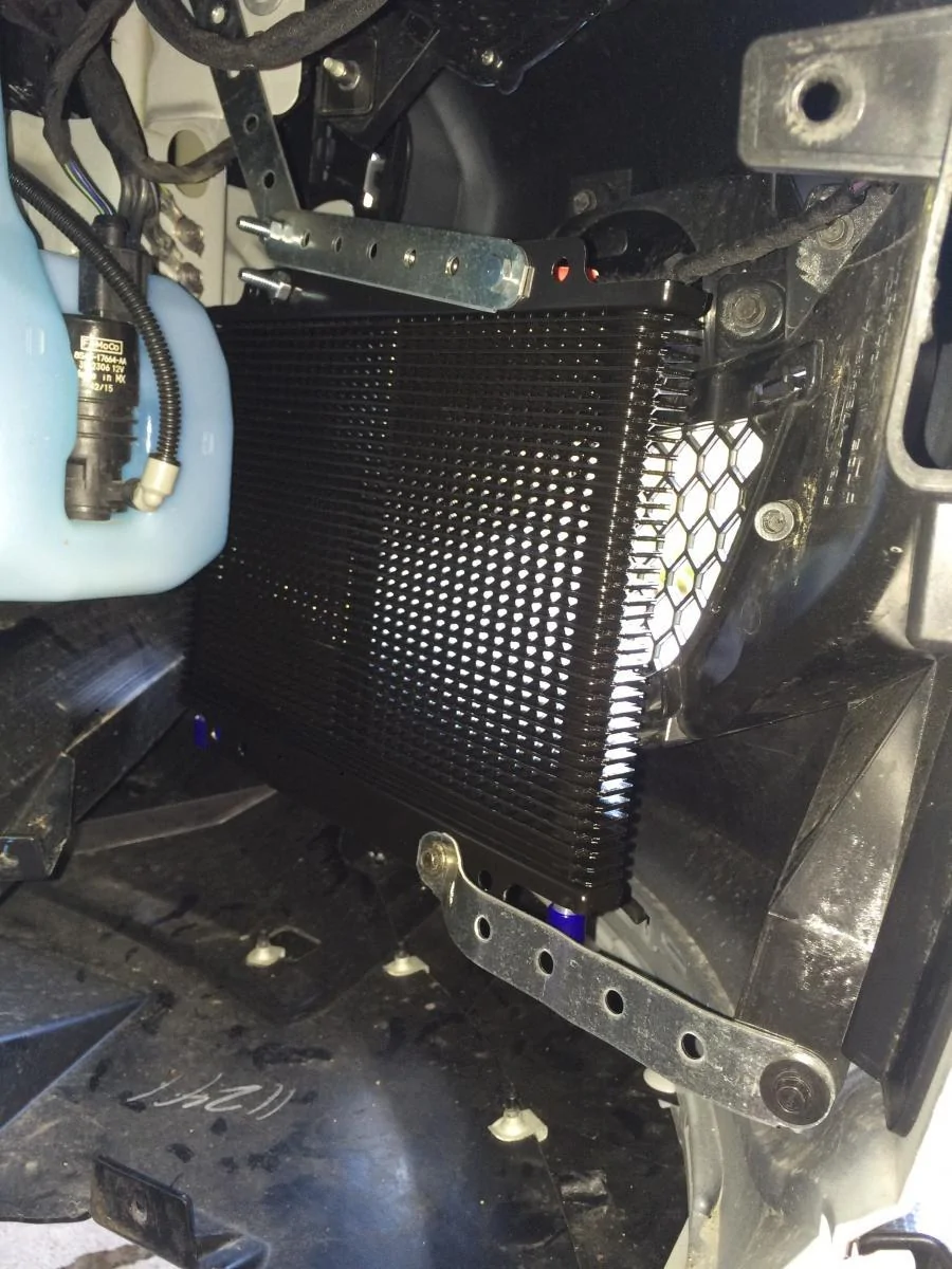

Started a little mock up today. Thought I had tons of room but it gets tight quick under there. I used th brackets that the cooler came with and some bolts to get a position. I'm going o pick up some aluminum stock tomorrow to make my own.
