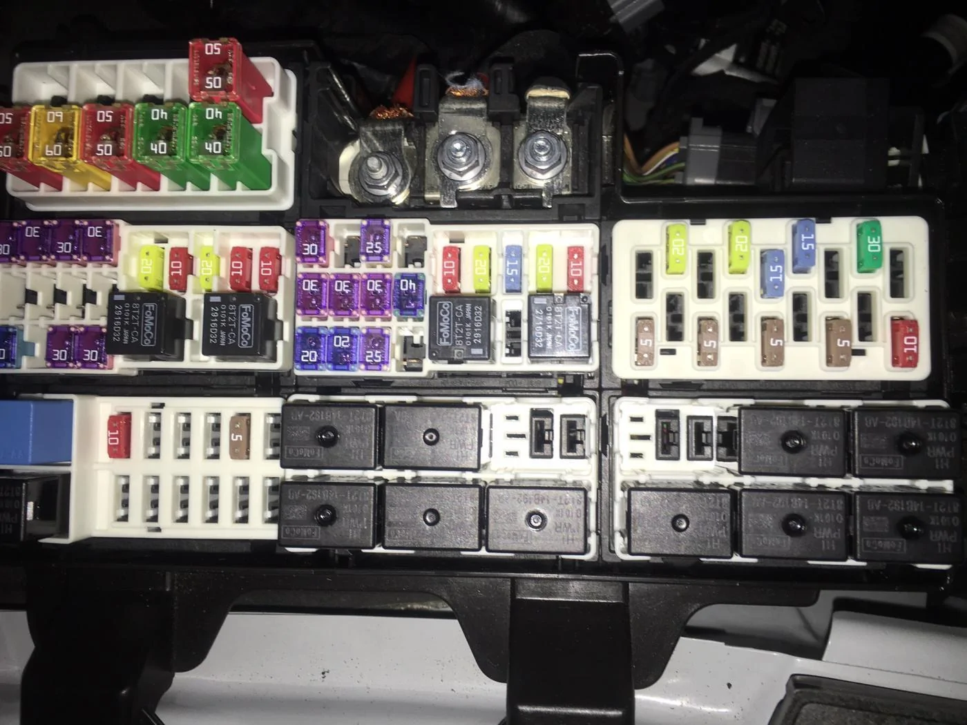

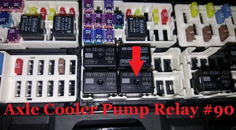

From what I've read, it is about $1200 worth of parts to add the factory diff cooler. Problem is wiring it into the system as there is no harness in the tech cars. I haven't looked at mine but I suspect this is true.
This relay is on Track Pack / R Models. This is the box on the RH inner Fender. Open and see if that spot has terminals in the holes. You should not have a relay inplace on a Tech Car but Ford may have run the wires to it. The spot to the right of this relay should be one for radiator fans. You can see the terminals in the picture. If it is not wired it will just be empty white /black plastic sockets.
PLEASE Let me know.
