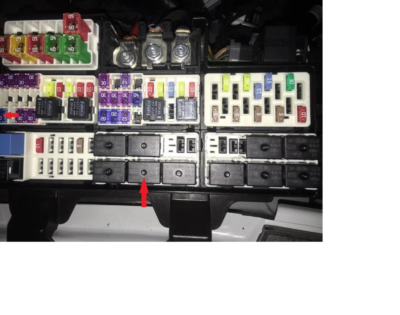

This fuse panel is from a Shelby without factory coolers correct?
The left arrow is pointing to the 20AMP fuse present that powers the rear diff pump and the bottom arrow is pointing at the Relay that drives the pump....that is not on a Tech Car.
I am very Curious if they are using the same parts for both cars and the harnesses are already in the car. With the limited numbers it may have been cheaper and simpler to make one Shelby Dist. Box instead of two.

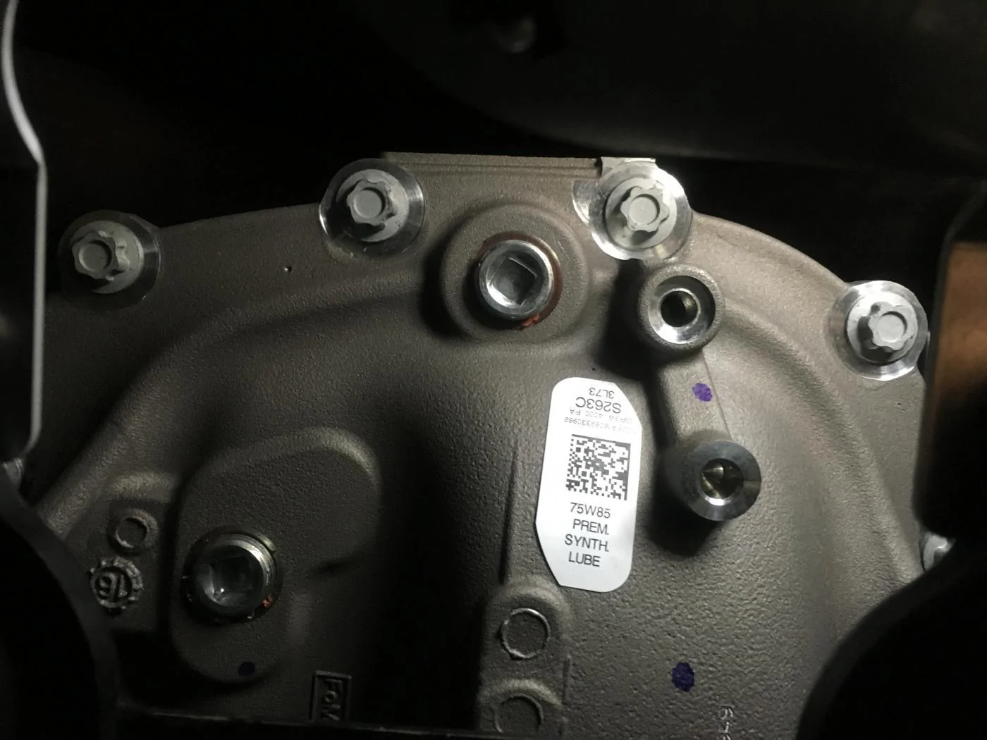

I believe all 3.73 equipped Mustangs 2016+ have a rear differnential sensor. GT's will give a center stack warning to slow down for over temp. All Shelby's have a transmission and rear axle virtual gauge unless my information is incorrect.
Your information is not correct. The Tech Pack cars do not have a differential sensor. The port for the sensor is on the bottom left side of the rear case for the differential, and it is an empty threaded hole. I have installed my differential gauge sensor in the factory location for the gauge I added to my car.

That is very interesting, so Ford monitors it in a regular S550 with 3.73's and not the Shelby, yet they monitor transmission temp. So if the transmission causes limp mode the rear axle will never get hot enough to worry about so no need to monitor it. I am now more curious if the parameters are set so Limp Mode is easily reached in the Tech Package.
So do Tech Pack cars have the virtual gauges? or is that only on Track Pack / R's?

The Tech Pack cars have the ability to turn on the virtual gauges, that has been covered in the other thread. But the diff gauge will come up blank because there is no sensor or circuit. The Transmission gauge works great once you turn it on. By all reports, limp mode is activated at about 280 degrees on the transmission.

Yes, It appears only one dist box was used.
I hope this pic helps even though it is upside down.
