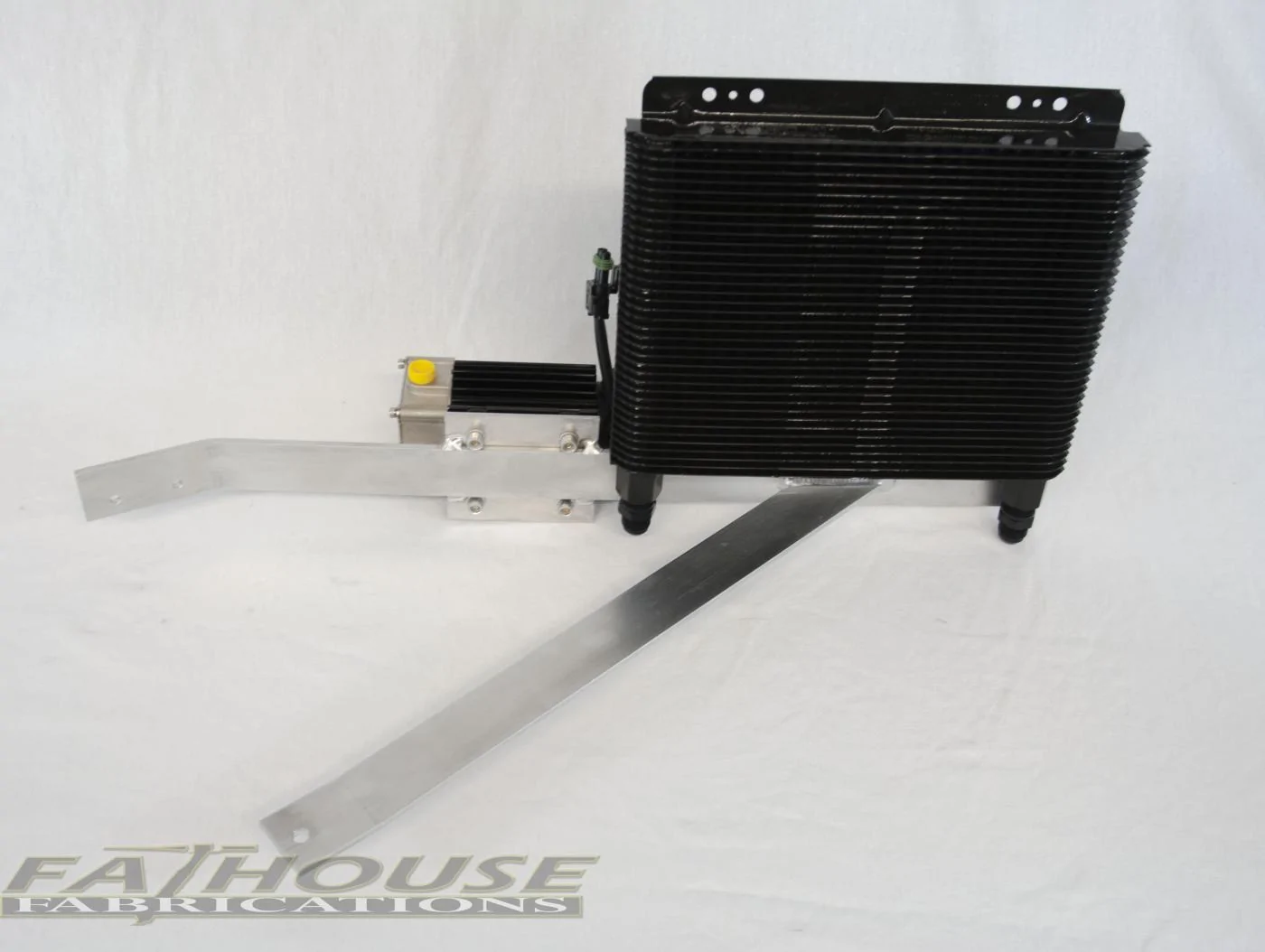

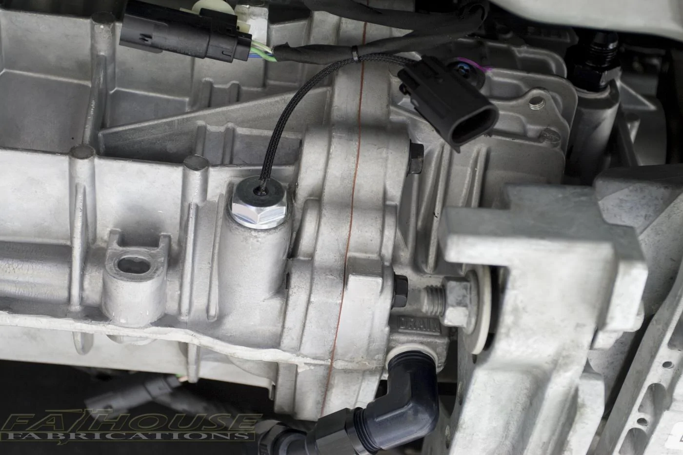

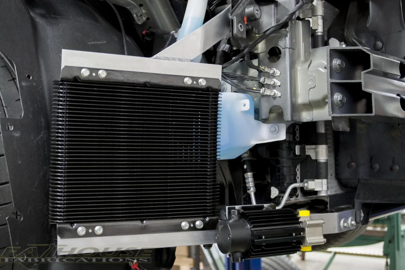

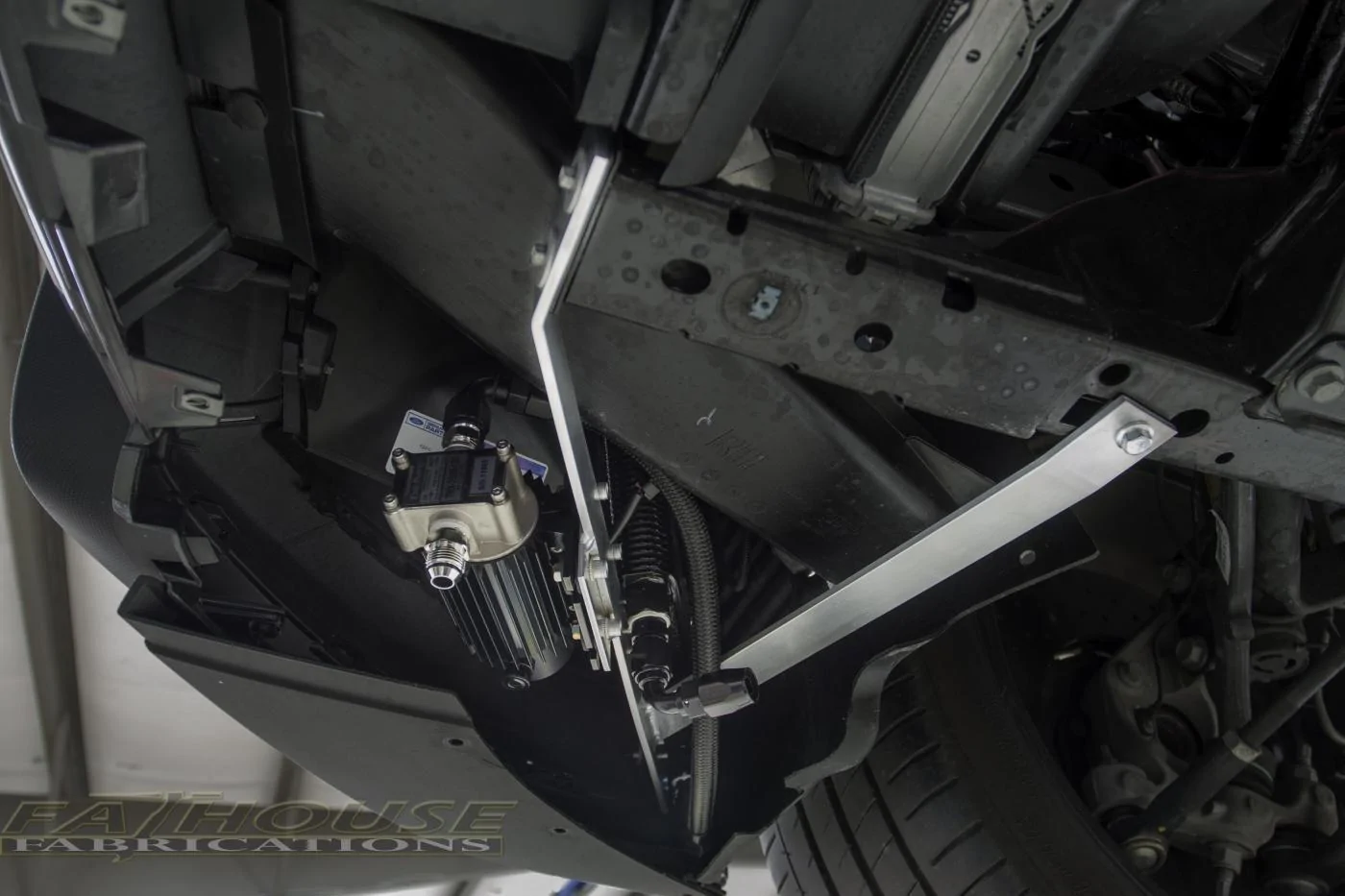

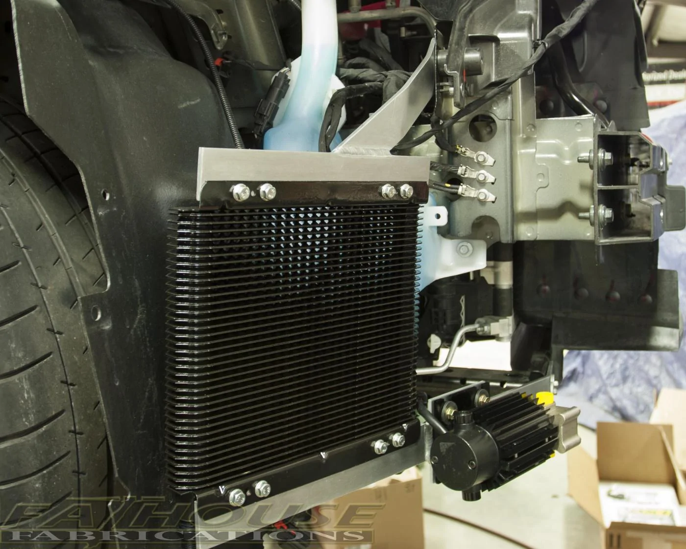

Problem solved!

Those look like aluminum brackets. Mind if I ask what alloy you used? Any concern about the welds or brackets failing due to flexing/vibration over time? Aluminum doesn't have a distinct fatigue limit.
https://en.wikipedia.org/wiki/Fatigue_limit
Not sure what they are made of...my shop did it..they have much experience in the racing industry..

Problem solved!
I do like this set up. Why Ford can't do it is beyond me.
So it the pump "always on" or is there a power switch installed somewhere on the dash?
Can you hear the pump? If so how noticeable at idle and daily driving?
Fatigue shouldn't be a concern as the brackets are affixed to the body in a localized area and look to be bent where they need to be, sufficiently welded and triangulated. In other words, a well thought out foundation from which to anchor the cooler to.
