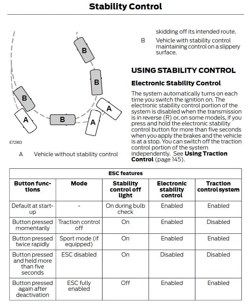

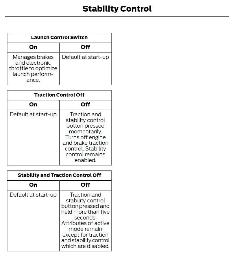

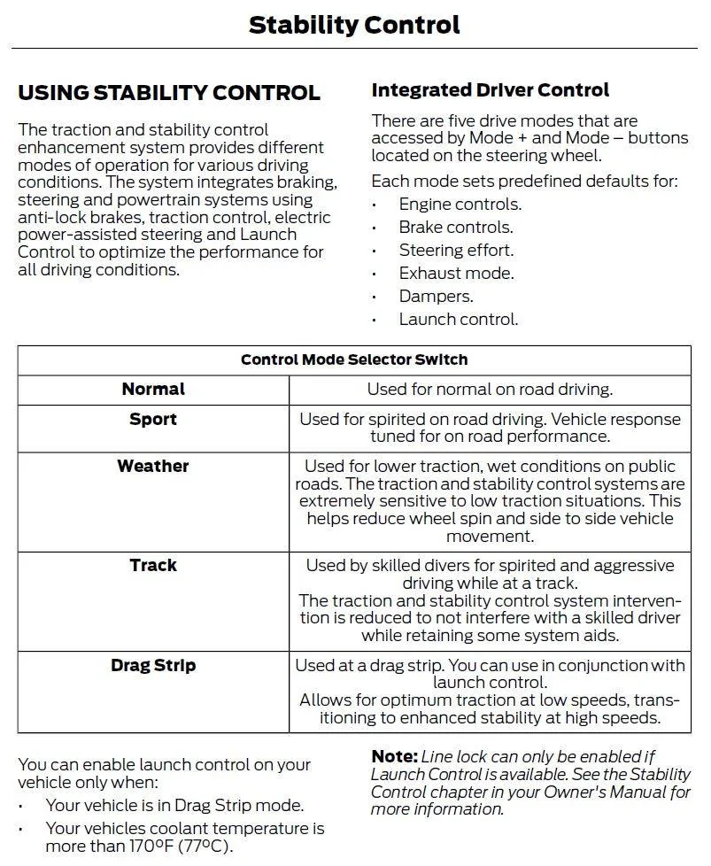

To be 100% positive of what you have, you'd likely need the original window sticker. These are not easy to come by, for a second owner. However, I bought a full service manual for my 2017 Mustang GT from https://www.factory-manuals.com/. I bought my stang brand new, but it's nice to have the window sticker information digital, and their service manual also provides the window sticker. Here is some content from the owners manual:

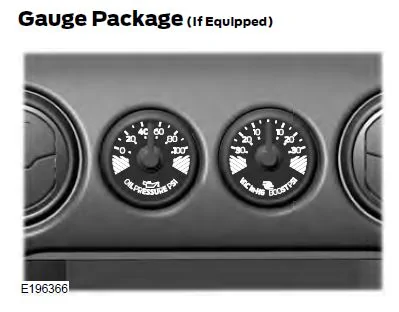

While these gauges can be added, they come default with the performance pack.

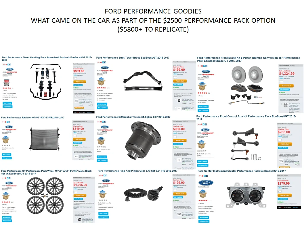

I remember saving this off the board years ago. Hope it helps.

4 parts missing, Performance Pack chin spoiler, performance pack belly pan, and both front wheel well liners.
Yes. Apparently whoever made this graphic just included the FP parts included, and not the full laundry list.
(Note the PP option price, how things have changed)....
