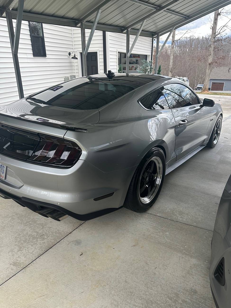

I ran 275 35 20 and 305 30 20 on mine when I had 10 and 11 wide wheels. Came as a combo from LMR and it fit real nice and looked good...

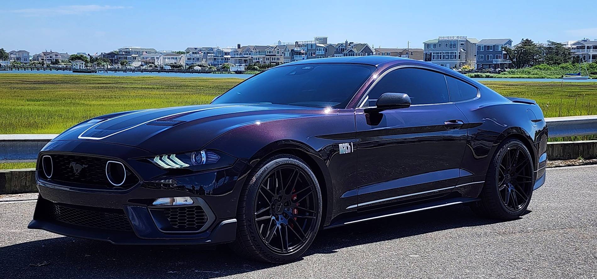

coyote550
Sep 16, 2024
119
104
NY/NJ
Alex
2016 Mustang GT Premium 6MT PP1; 2020 BMW X3 M40i

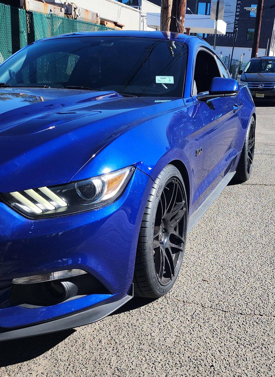

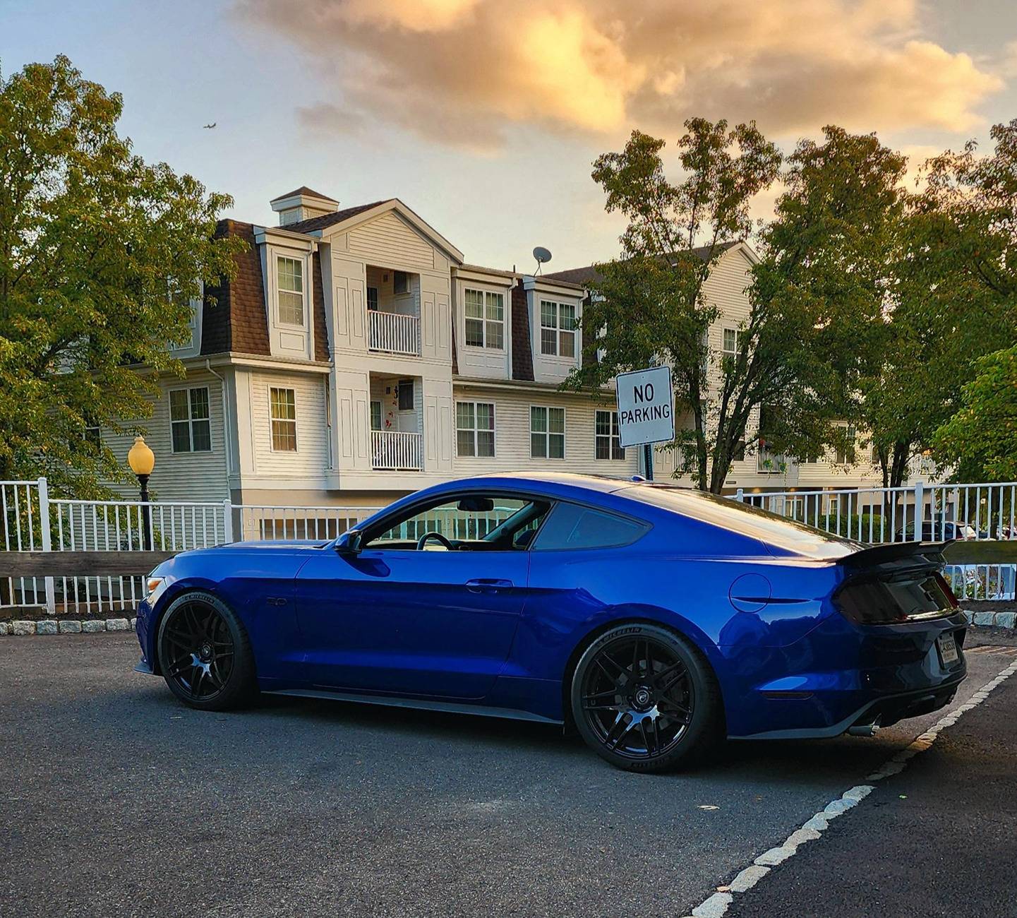

Forgestar F14's deep concave.
Front: 20x9.5 +29 - 265/35/R20
Rear: 20x11 +56 - 315/30/R20
The front wheels did tuck in a little more than I like but some 10mm spacers fixed that. I would like to go wider in the front but also want the sidewall and diameter nearly identical so that's the size I settled with. Only 0.4% difference in diameter and exact same sidewall.
