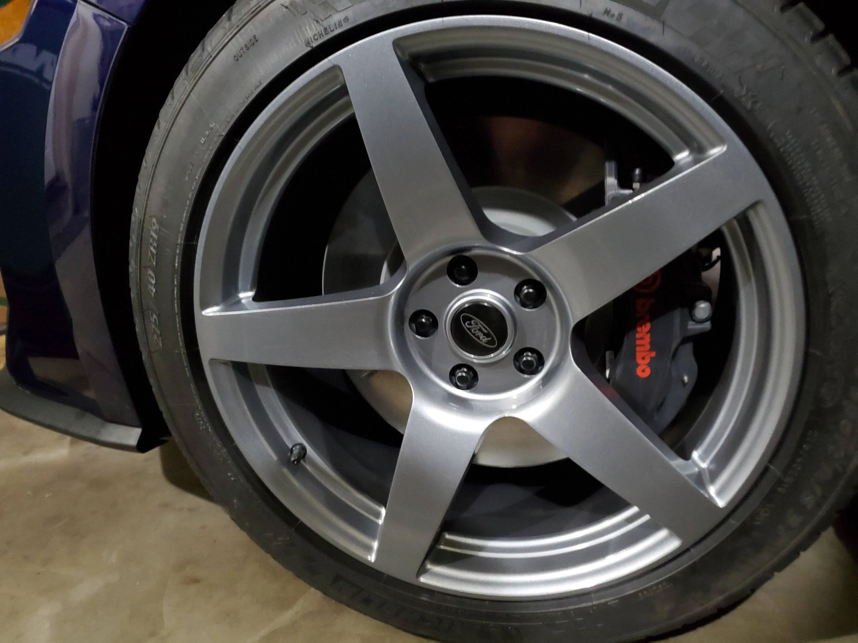

19x10 will fit just fine up front depending on the whee offset.

The SVE 19x10 wheels are a +35 offset, they’ll work just fine up front. I run their 20x10 +35 all the way around and have no issues.

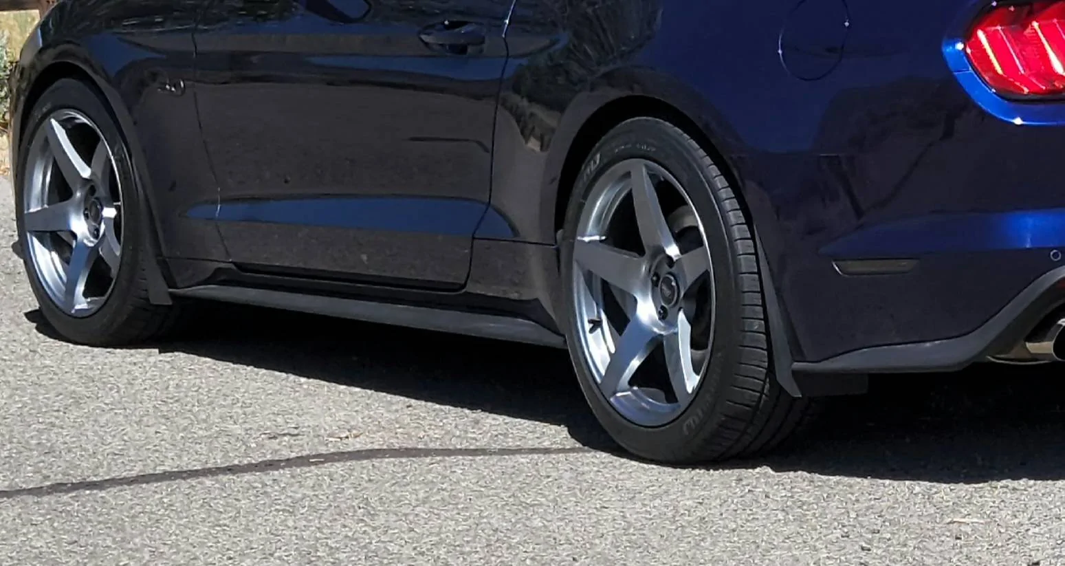

PP1 with SVE R355 19x10 +35 squared. 275/40 tires. Even if the 255 would stretch to fit the 10" wheel, you'd be sacrificing a lot of grip, front and rear.

Handling is excellent for my driving style. I like twisty mountain roads, but I don't race and I don't try to wear tires out prematurely. I went with the 40 sidewall for the little bit of extra comfort and the fact that they're closer to the stock diameter than the 35, so they fill the wheel well better and they don't throw off the speedometer & odometer.
