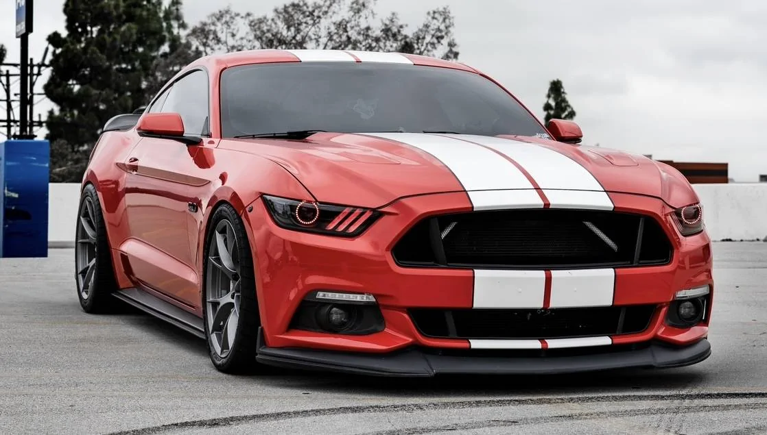

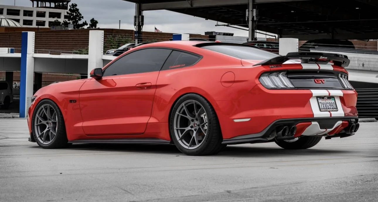

Hey this is Junior from Need4Speed Motorsports. This is my car on Project 6GR Wheels.
The specs on these wheels and offsets fit perfect. I went with a 19x10 +35 305/30/19 front, 19x11 +50 325/30/19 rear. The car is lowered about 2 inches. I do have a decent amount of camber up front to fit the 305's but no issues. Hope this helped.

Being able to put a tire on a wheel do not equate to fitting correctly
Your front tires are way to wide for 10” rim. Look how much they poke from the wheel
Look, maybe, handling, no way
