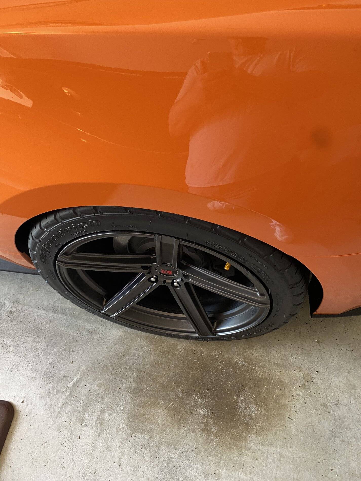

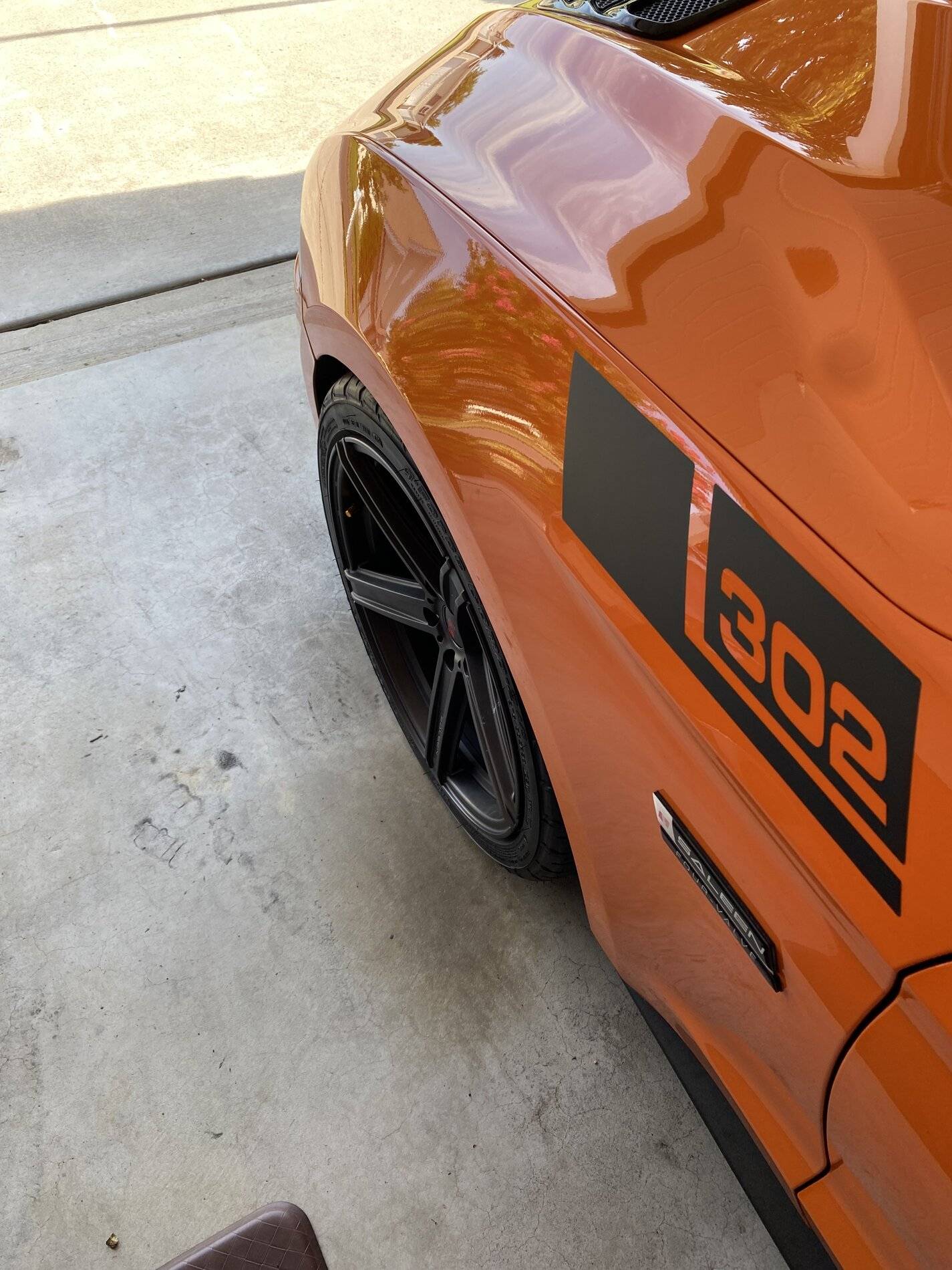

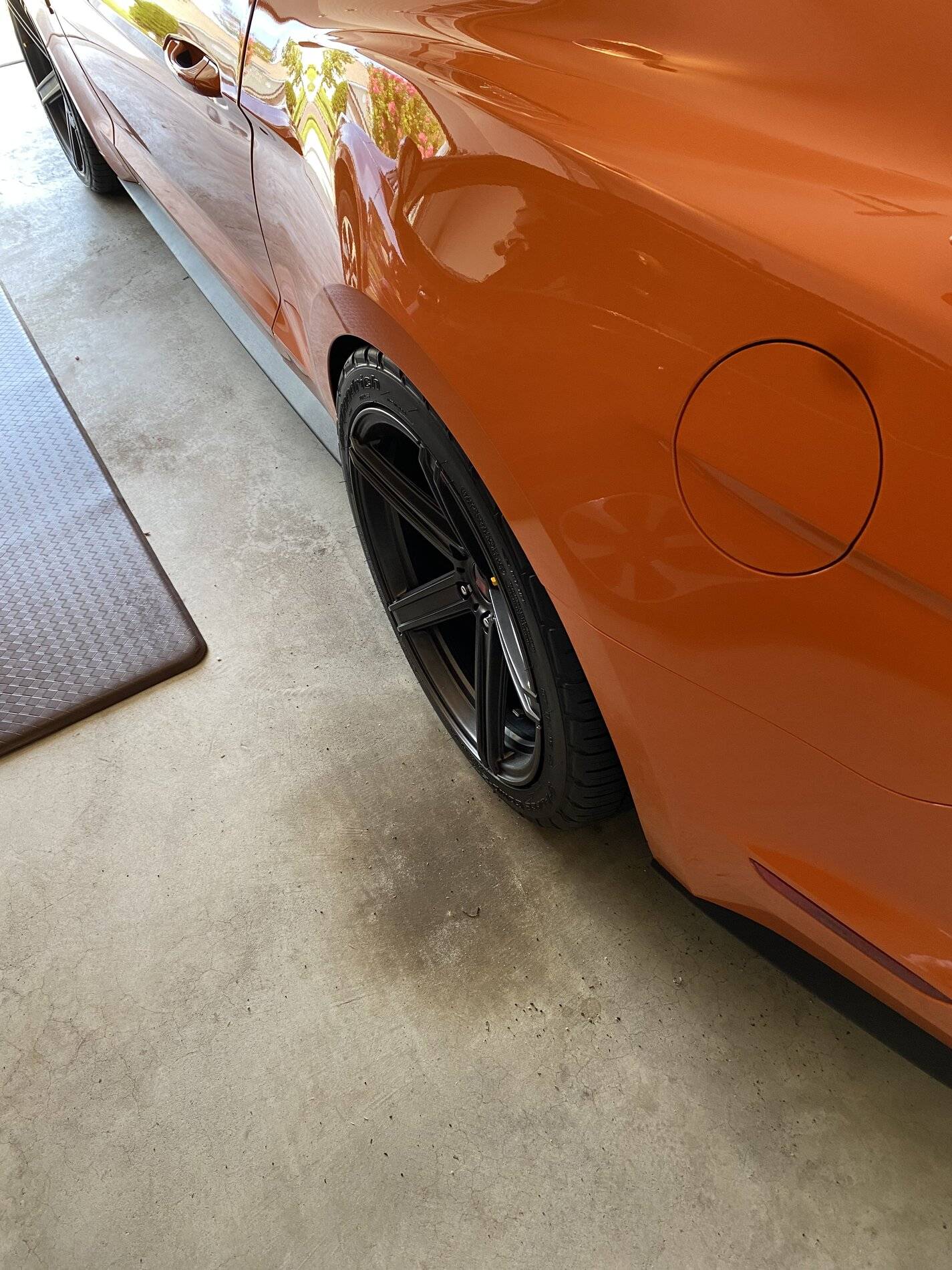

If you both of guys could share some photos of your wheel/tire set up
or send me a link on there to see them that would be great!
I like that beefy rear tire look, not 15" on slicks but a beefy street tire
emcmtony
Jun 2, 2021
211
261
08085
Tony
2020 Saleen Mustang S302 White Label
Looks great! Did you have to use wheel spacers?
Stock suspension?
Hows it drive?
The suspension is stock except for lowering springs. No spacers used.

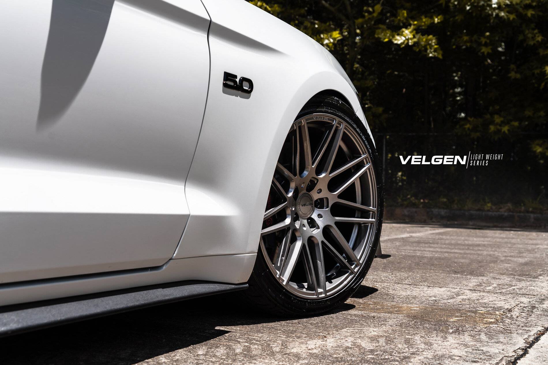

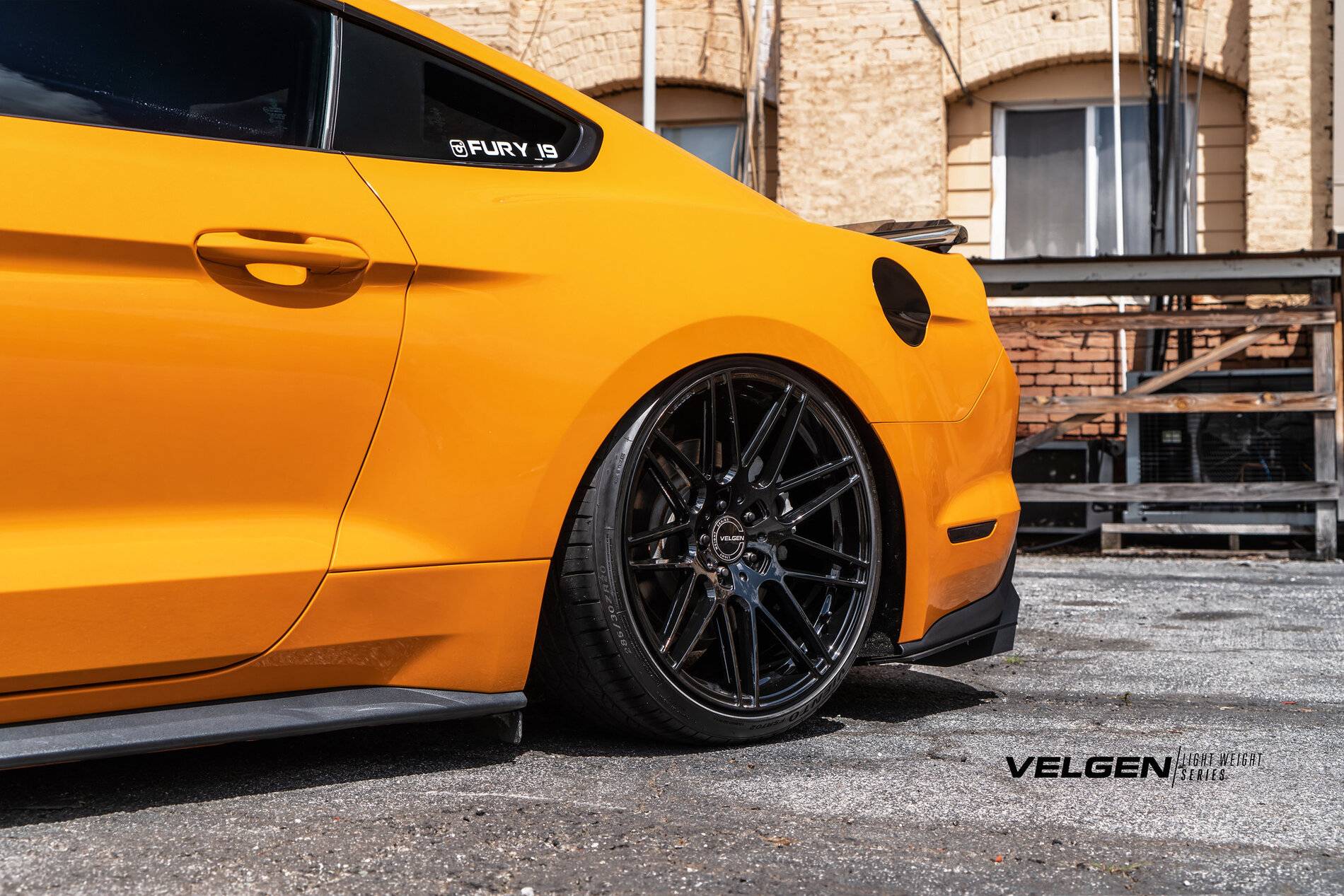

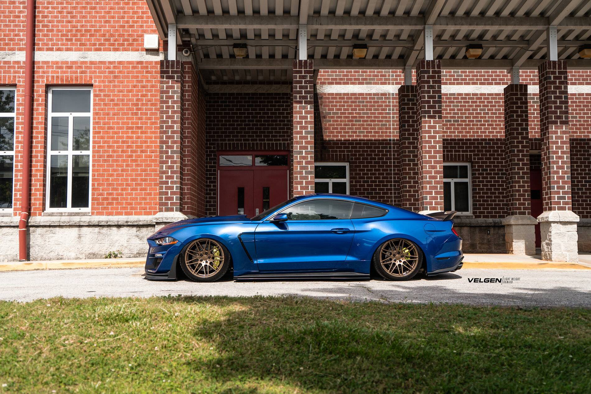

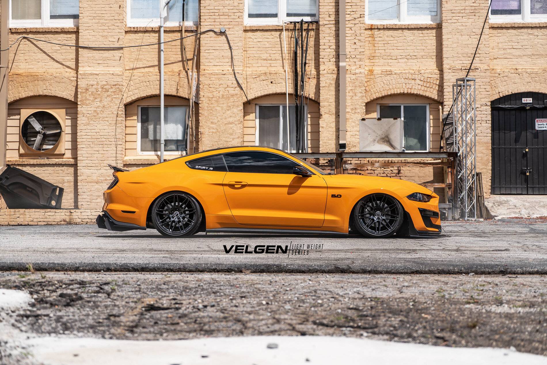

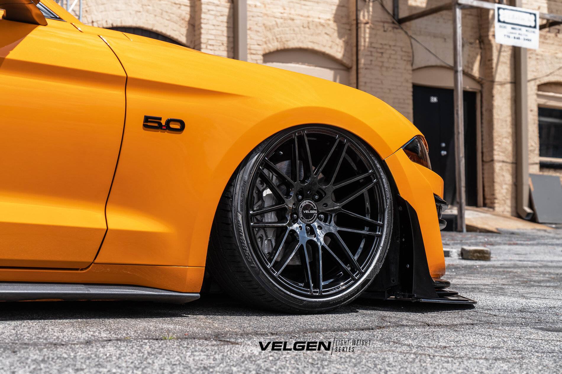

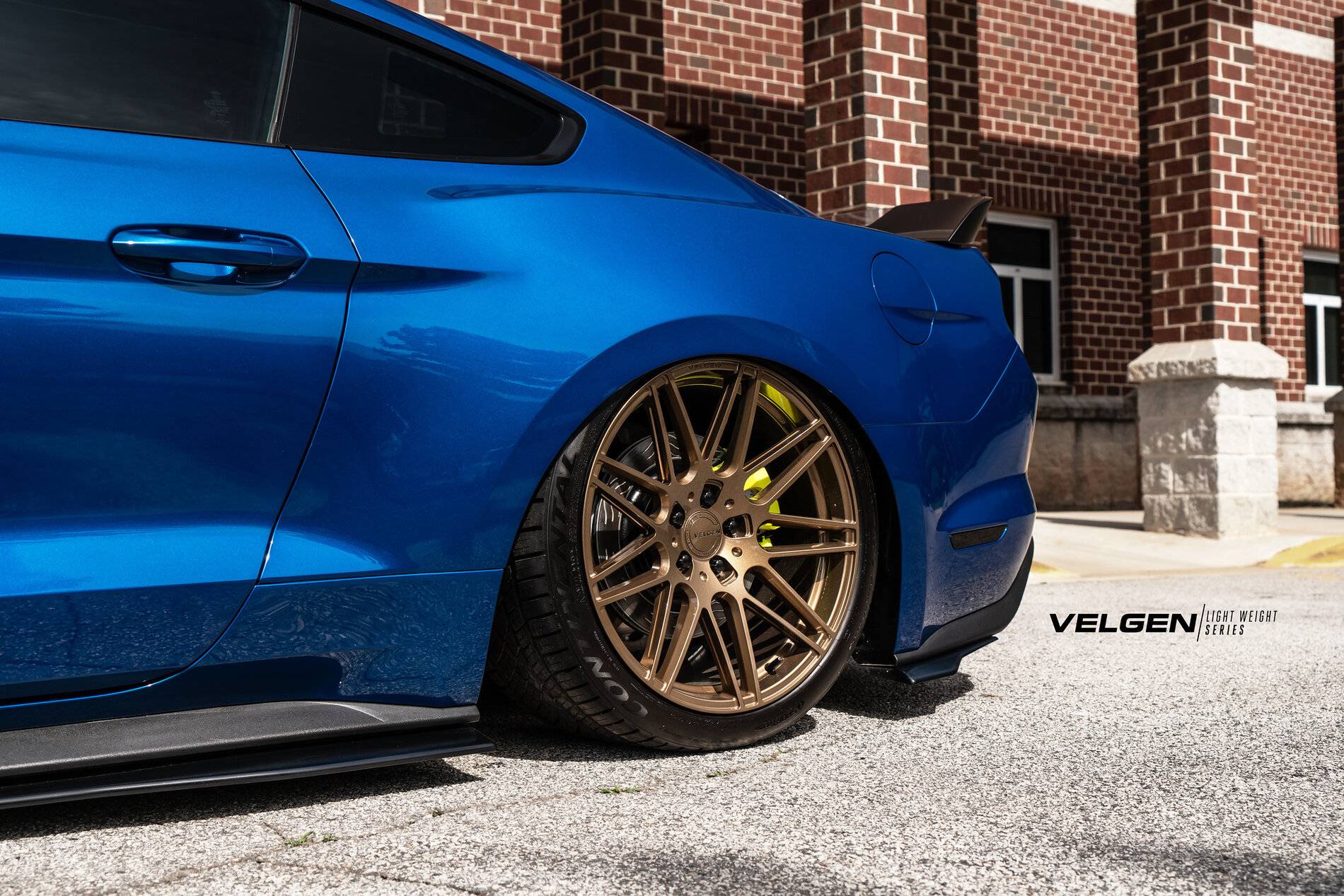

We have been doing mustangs for years!!
This is our new Velgen Light Weight series, VF9.
We have plenty of new styles in production.
