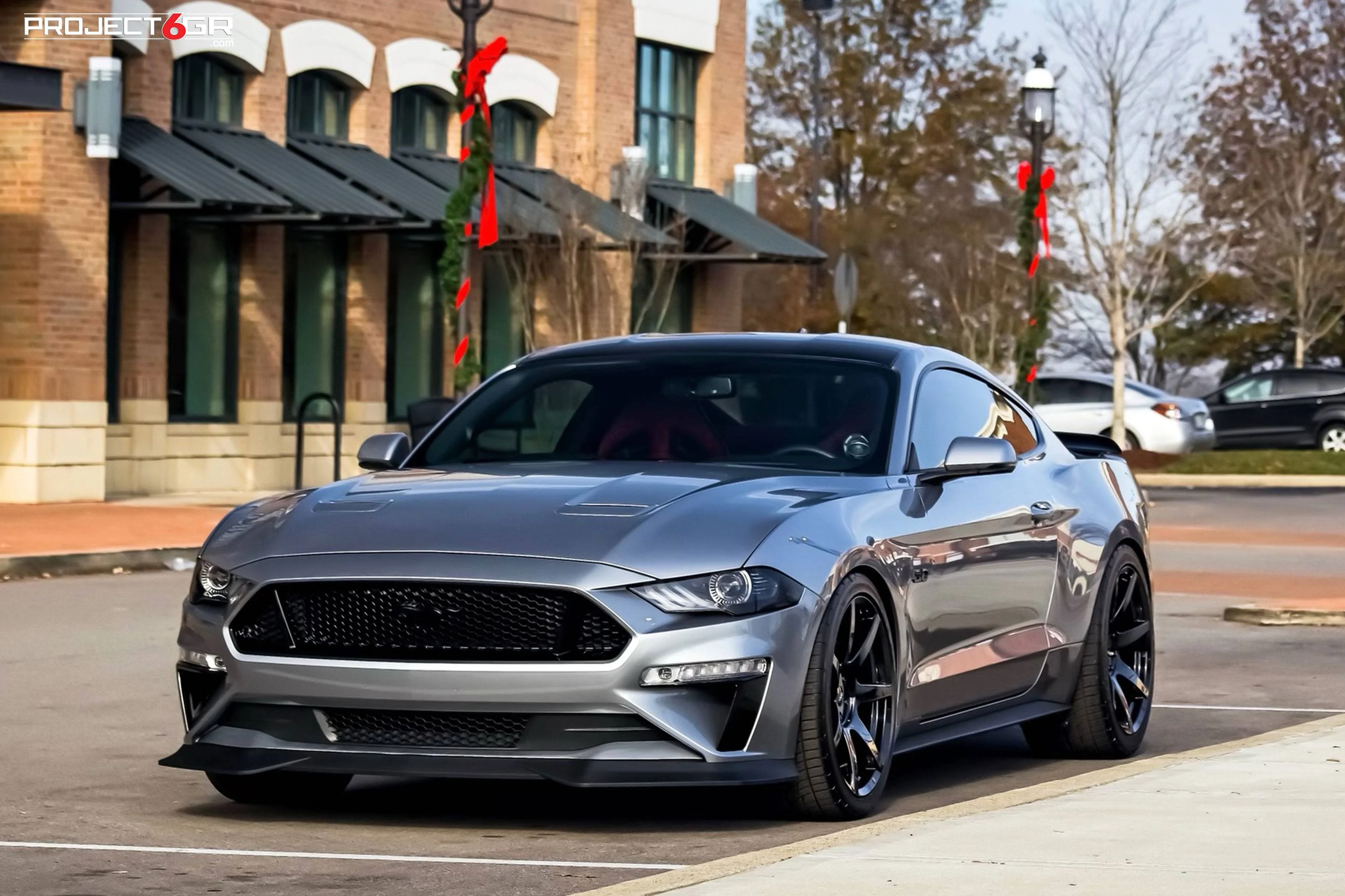

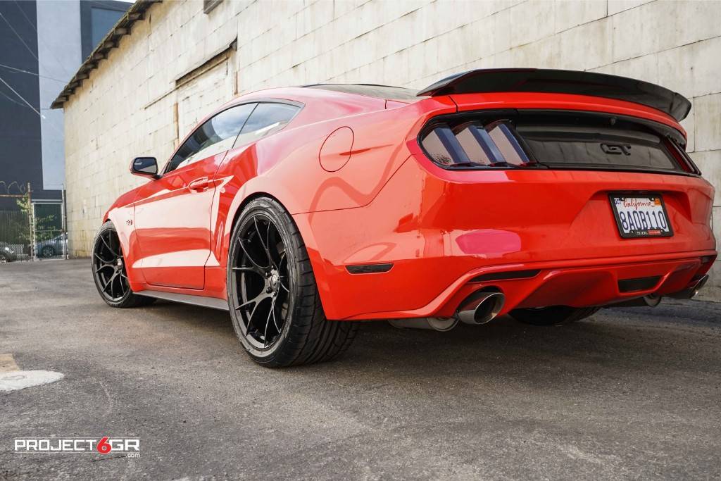

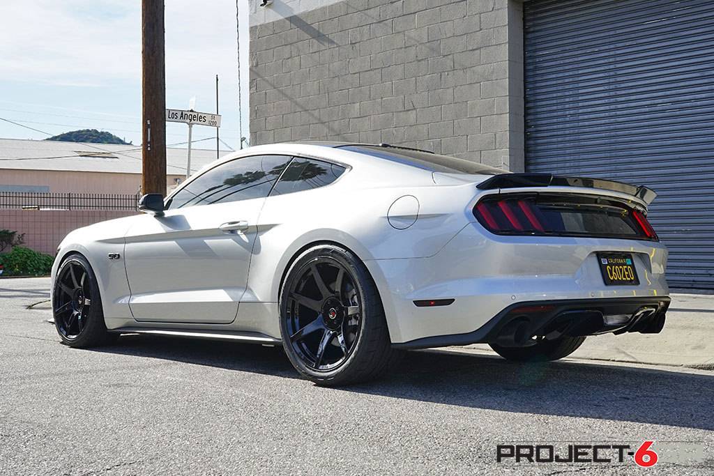

Hey matthew this is Junior from N4SM, so you want something that is good in the winter and summer and you don't want to lower your car. I would go with 20" wheels for sure they will fill in the gap better. As far as tires the michelins are a great pick or the Nitto NT555G2 tires are great also and are much cheaper. For width and sizing the perfect specs on these cars would be a 20x10 +35 offset with 285/35/20 tires front, 20x11 +50 offset 305/35/20 rear. Basic setup no rubbing and will handle great. Here are a couple examples of customer cars we have done on 20" 6GR wheels. If you have any questions feel free to give me a call and we can go over wheel spec and sizing.

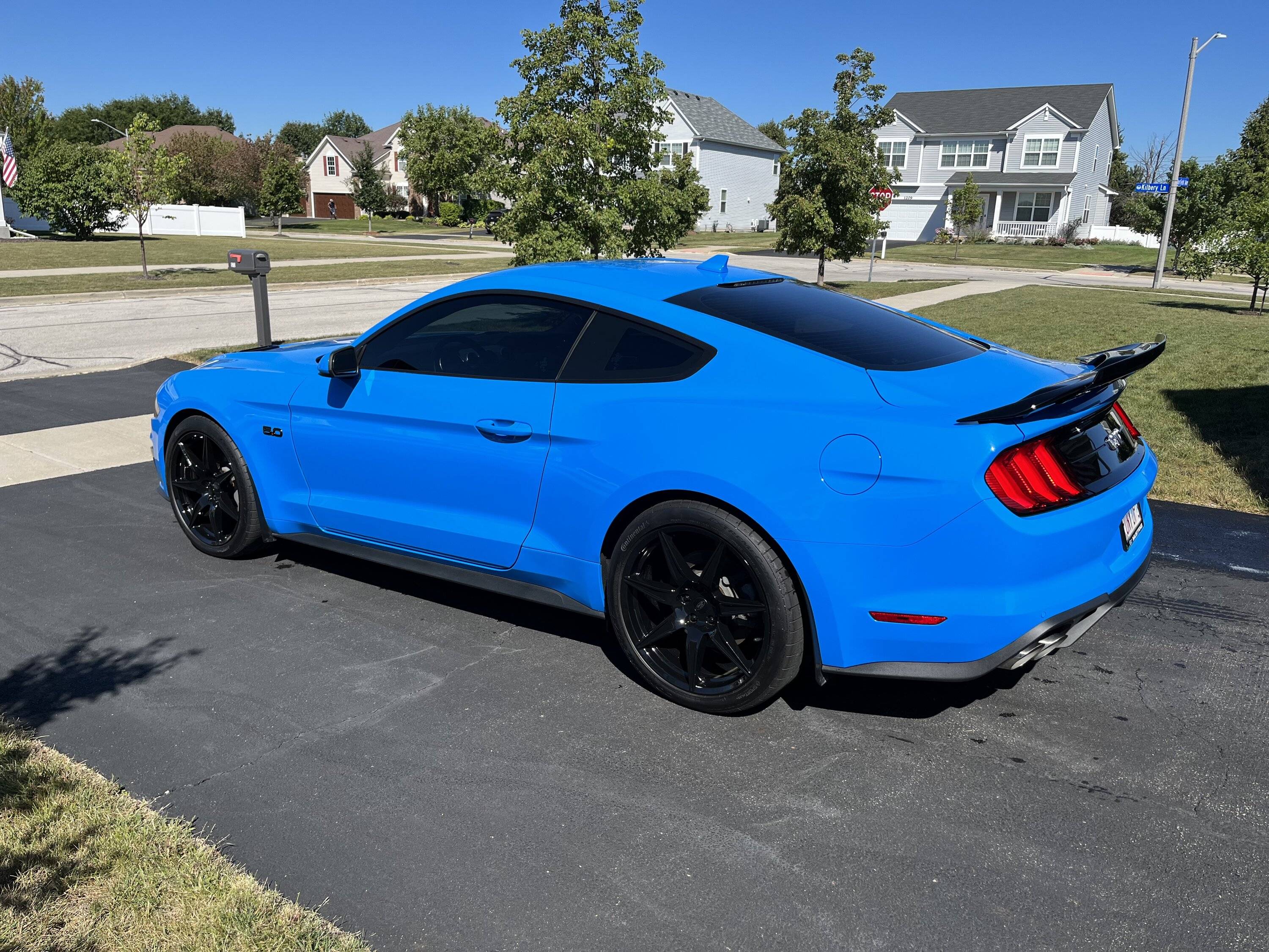

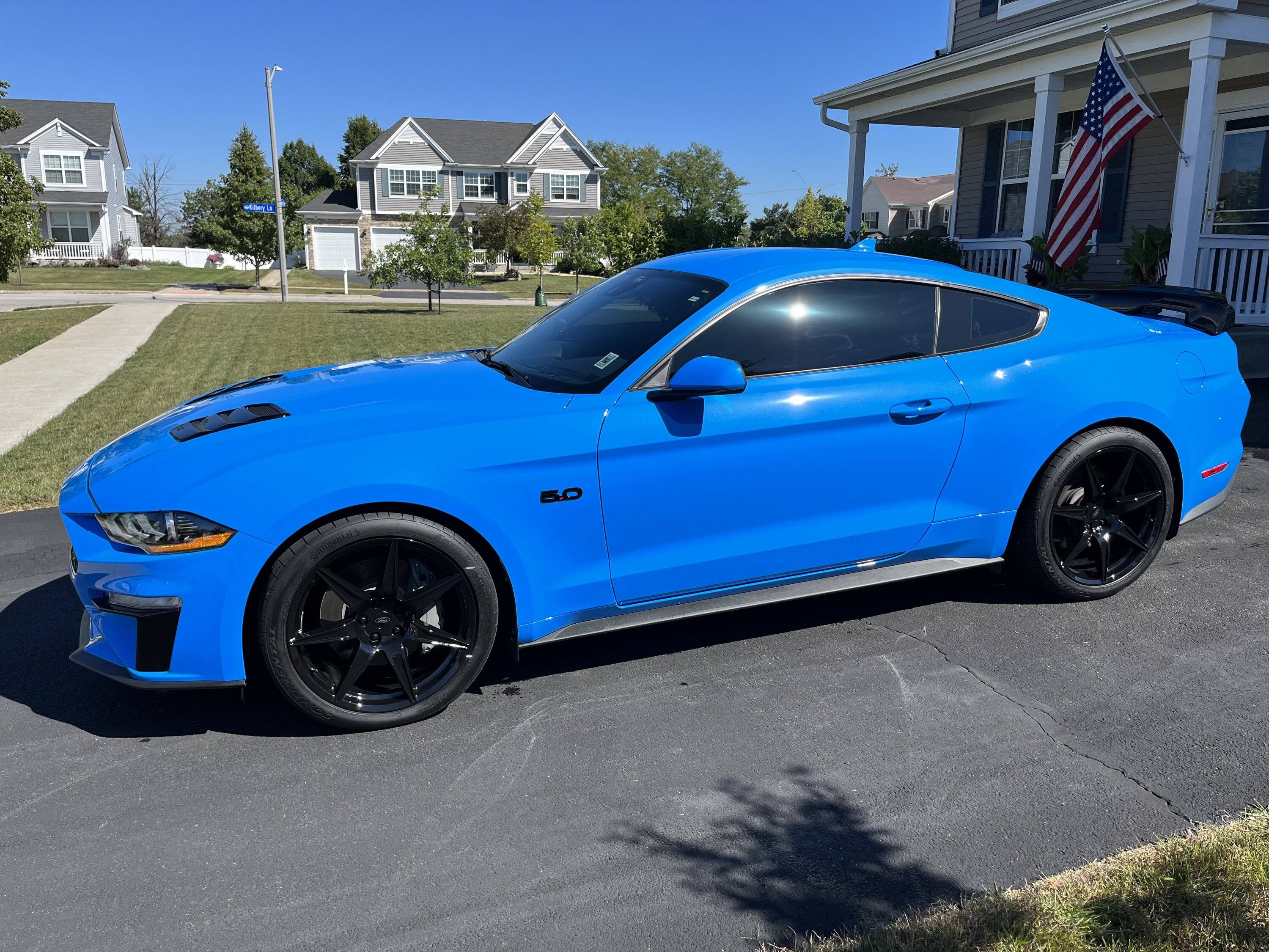

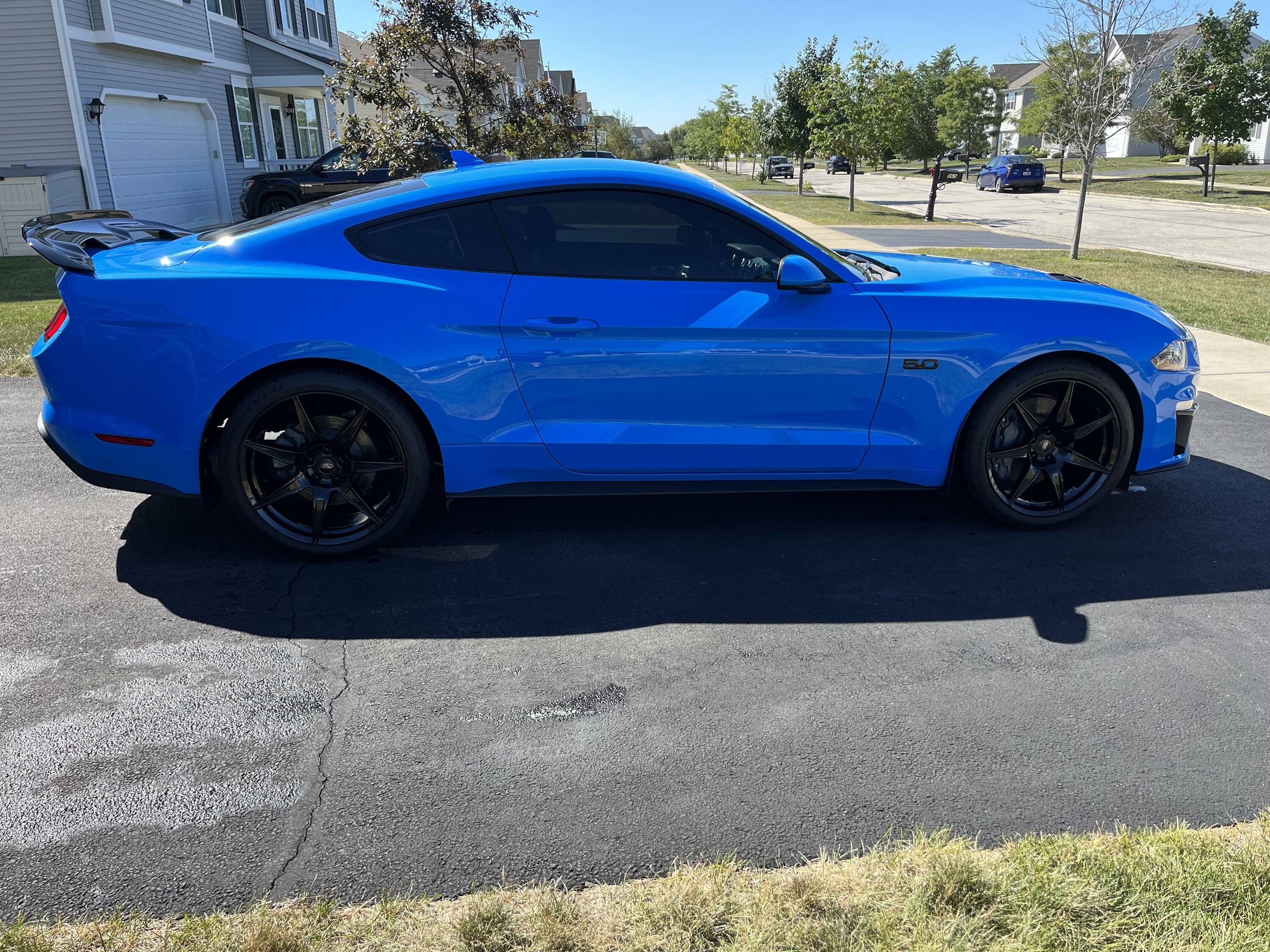

I have the SVE CFX in 20x10 +35 offset (they are the GT500 CFTP replicas). 285/35r20 square. Bought the wheels from LMR (the wheel kit) and got my Continental Extreme Contact Sports at Discount Tire. Used my wife’s SUV to haul the wheels over there. Discount Tire got rid of the empty boxes for me and swapped the TPMS from my stock wheels over (car was basically brand new, had 100 miles on it when I did it).
Project 6GR has some cool wheels too and @Need4SpeedMotors should be able to mount and balance whatever tire you want also
