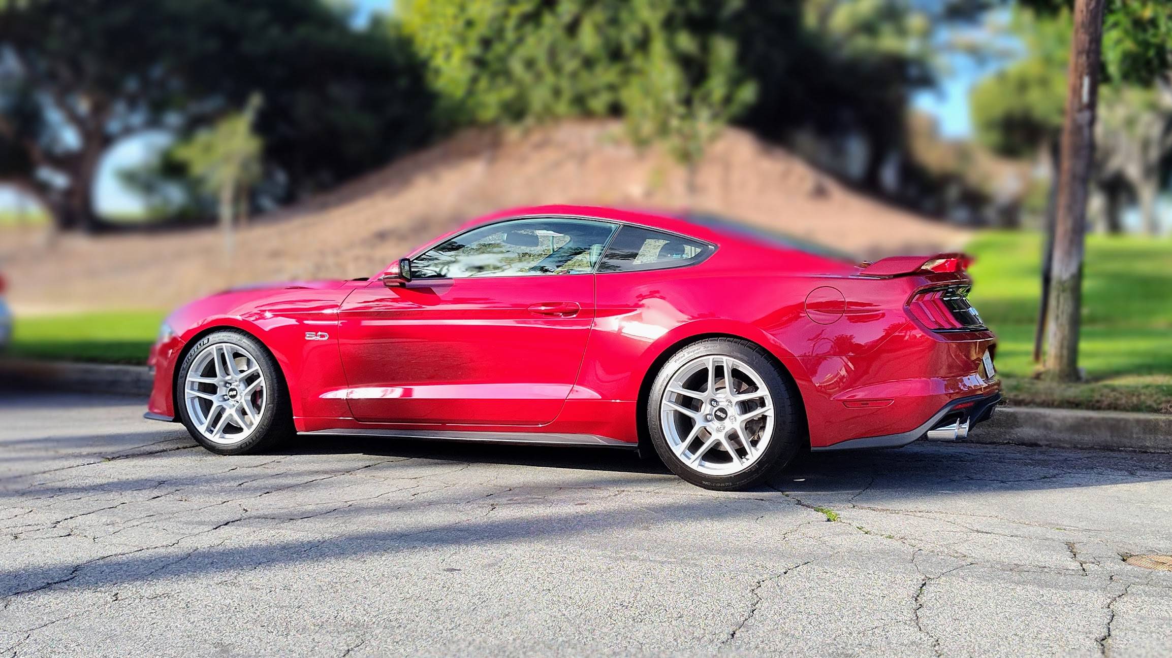

I got the MIch PS4S up front in 285/35/19 and the 305/35/19 with Mich PSS. To be frank the PSS has a better feel. Unfortunately they don't make the 285/35/19 Mich PSS without it being a RFT.
Here is a side shot so you can see the profile. The 285/35/19 and 305/35/19 keeps the OEM overall diameter to within a pretty close margin.
My car started out as a 300a PP1 car, fits no issues. mods in sig.

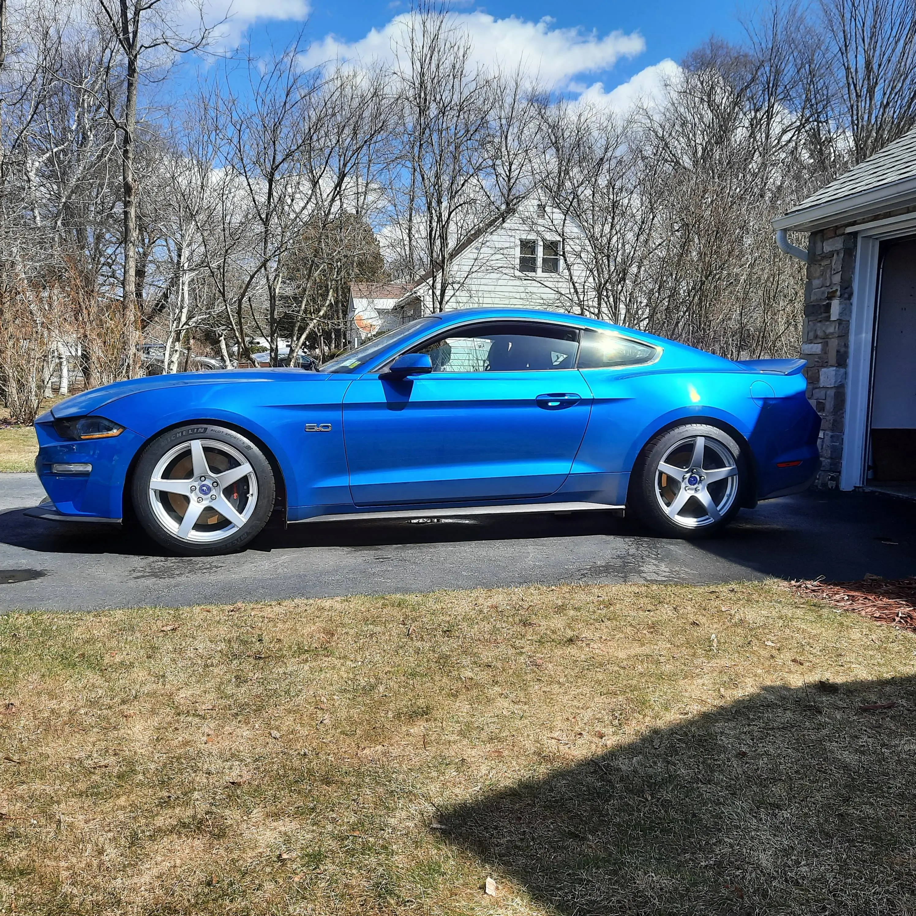

Full disclosure. I got the idea of PSS in 305/35-19 FROM Dave2013M3!
My car.

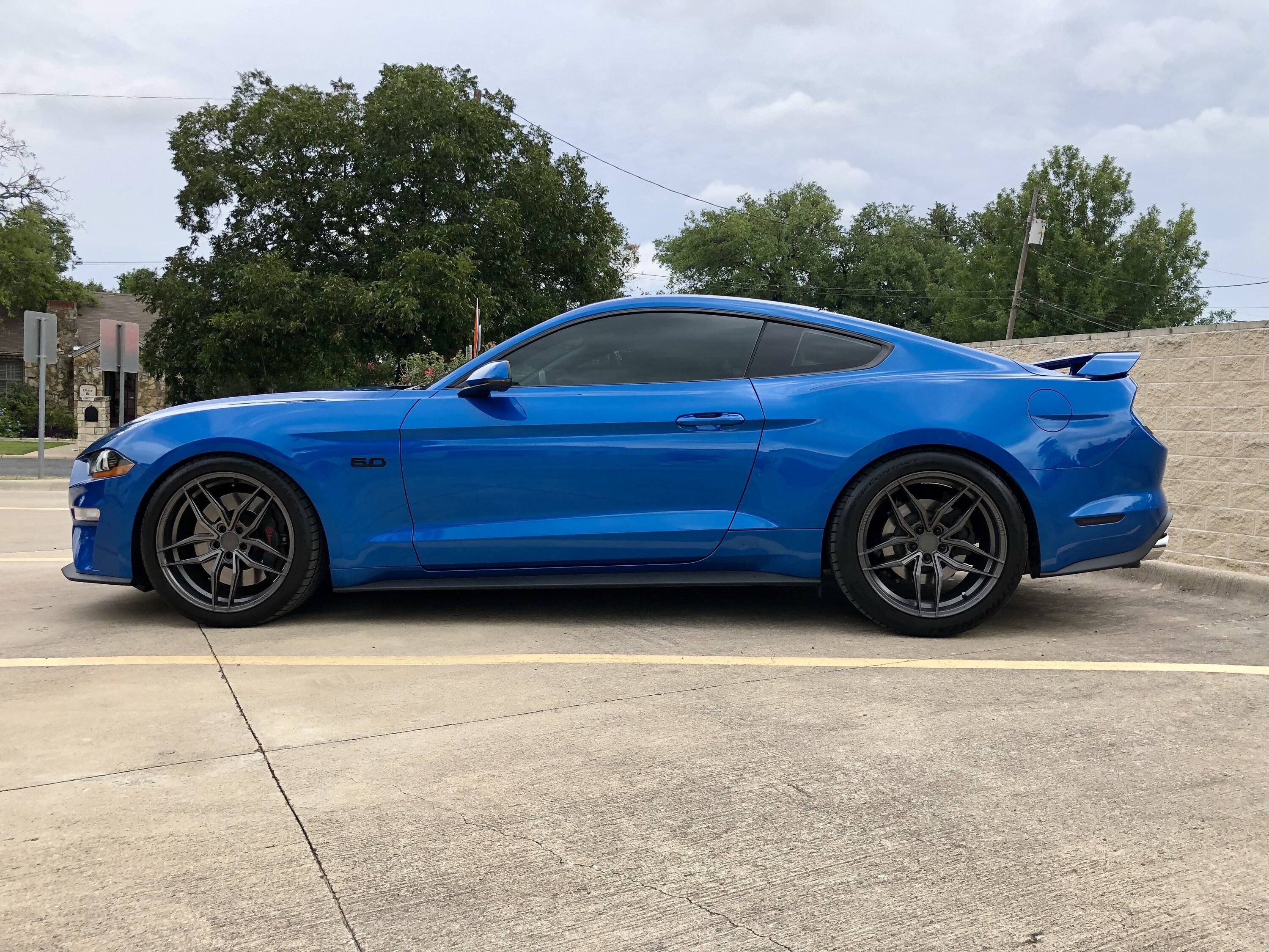

My setup is 20x9 & 20x11 Ferrada wheels on Continental Extreme DWS 06 tires (275/35/20 & 315/35/20). Performance Pack car dropped on Ford X springs. No rubbing or issues at all. Daily driven.

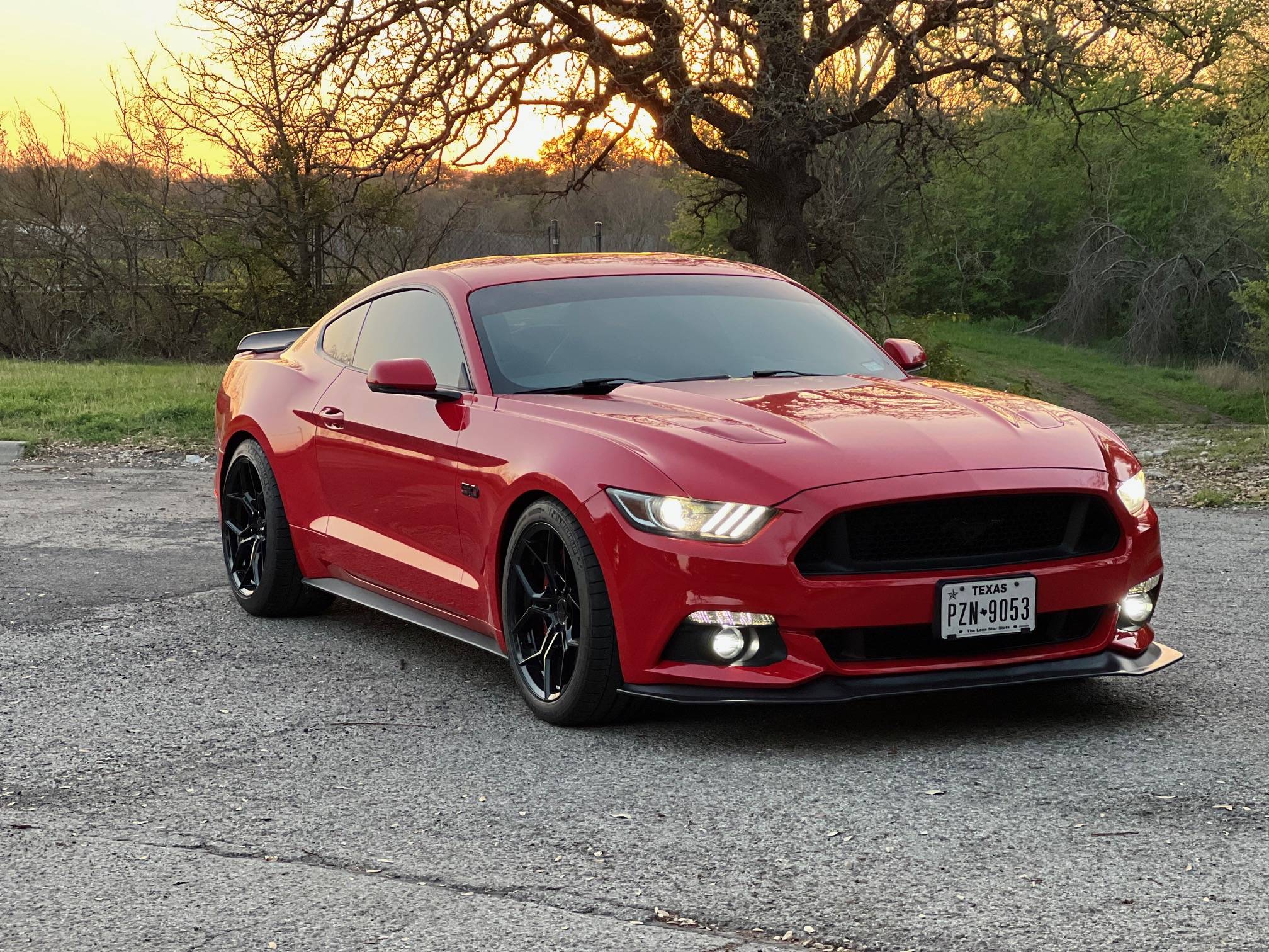

I have the same size wheels. I went with the Pilot Super Sport. 285/35/19 front and 305/39/19 rear. If I buy tires again, I will go with 275 up front so the sidewall stretch is the same. With the current set the rear seems to stretch over more than the front.
More pics here: https://www.mustang6g.com/forums/posts/3739225/
