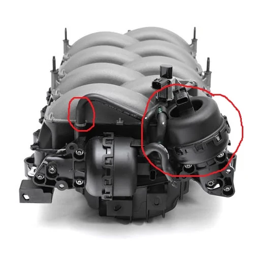

For those who locked out the IMRC's, is there a port on the back of the manifold sticking straight up to the hood that should be capped off?
I ask because the shop who installed my manifold left the large, black, round plastic piece(s) installed with their hoses.
My IMRC's are locked out with two zipties on each, but could this be the source of the low RPM bucking?

The port in the back should be blocked off as well as whats called vaccuum 1
This runs straight through the manifold to feed the Imrc valves which in this case are not being used.
I simply capped both ends off and have no issues with using the lockouts.

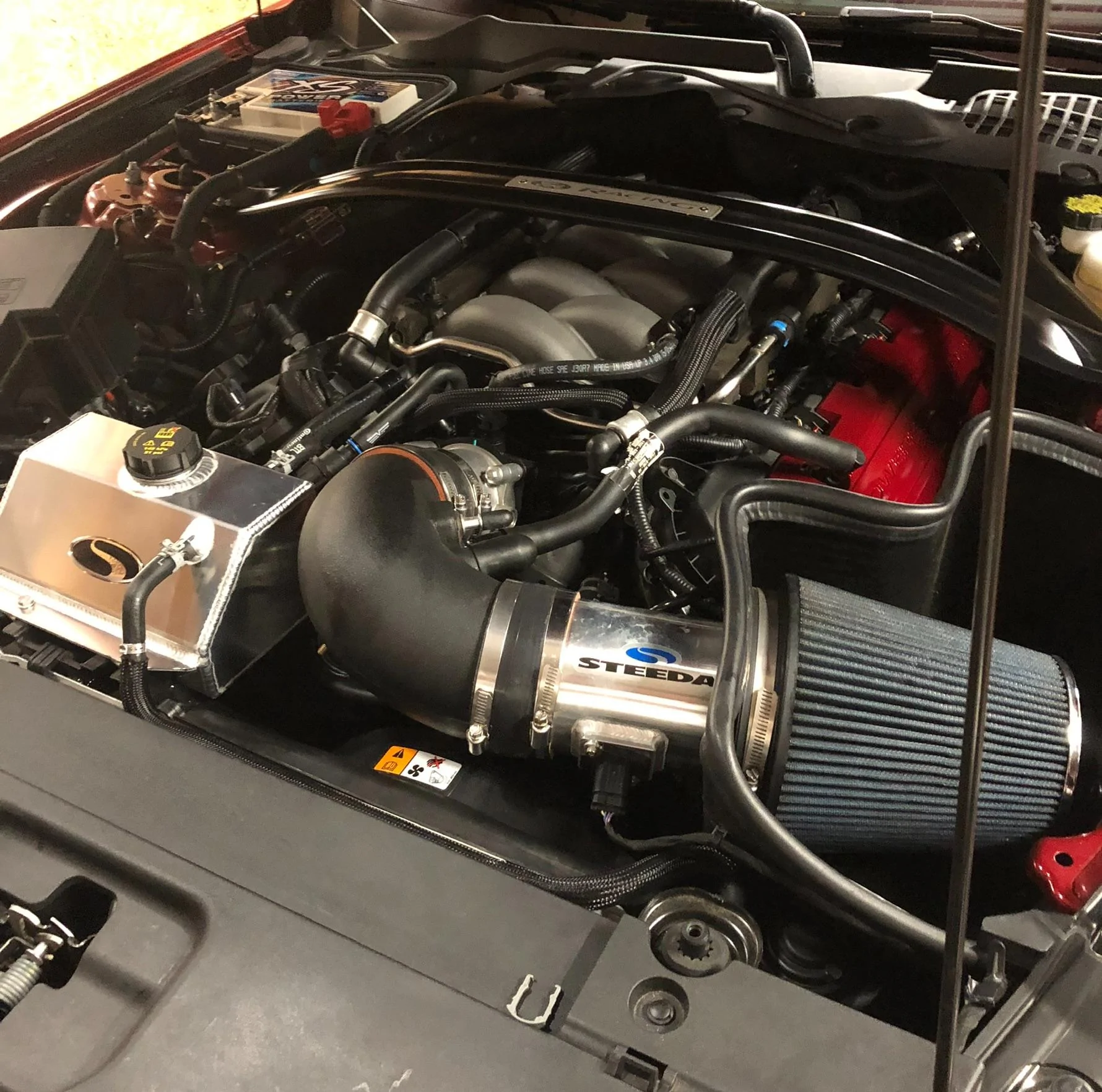

This is how my lines are routed.
No issues at all
Car runs perfect.
