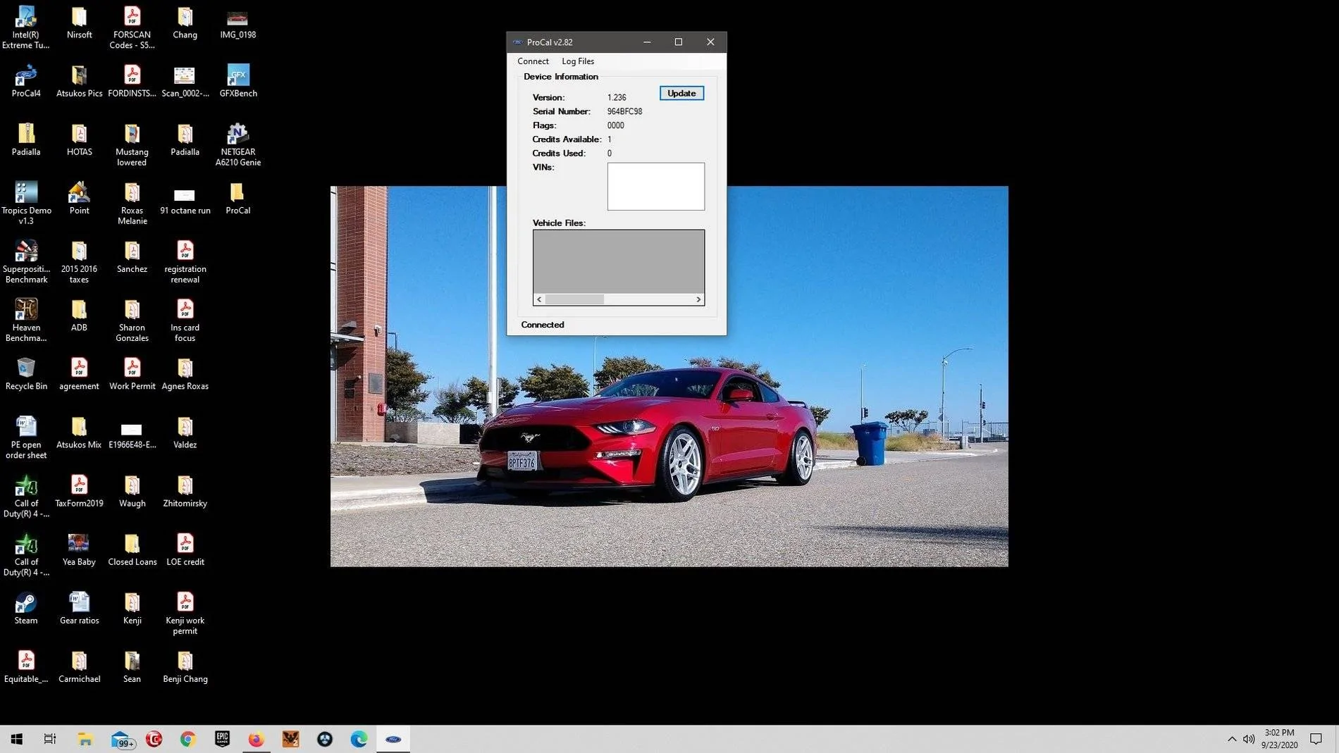

Got a question guys...downloaded the procal software and put in my voucher number. When its connected I don't see any files listed in the software on the computer, is that normal.
I read that it all shows up after you load the stock tune from you ecm into the device. And upload it to Ford. Then they lock the tune and send it back for you to flash. It was a few pages back in this thread.

Yep. Ford won't let you download new tune until you dowload your old tune to the procal and then upload to there site.

I registered mine myself last night. It was very easy. Install the Procal 4 software and updates after registering, take it to the car, plug it in and it downloads the stock tune. After that plug the Procal into the laptop again and it uploads the stock file then downloads the new tune.
