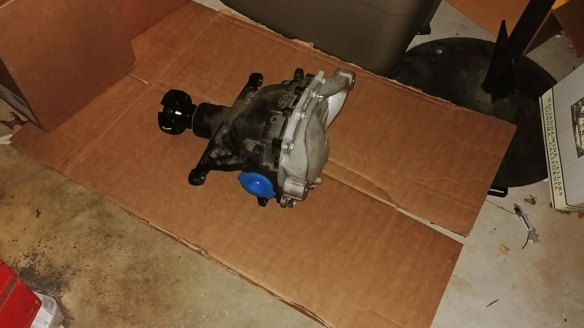

I swapped in a Torsen 3.73 rear-end from a 2018 Mustang into my 2016 by Fortes in Framingham. (the input flange from the 2016 diff was swapped onto the 2018 diff) The diff was dry, so BG Ultra Guard 75w-90 with the slip modifier was put in.
Immediately on driving home, I noticed that the rear-end made a whining noise, really noticeable at highway speed and still present, but not as loud, at "suburban" speeds. (40-45 mph) No serious vibrations or grinding noises when shifting, getting on the throttle, getting off the throttle or cruising. It's just a steady whine.
Should I take this to a shop to get it looked at? I've heard that whine is relatively common with 3.73 gears, but also whine can be symptomatic of a issue in shimming.
Also, maybe it's just a thing of getting used to shorter gears, but I've noticed that with the new diff, it seems to be a lot more "hesitant" getting up to speed. Like, getting on the highway, I keep the car in 3rd gear at 4k, and get on the throttle, and the car only goes up to about 4.5k, that is until I go straight, then the revs/speed starts building. This didn't used to happen with my 3.15 diff, is that the TC kicking in or?
