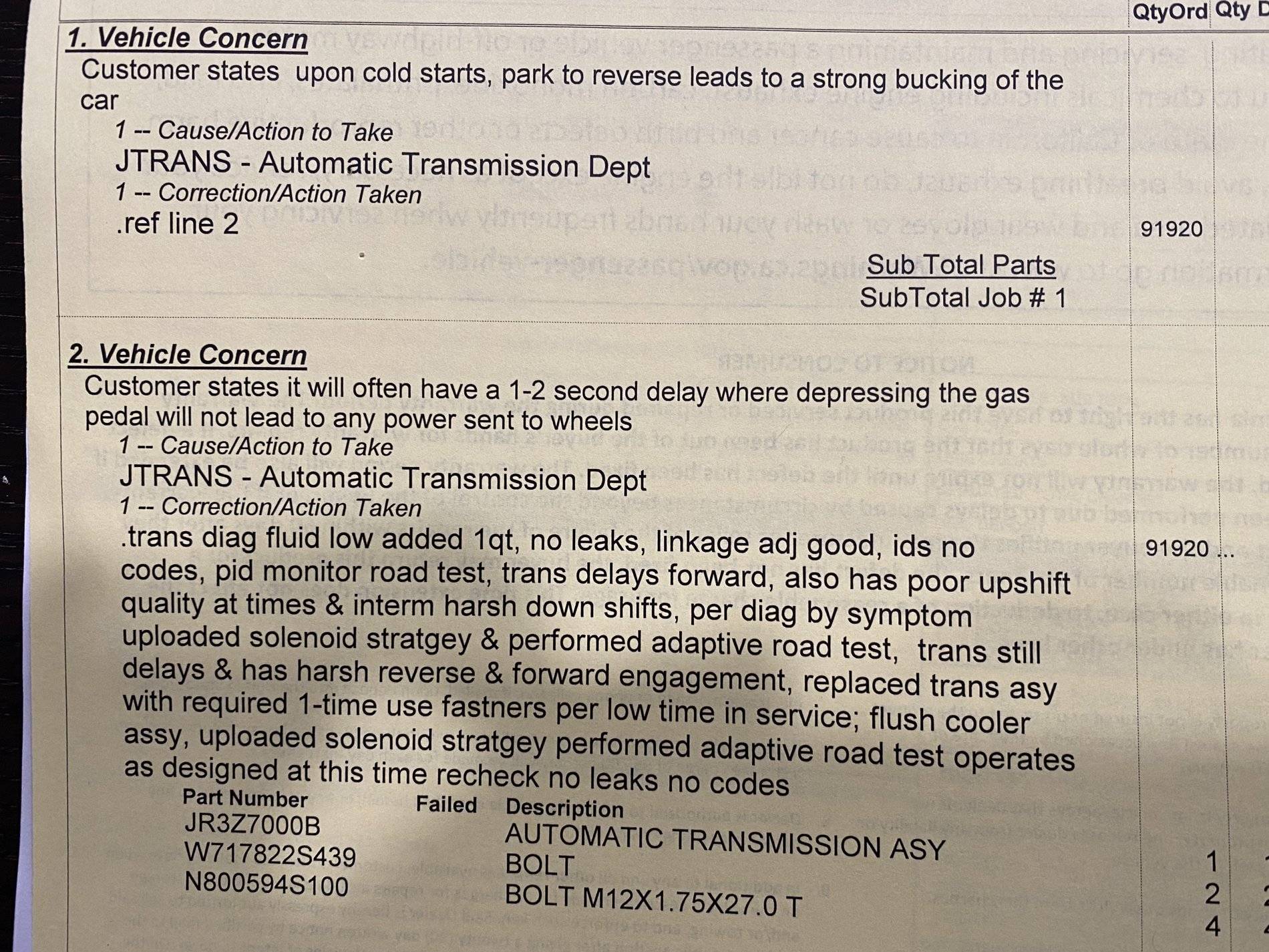

I just got my car after 3.5 weeks at the dealership. I got a new transmission.The transmission fluid was 1 quart low. They tried adding fluid and resetting the transmission software, but it didn’t help, so they replaced the whole thing.
I will admit in my short ride home there was no more clunk in the downshifts and going from park to reverse had no bucking at all. I’ll keep everyone posted if gremlins appear.

About a week with the 10R80 replacement transmission and things are quite good. I’d say the only thing that remains, is slight bucking when going from park to reverse when the car is cold in the morning. Even the bucking is much improved.
the clunkiness in downshifts especially from 4-3 or 3-1 that used to be a clunk/thump hasn’t shown itself on this new transmission at all. It also doesn’t lag as much when the gas pedal is depressed.
The one new thing, which may have existed in the old transmission is there is a mild whining sound that you can exacerbate even in park if you rev the engine. It isn’t too bad, but noticible.

The whining is normal. Straight cut gears for the pump I believe.
Good to hear they fixed you up.

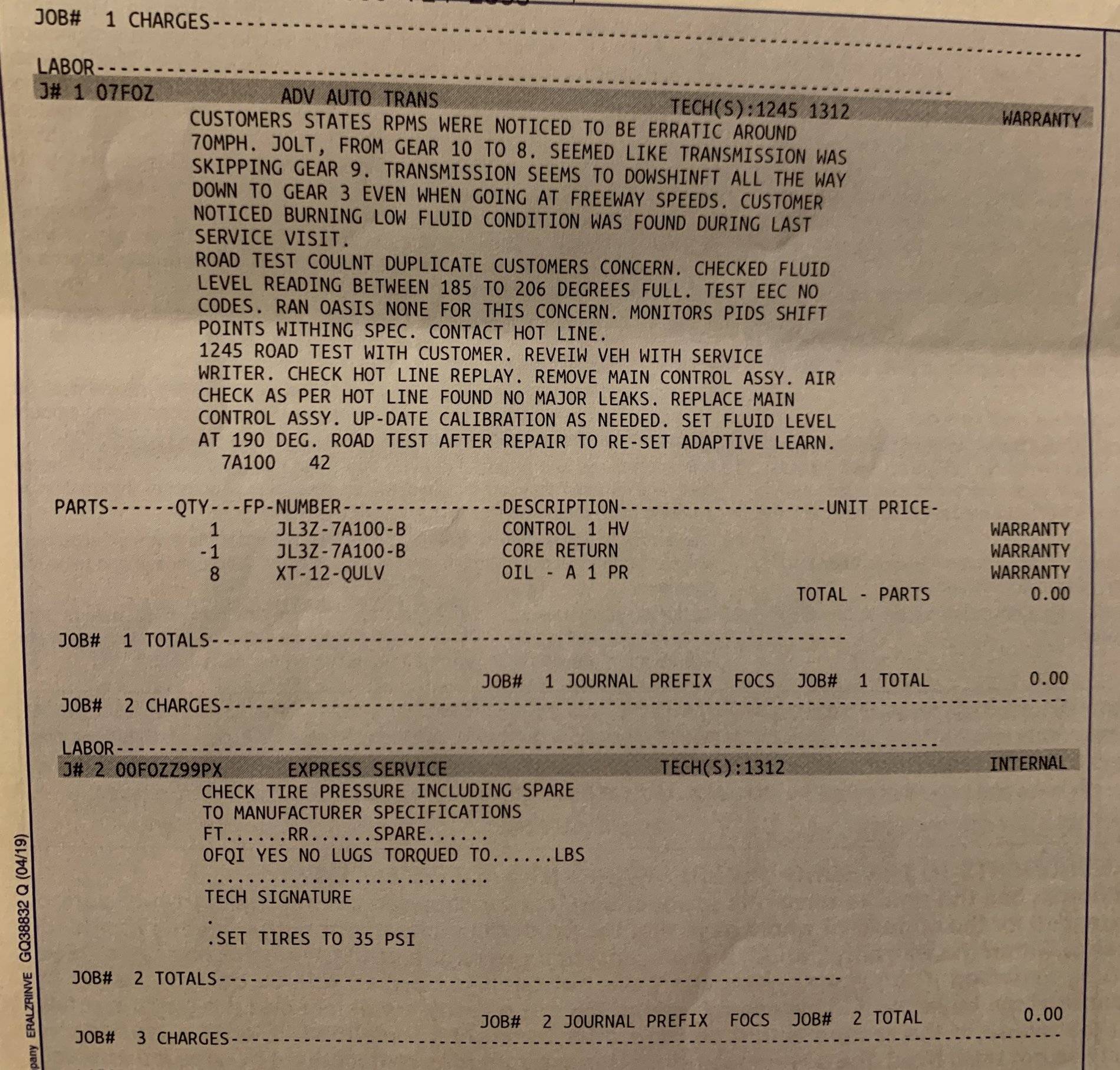

Two weeks ago I got my EB18 back from dealership. As a reminder, this was my third visit to the dealership, it started with the strong jumpy engagement when going from P to D, or R to D (they found low trans fluid on my first visit), then a crazy erratic shifting at highway speeds happened once, finally I felt harsh shifting at certain gears, especially in S mode. After long discussion trying to convince dealership that my transmission is not safe to drive (although they claimed everything is normal), they called me saying they will replace the valve body (after speaking to the Ford hotline).
I don't do too much driving nowadays because of shelter-in-place, but even with occasional drives I can tell that the harsh engagement from P to D, R to D is completely gone. This weekend I took a road trip, around 200 miles. Shifts are definitely smoother, and I had no issues at highway speeds, all the shifts were as expected. However, I do feel some harshness when going from a stop 1-3, and 3-5, not much but I feel it, its not buttery smooth. Also coming to a stop, I feel a bit of shakiness on 4-3-1. When I put more throttle the shifts seem more smooth. Sometimes I feel it a bit at gear 9. Now, I might be exaggerating, as this was a VERY stressful problem for me (wife refuses to drive the car until I verify everything is perfect), so I am very focused on shifts when driving, and probably feeling every shift more than a normal driver would. Also, I wonder if the adaptive learning is still learning my habits, due to the clearing of adaptive tables?
I didn't play with S mode much, tried it once, and at heavy throttle it felt really good, however at lower speeds, ie mild driving, I felt a bit of harshness. Now, I guess in S mode the car shouldn't be driven mildly, so I will play with that more for a better update. If anybody has recommendations what to look at here, I would be happy to hear!
I have few more questions for you guys, as you helped me immensely so far:
1) When people say "they don't feel the shifts", "it is buttery smooth", etc, is it really that unnoticeable? Before this problem happened, I wasn't paying attention so I don't have a baseline to compare to. I mean, I can still feel ALL the shifts, all of them, some are VERY smooth, some are a bit less smooth.
2) Looking at my tech report, JL3Z-7A100-B (valve body) appears with (+1) and (-1) quantity, so I am afraid they removed it to inspect it and put back the same one. Can someone confirm that this report says I have a new valve body and not the same one? I am a bit confused with the phrasing and parts listing. If the say "replace main control assy", does it mean I surely got a new one?

@filipradenovic, I think
+1 for the control valve means that you got a new one under warranty.
-1 means that your old valve will be returned to be re-manufactured. That is what "core" means - the main casting part will be cleaned and reused to build a re-manufactured unit.
You could go to manual control while in S mode. That is, move the shift lever to S and then use the paddles to make every up/down shift manually. That way you are ready to sense each gear change at your own pace.
It is understandable that you are overly sensitive to what's going on after everything you've been through. After the adaptive learning seems to not be changing anymore, get your wife to drive it and see what she thinks.

It says they set your fluid level based on 190 temp. That is actually low right? should be 205-214 or so? Not sure if a few degrees makes that much of a difference, but are you able to check your fluid level? would be curious where it shows on the dip stick
Unfortunately, I am not able to check it myself. I am looking at the report from my first visit to the dealership (when they found it was low) and they checked and added the transmission fluid at 185 degrees. So it seems they think it doesnt make a difference :)

On your service invoice - after the valve body replacement - did the tech do the trans relearn procedure? They have to do that step so the trans is not all jerky. Go to my first post in this thread, scroll down to the pic of my work order and you will see the tech notes for the valve body replacement - is your work order like that? If not, I’d be willing to bet they did not do the trans relearn procedure properly. Did they make note of reflashing the trans to the most current software revision after the valve body replacement?
