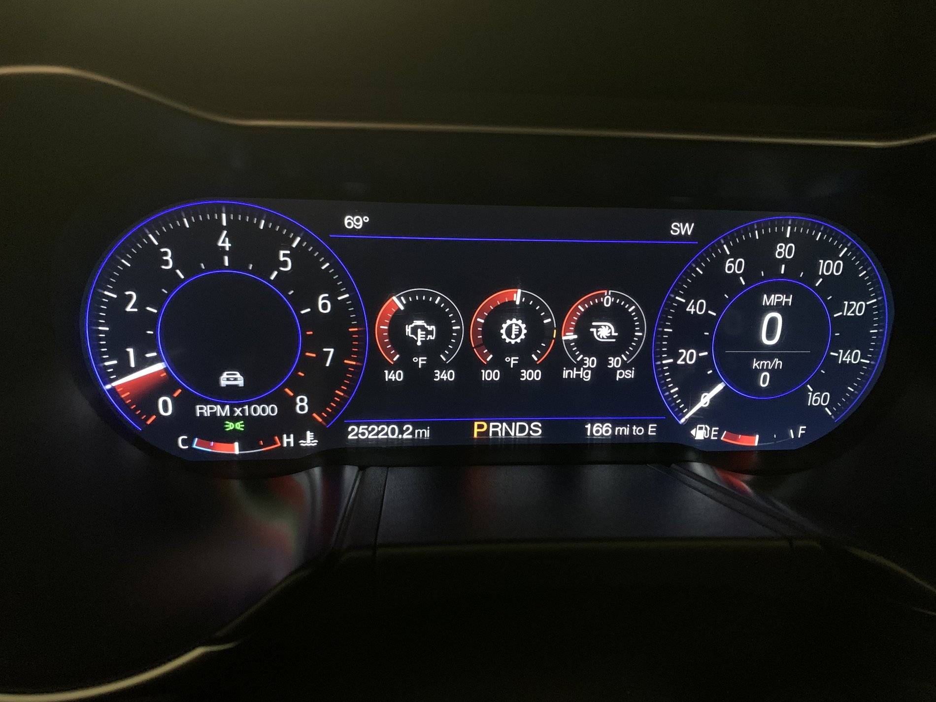

On the drive home, I drove in sports mode for a while, paddle shifting, playing with it, but normal driving, didn't beat it. And my transmission temperature went over 200F a bit, image attached. Is this ok? Is there a temperature over which I should be worried?

Dude, it is pretty normal a10 behavior you are describing. Also 200-205 is normal operating temps. You need to to either accept it or move on to another car. jmo.
