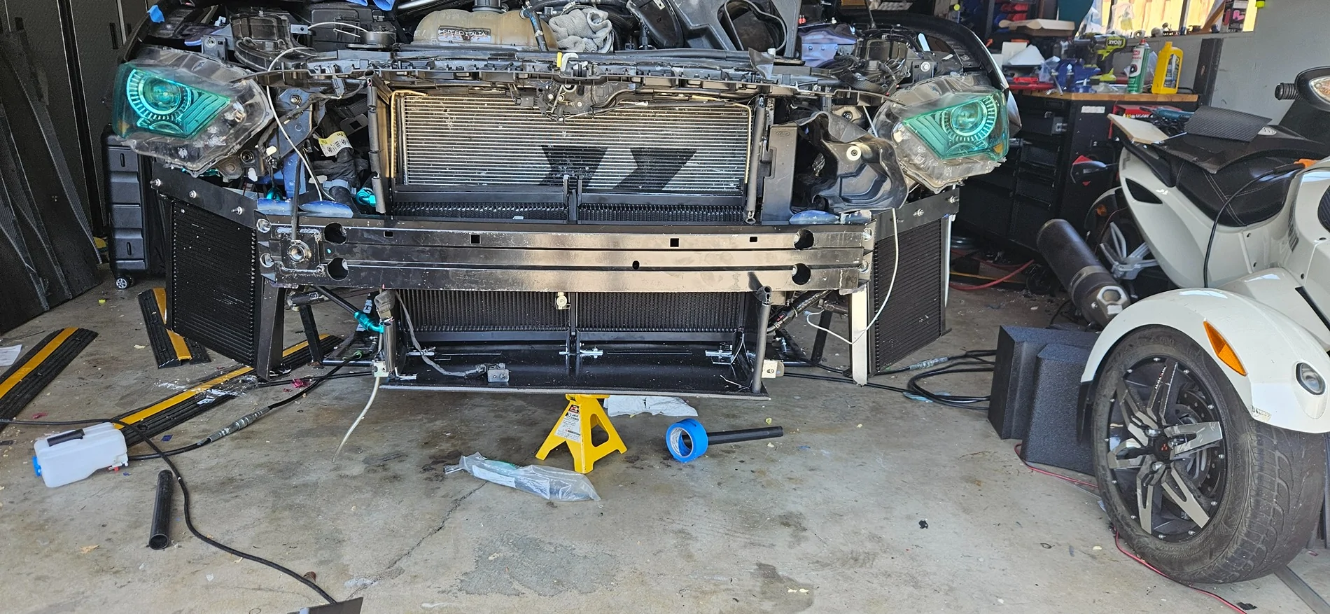

I just installed a second OEM cooler in series with the first one. Normal temp on the street and never exceeds 215F on track. This weekend it was running 200F at Putnam.
Trans behaves both sitch.

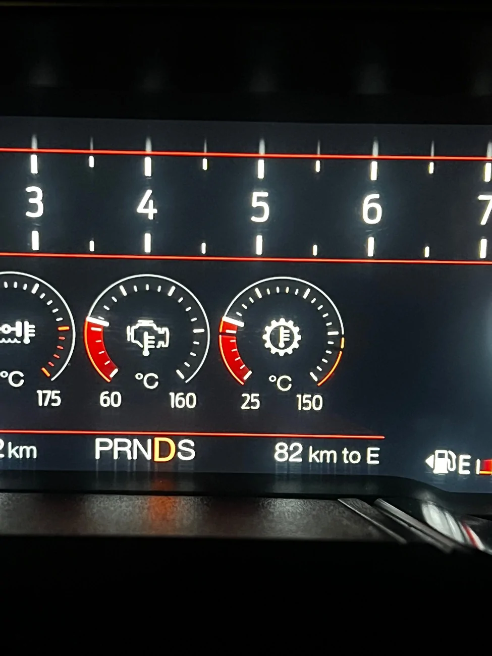

Used to have a high temp on my 2021 gt performance 10r80, in the past it was reaching 212 F it’s a pit more than it should be while normal cruising. In a traffic light it reached way further. Am typing now and i just installed the thermal bypass valve by myself, and it sets on 130 F which is Quite obviously remarkable change. I would recommend it for sure.
