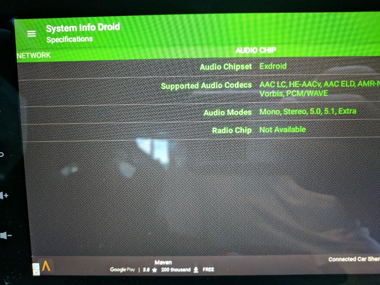

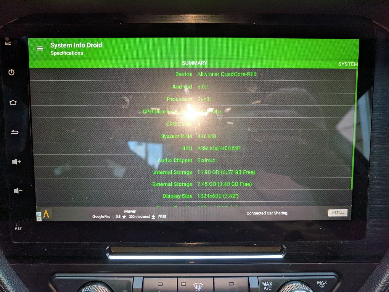

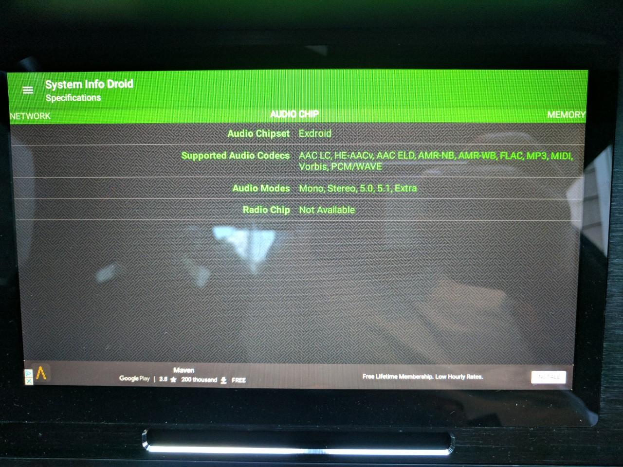

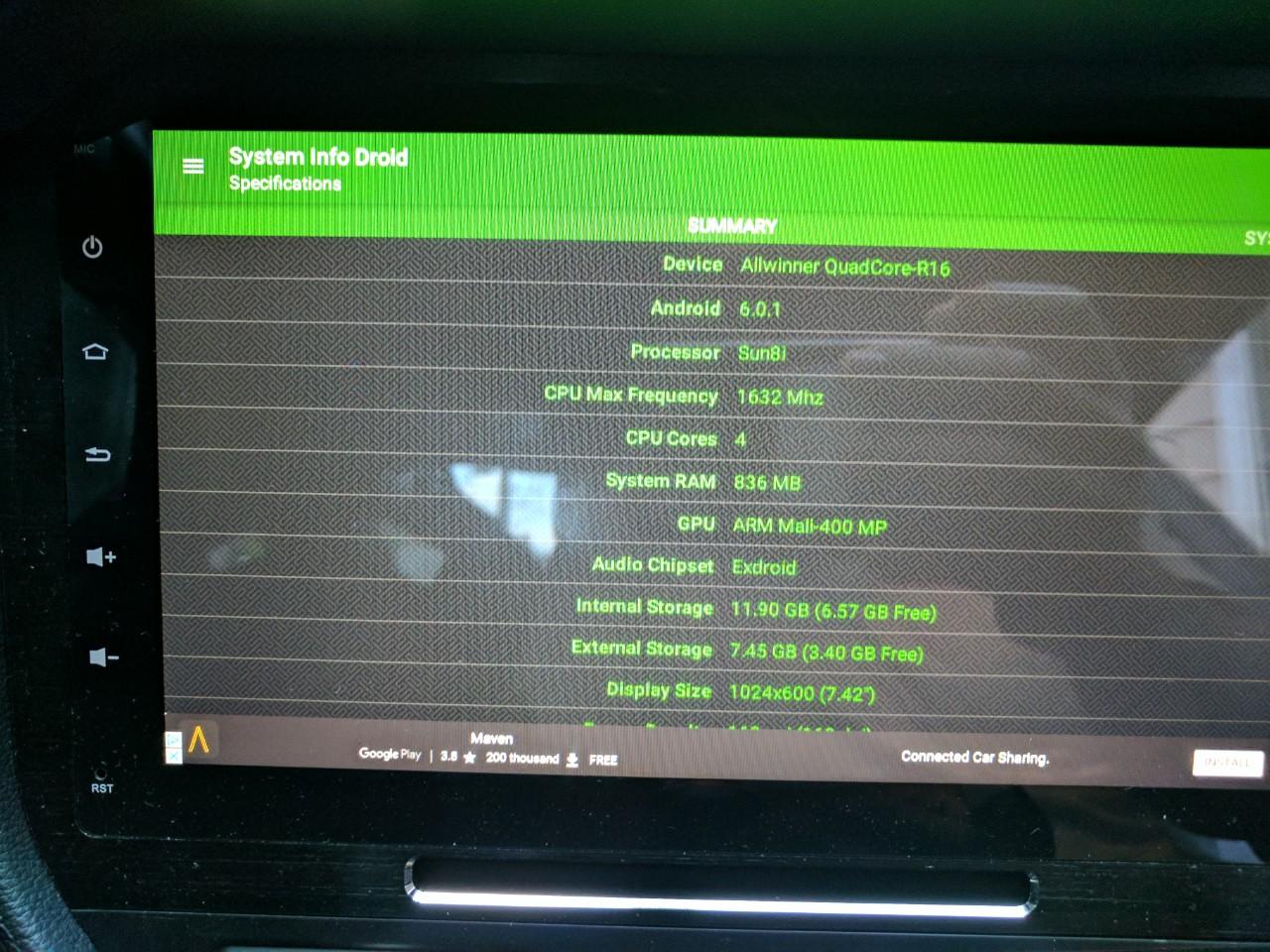

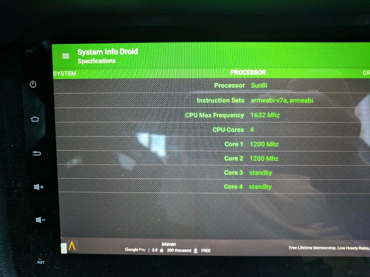

Also, has anyone rooted theirs yet? Is this a Rockchip processor? Can someone run this app (or similar) and send me the results so I can see what all the hardware is?
