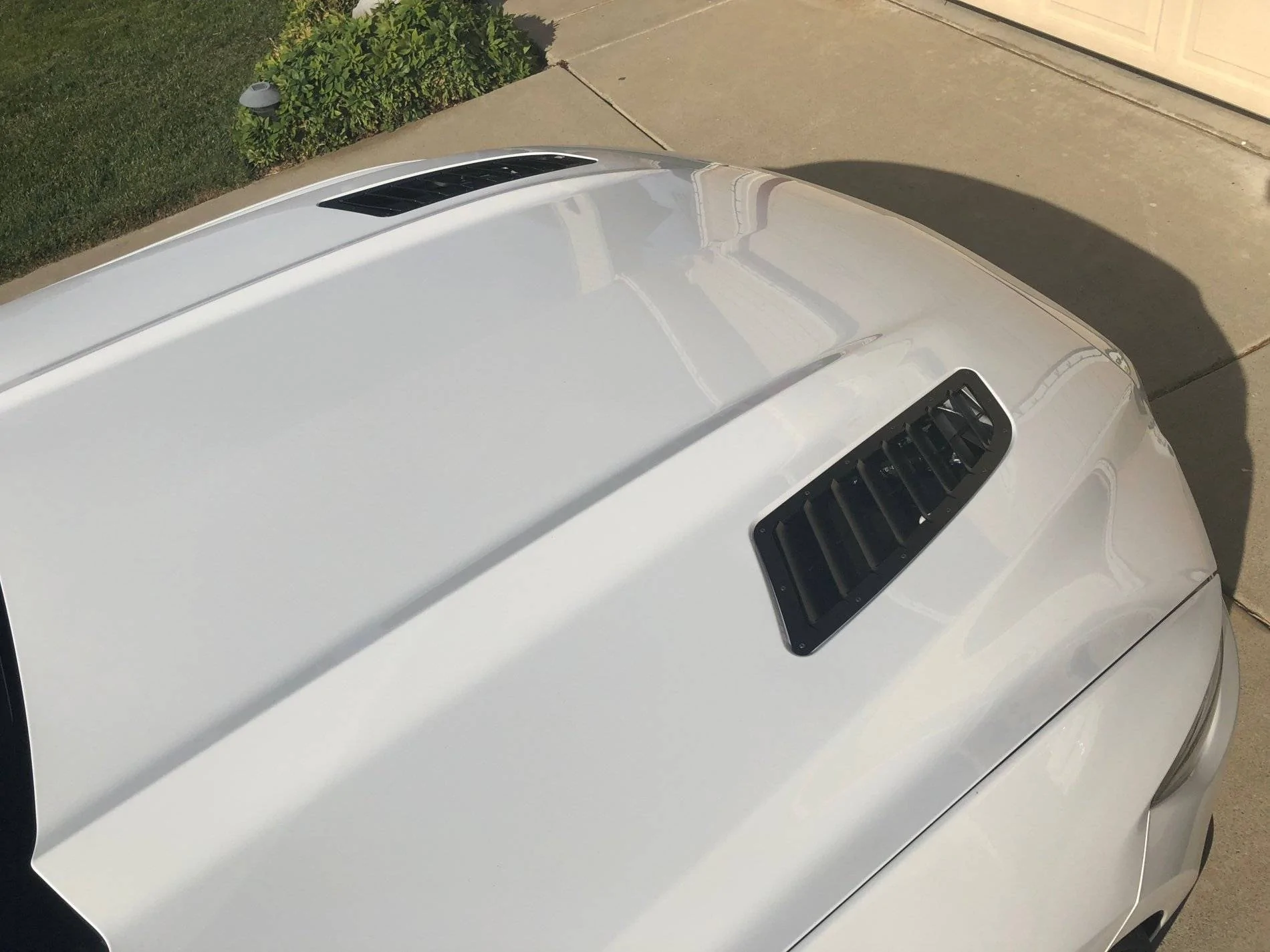

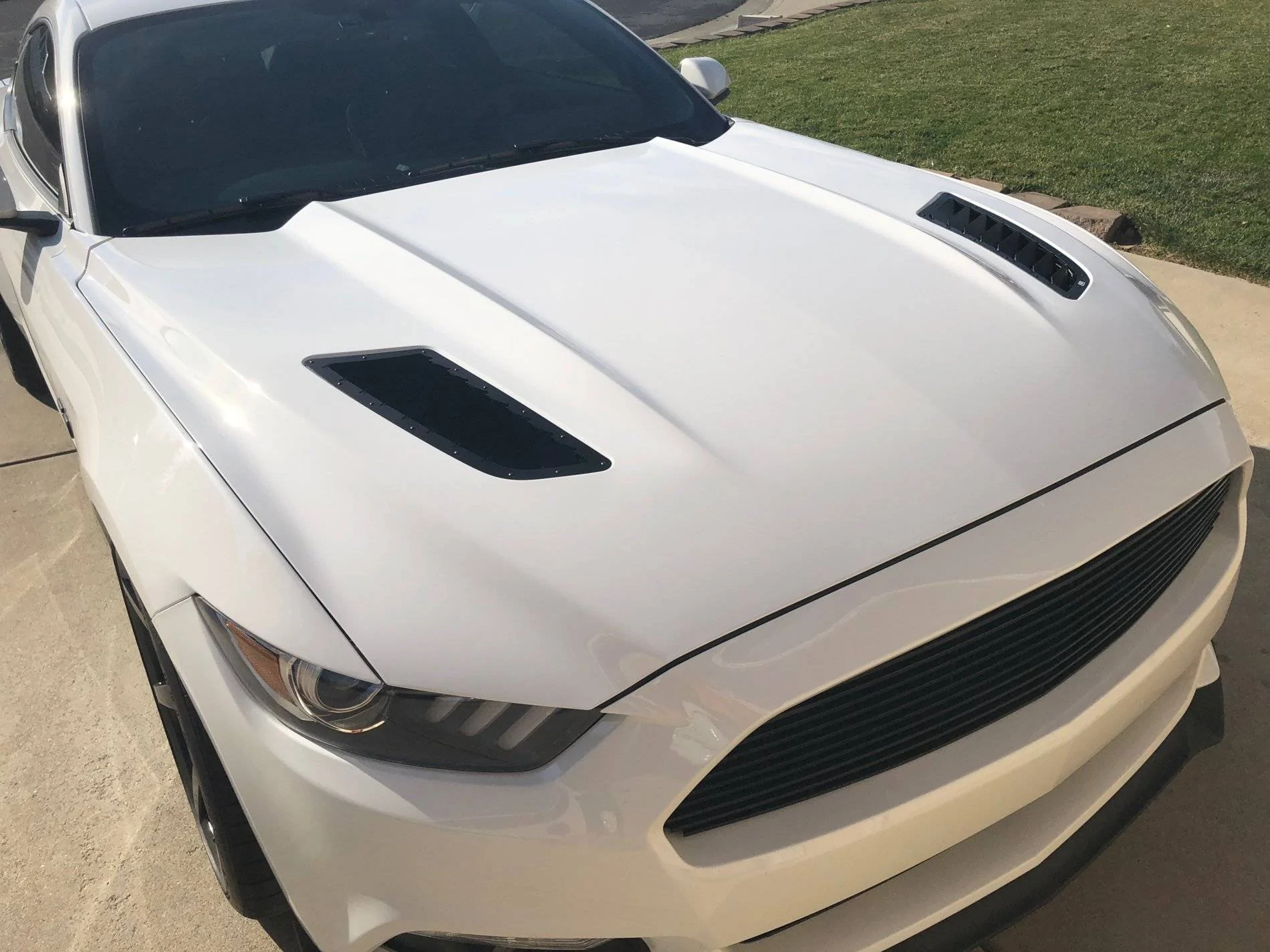

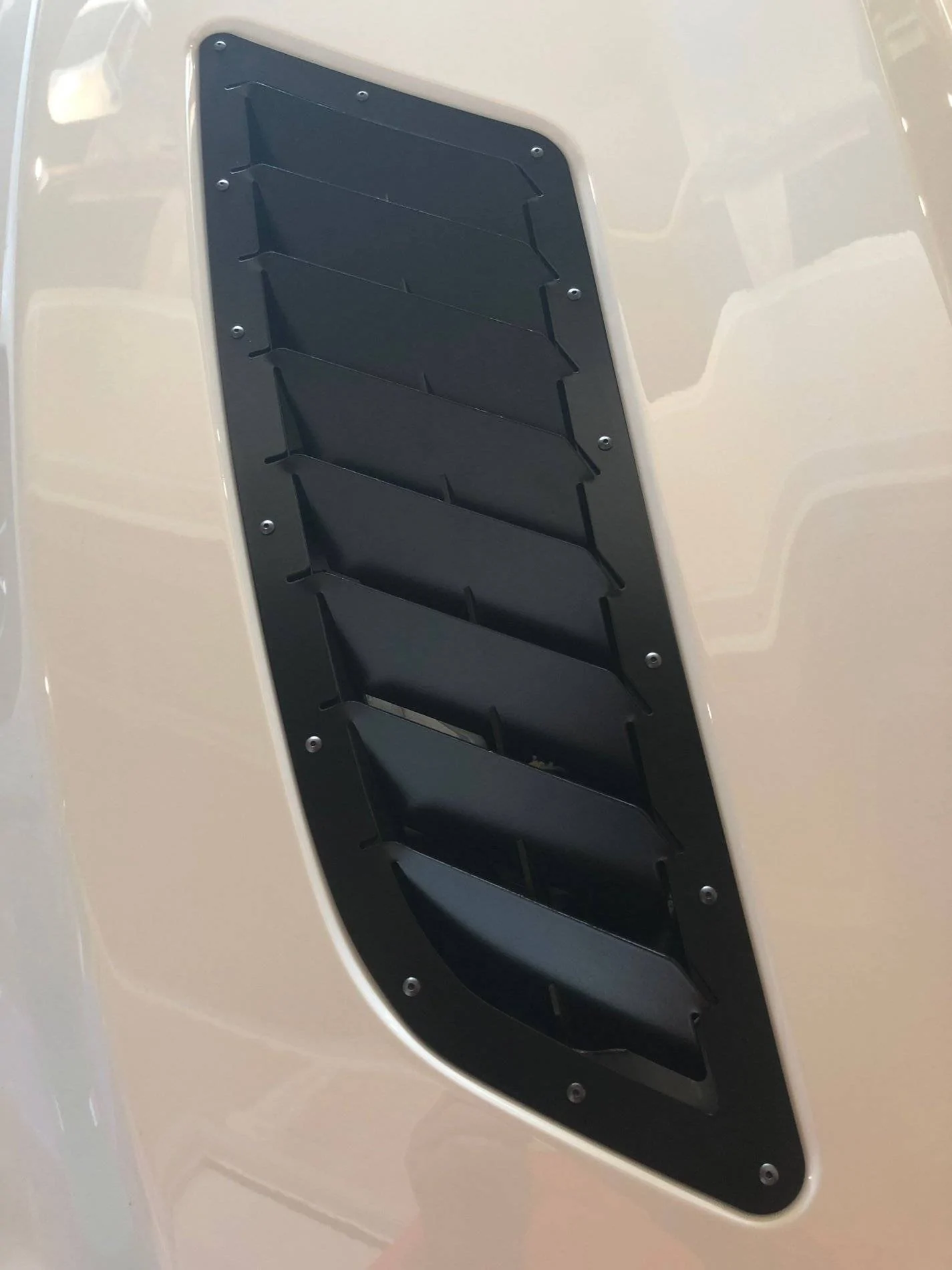

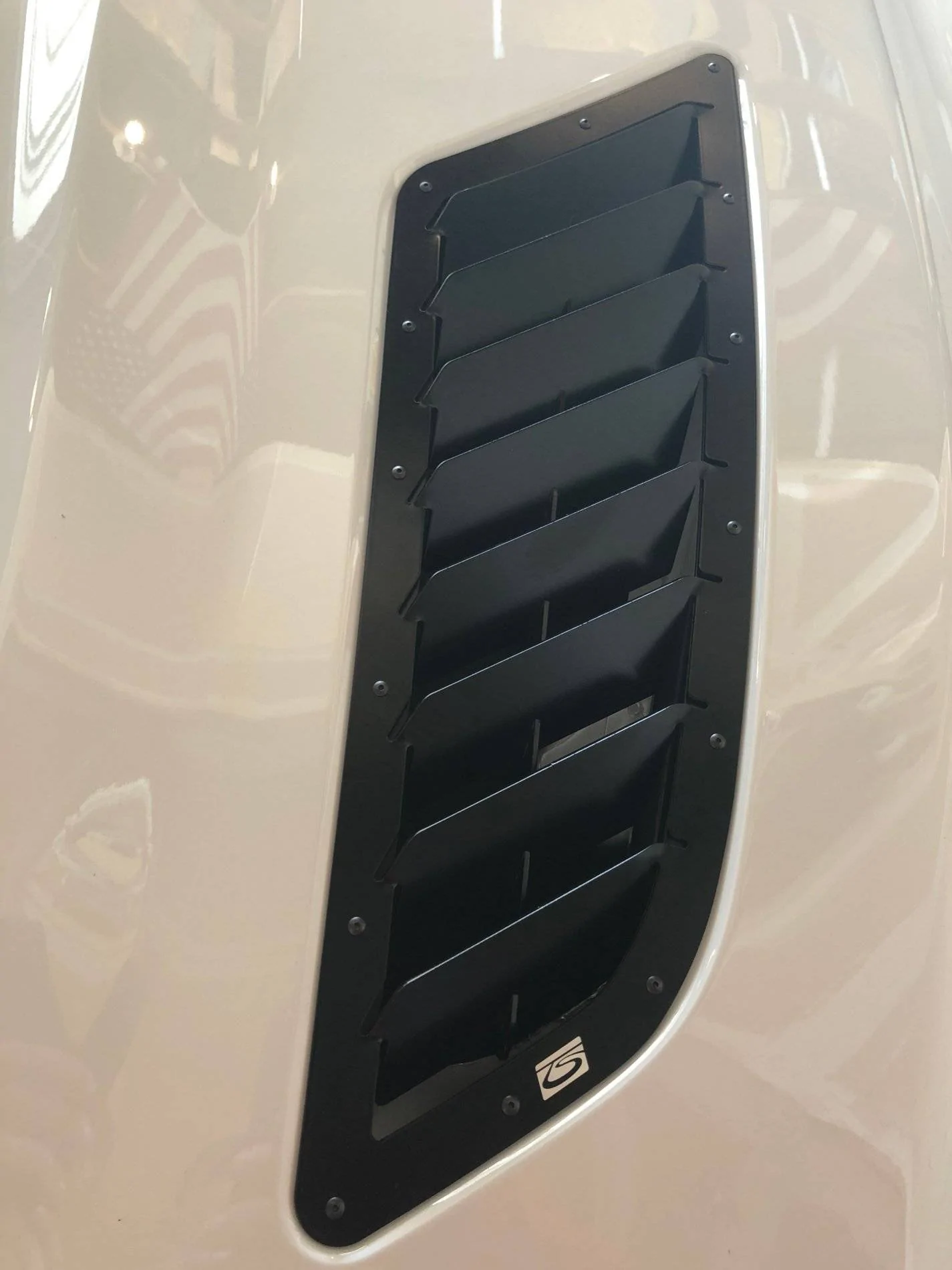

Here is a completed picture of the top and then I'll show my process which for the most part followed their instructions but I added a couple steps myself which I will point out.

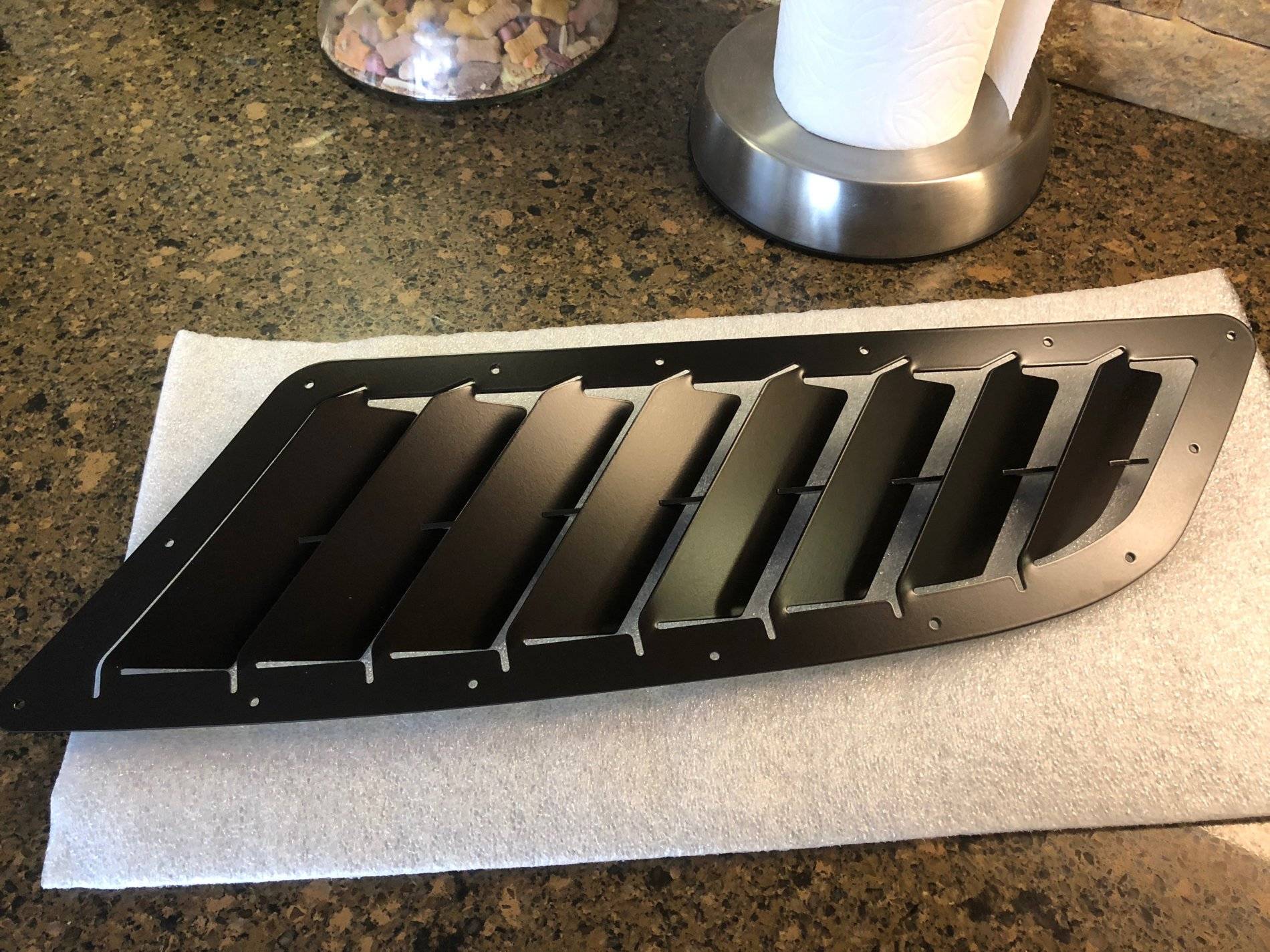

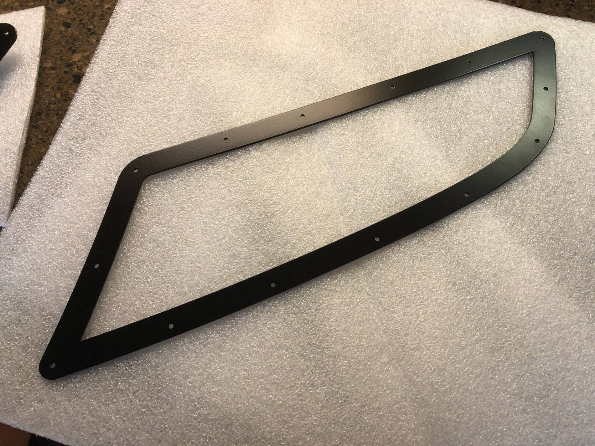

Let me start by saying the quality of materials and finish are topnotch on this product. The main parts consist of the top vent, under mount bracket, and bolts with washers and nuts. Packaging was also something considered for problem free delivery.

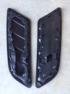

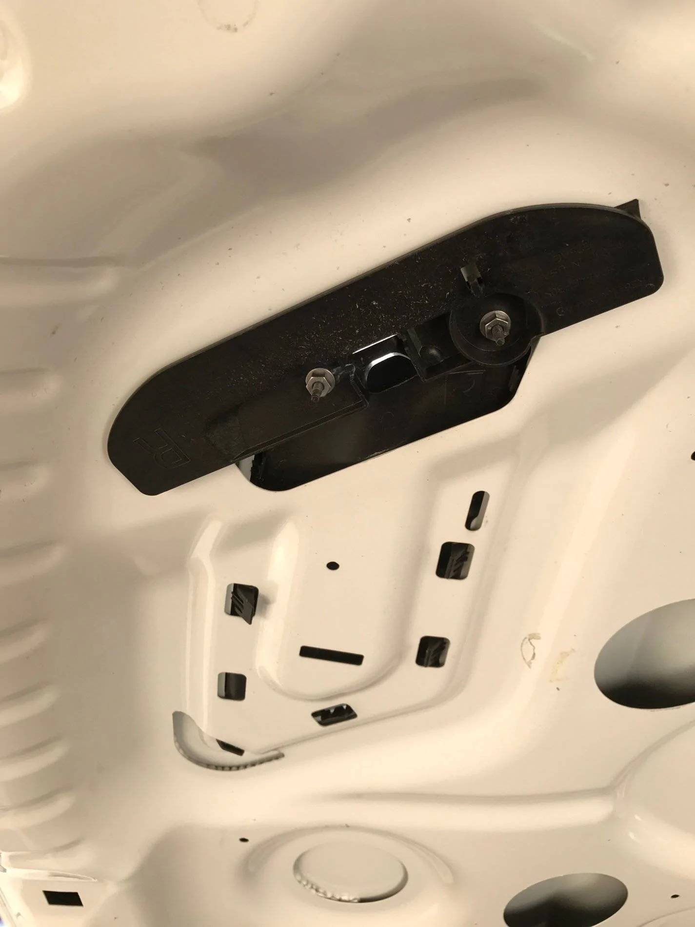

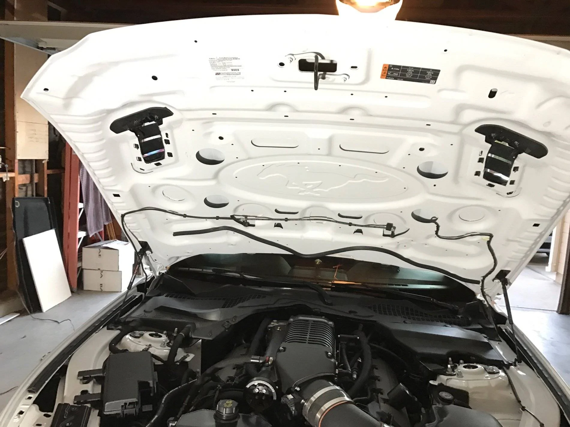

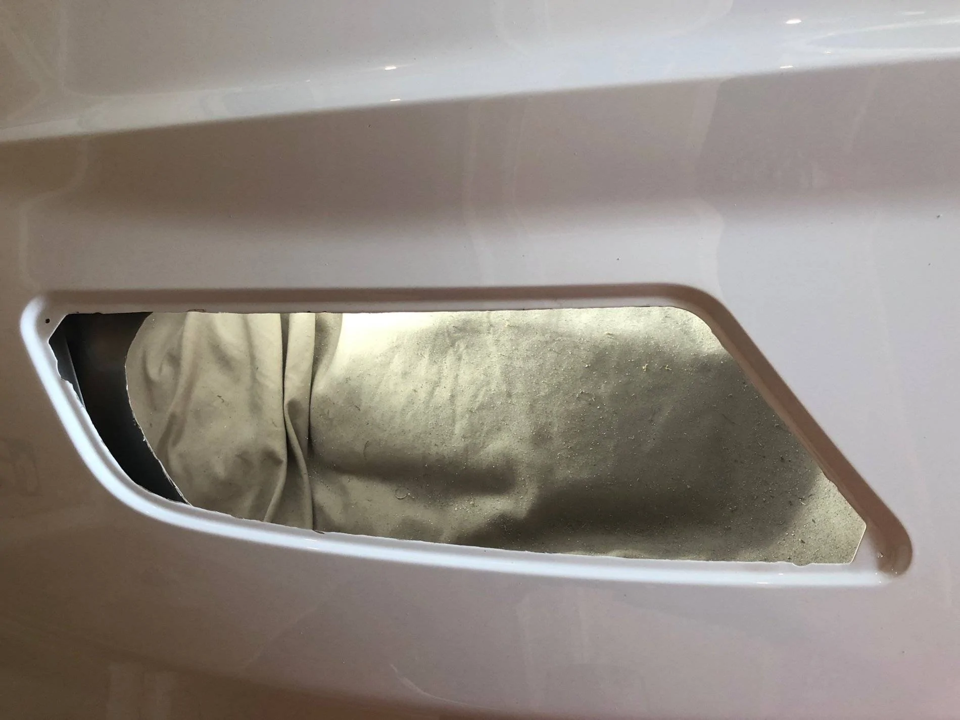

So here is where I started even before this. I took my Roush vents and gutted them like in this picture and then did some minor trimming of the hood to let better airflow out. That small hole in the uncut Roush vent is what is stock on this and our stock vents. I truly believe they are more more water draining than anything else as they are just worthless for venting. Please excuse the pics from going one side to the other but wanted to show the difference.
Stock
Cut section
Old new hole
And with the gutted Roush vent installed for better air flow

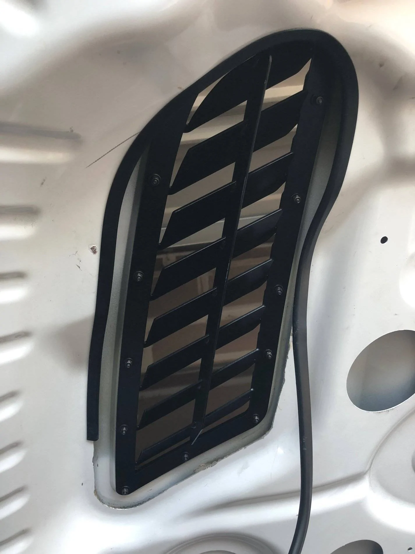

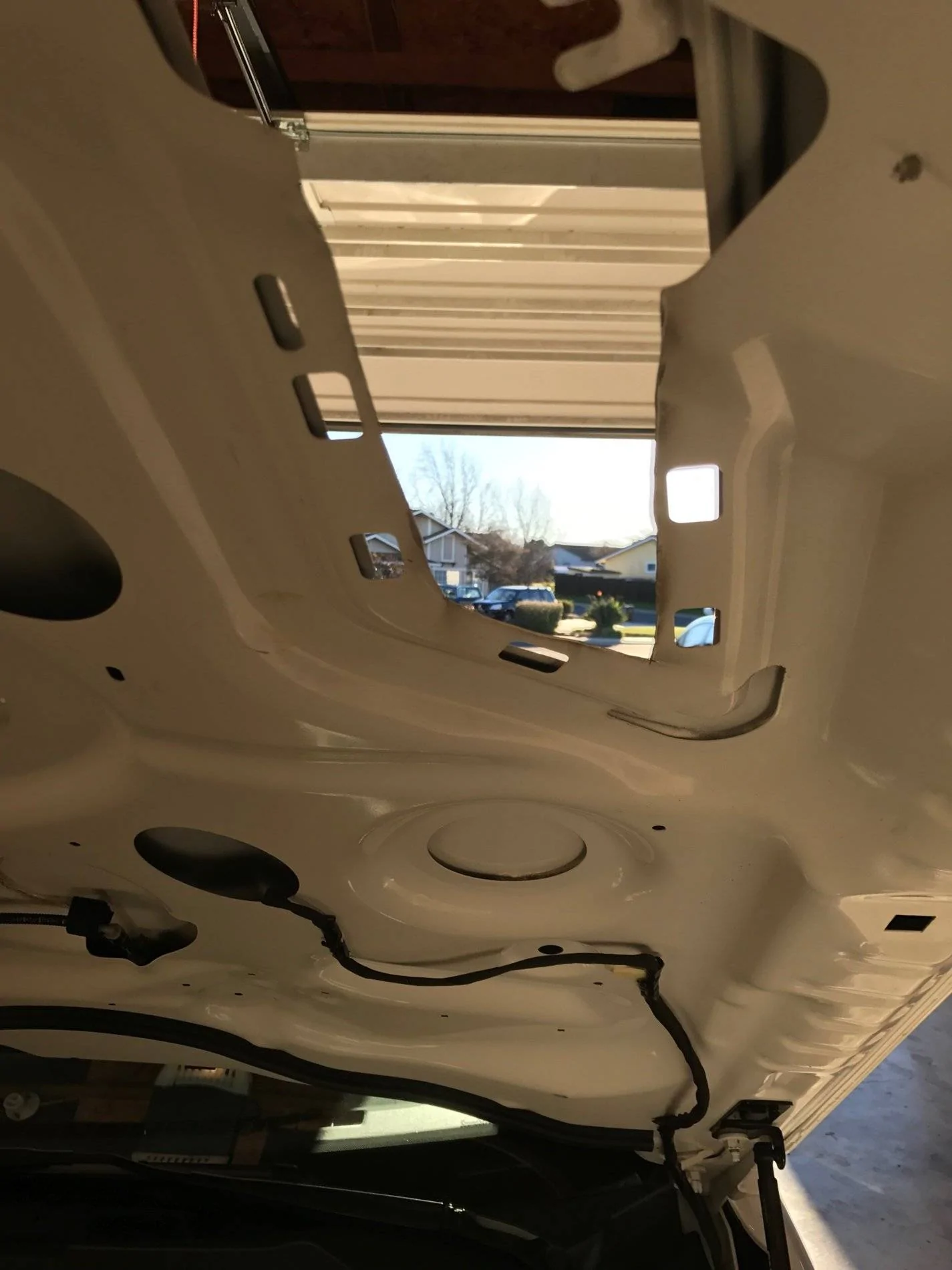

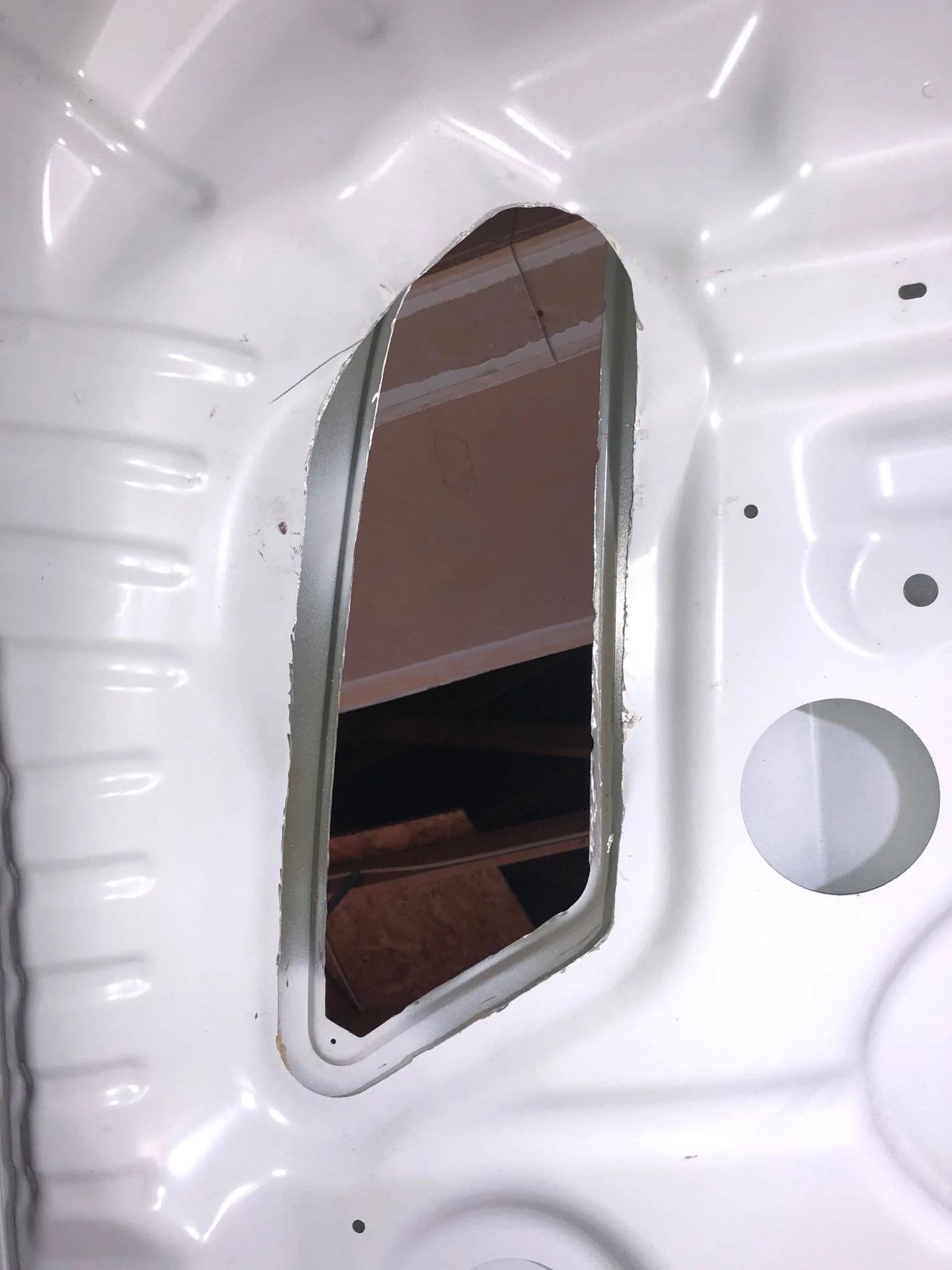

Ok, so I said this was helping but not as much as needed to be so here is the next process with the TRACKSPEC vents.

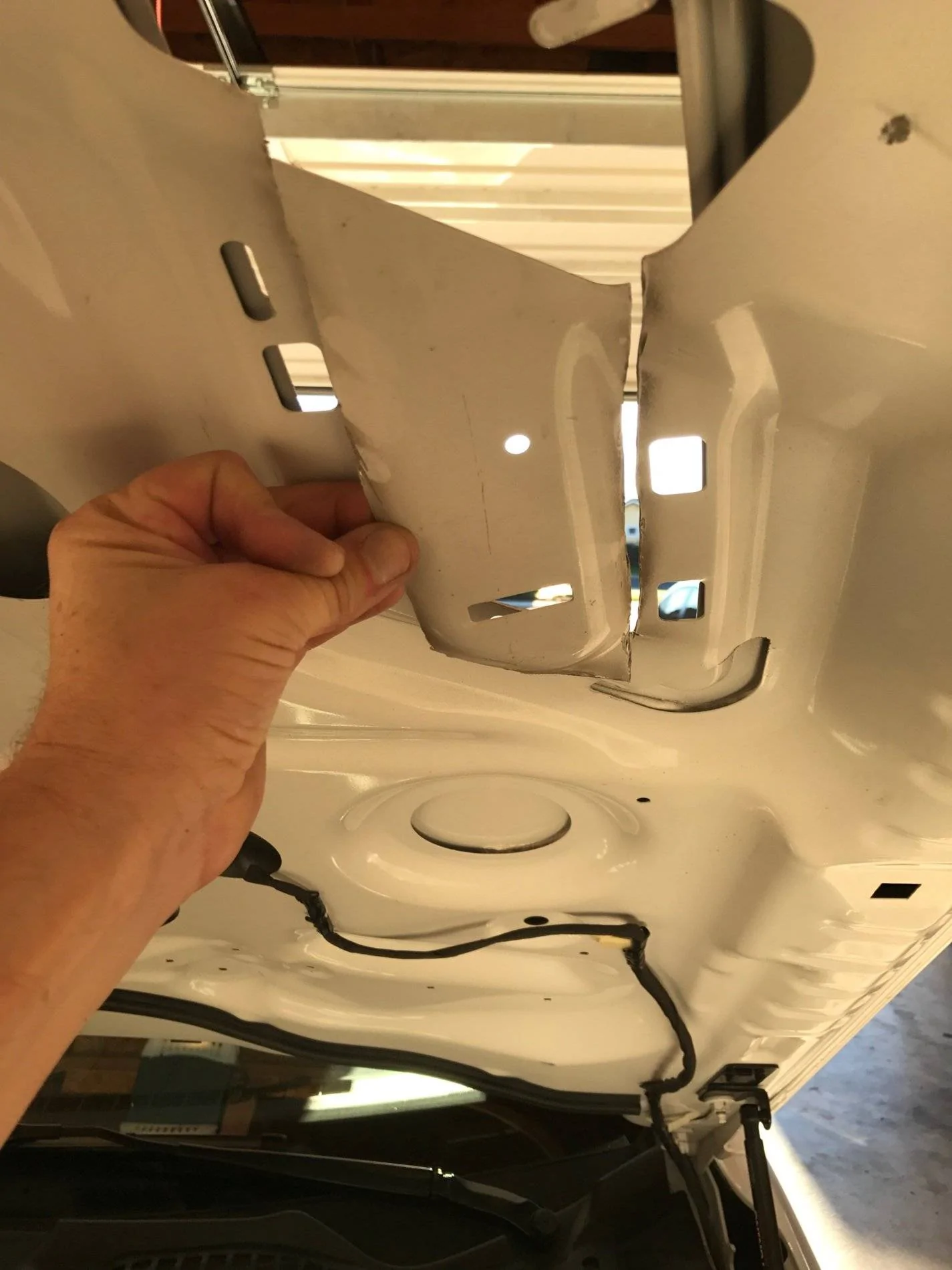

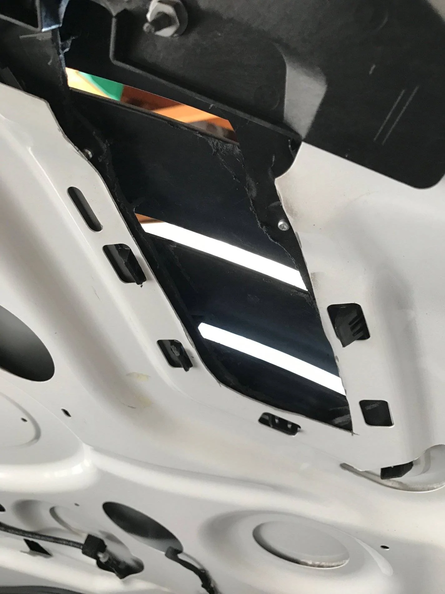

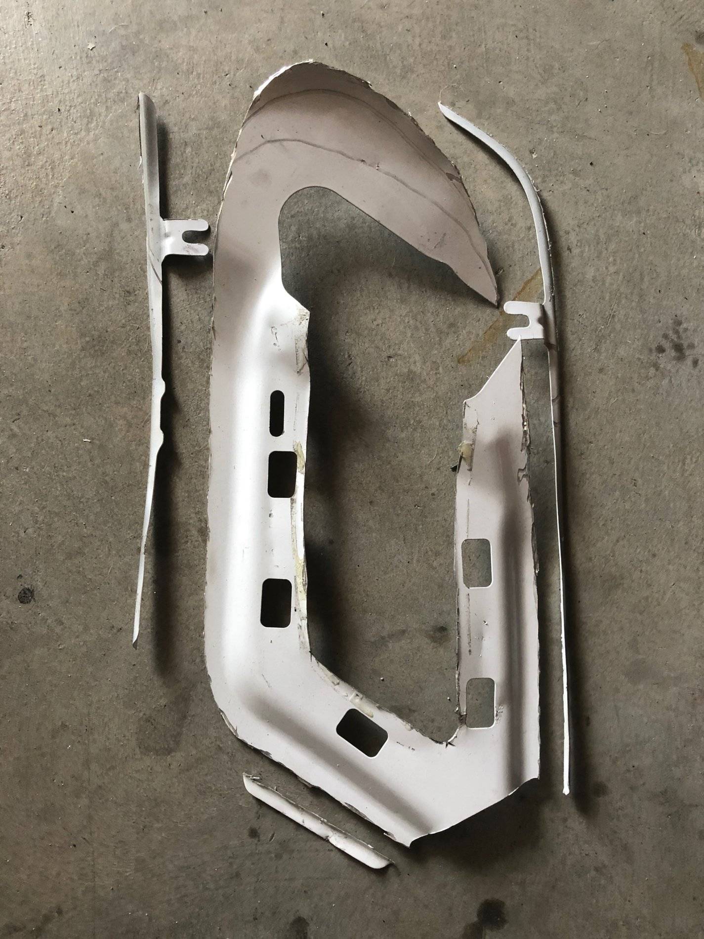

This is what I cut out now.....Boom.
You can see in the above pic I chose to drill holes in the two corner sections that line up with the holes in the vent. In the instructions they just have you grind those out but I liked how I could set the vent and knew where it laid perfectly and center punched the area and drilled. This worked very well but their way would have been fine to.

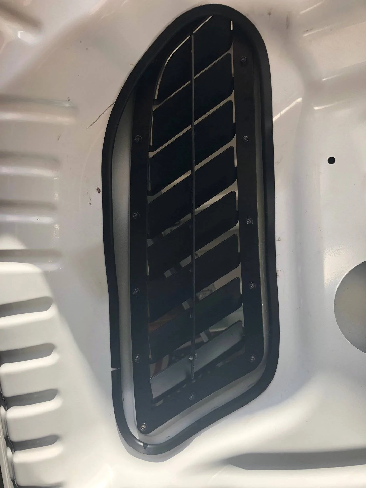

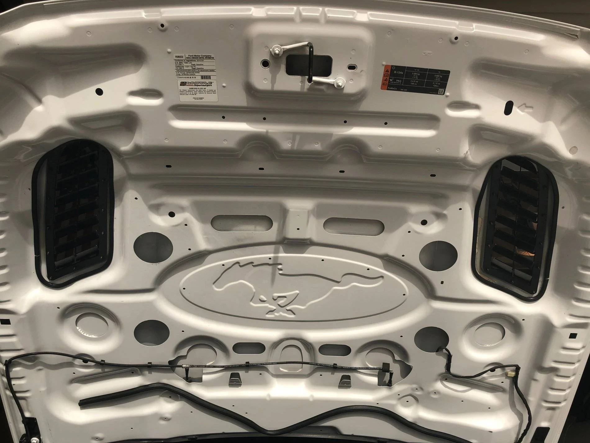

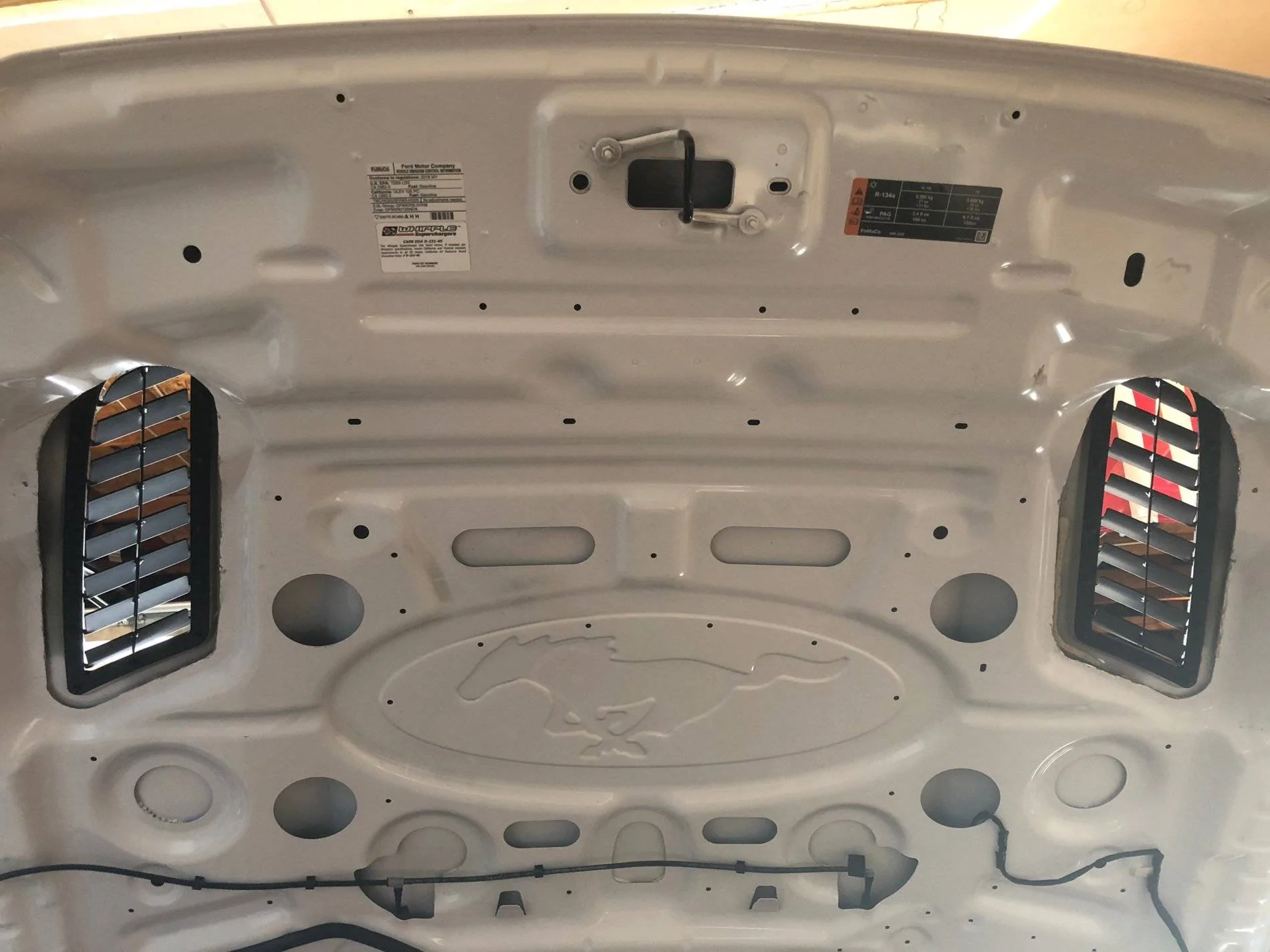

Now mounted
And then I added some door trim to finish off the underside which was my own doing.
I couldn't be happier with the way it turned out. If anyone chooses to do this, TAKE YOUR TIME. I had to remind myself this 20 thousand times. I did mine with the hood attached and if you want an excellent core workout, this is for you. I would say that it would be easier to take the hood off just so you don't have to contort yourself but not everyone wants to remove the hood. The cutting will make a mess so if you decide to do it with the hood on, use long sleeves, eye protection and cover the engine compartment with a sheet or whatever as tons of aluminum shavings will be everywhere.
If you have any questions don't hesitate to ask. I have plenty more pics if there is something specific you'd like to see or I can take any of the completed setup. These things are rigid and can't move at all. The amount of air and heat plus preventing lift will be extremely welcome and the looks of them couldn't be better. Thanks for looking.
