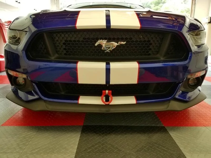

Sure enough, upon arriving at his place I was directed to a lift to install the hooks. We pulled the front fascia off in no time and he showed me where the mounting bracket would be located on the front bumper beam. The bracket is designed so that the threaded receiving end is lined up perfectly with the grill. The hook assembly passes right through with no modifications needed to the grill.
If you opt for the center mount or rear hook, make sure you have sharp drill bits of decent quality. It will require good pressure when drilling through the bumper brackets. A slower drill speed works better than faster. Since it was so easy to remove the front beam at that point, we did so in order for him to just use his drill press.

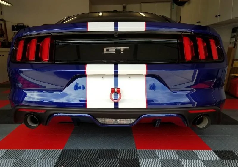

For the rear mount, it requires drilling through the underside of the rear bumper beam. To access that, we removed all the push pins and the two small nuts on each side that attach the rear valance to the bumper cover. You then need to firmly pull on the valance to unclip it from where it attaches at various points to the bumper cover. Gently using a screwdriver helps.
You can't completely remove the valance unless you want to go through the pain in the ass ordeal of unclipping it from the thin inside strip of the bumper cover at the center where it attaches around the rear back up light. With a helper, however, it's easy enough to just pull the valance back far enough at this point to access the underside of the bumper beam with a drill without having to completely remove the valance.
Once the rear bracket was installed, it required drilling a hole through the bumper cover directly behind where the rear license plate resides. Clipping the valance back together was not a big deal.

He has now listed the front, center mount option on his website. I wish I would have taken picks during the install, but things went so fast I didn't think about it. I took these pics at home after I picked up the rear hook.

I’m wanting to fit a center mount ZL1 tow hook on my GT PP 50th anniversary pack. I have requested and mailed ZL1 with a request for this dimension. So that I can see if any cutting is required in the bottom grille, which is specific to the anniversary trim (Not wanting to do this)
Does anyone have one to hand or could offer any information on this dimension.?

To OP
I know this is an old thread. Can you post pictures of rear install?
Can you offset the mount to one side of the license plate?

Hello. I'm sorry, but as I stated in the thread I didn't have time to take any pictures during the install. I would not recommend offsetting the hook to one side of the rear plate since the bumper bar is curved and not straight. The hook would protrude out at an angle.
