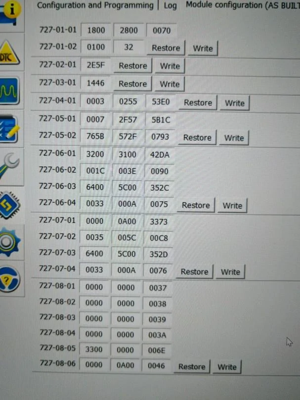

2016 mustang gt PP
zach maybe you can help me out or know someone that can help me out with an issue im having with my sync 3 upgrade, i have everything working but when i program my base acm so i can make phone calls, the radio volume is lower then if i left the acm with the original values. im assuming its changing the output levels for the acm for a premium acm with amp. any advice as to maybe a as built value that wouldnt affect the output levels
zackmd1
Oct 1, 2013
140
5,263
3,363
Maryland
Zack
1970 Mustang, 1965 AC Cobra, 2023 Ford Bronco 2Dr
The premium ACM audio output goes to an amplifier where the base ACM does not. So basically programming a base ACM to that of a premium converts the audio output but does not add the amplifier which is why the volume is now lower. I will try to get a picture of my ACM values so you can get calls while retaining volume.

My ACM as built data.

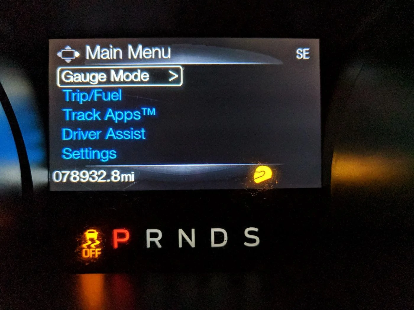

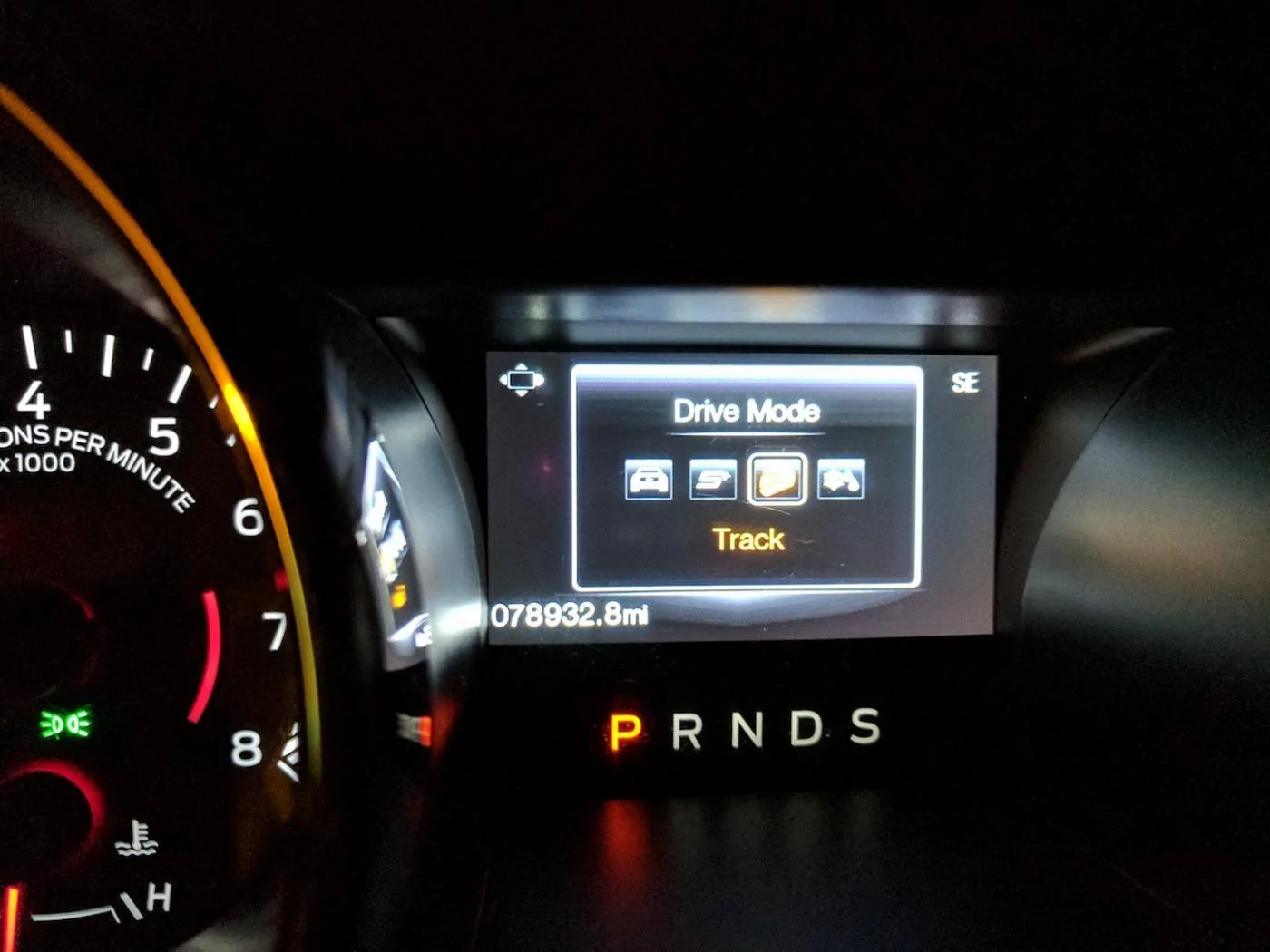

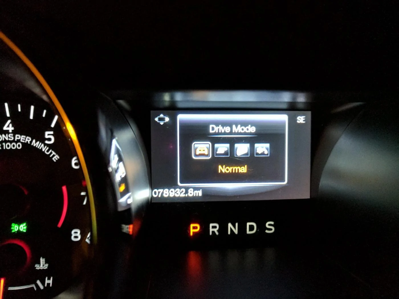

So guys...... I think I just enabled Drive Modes on the V6!!!!! :D:D:D:D:headbang::headbang::headbang::hail::hail::hail:
Following the AB data in the OP produced a compatibility error in both the IPC and ABS on my vehicle. I proceeded to go through an AB data dump of a 2015 EB premium looking for the data lines in the OP. This is what I found and what "seems" to have worked on my vehicle. I would imagine this data would work for any 2015 V6 or EB with the premium radio bezel installed.
IPC
720-06-01: 6C7F - 8000 - 18B1
ABS
760-02-02: 0200 - 117E
