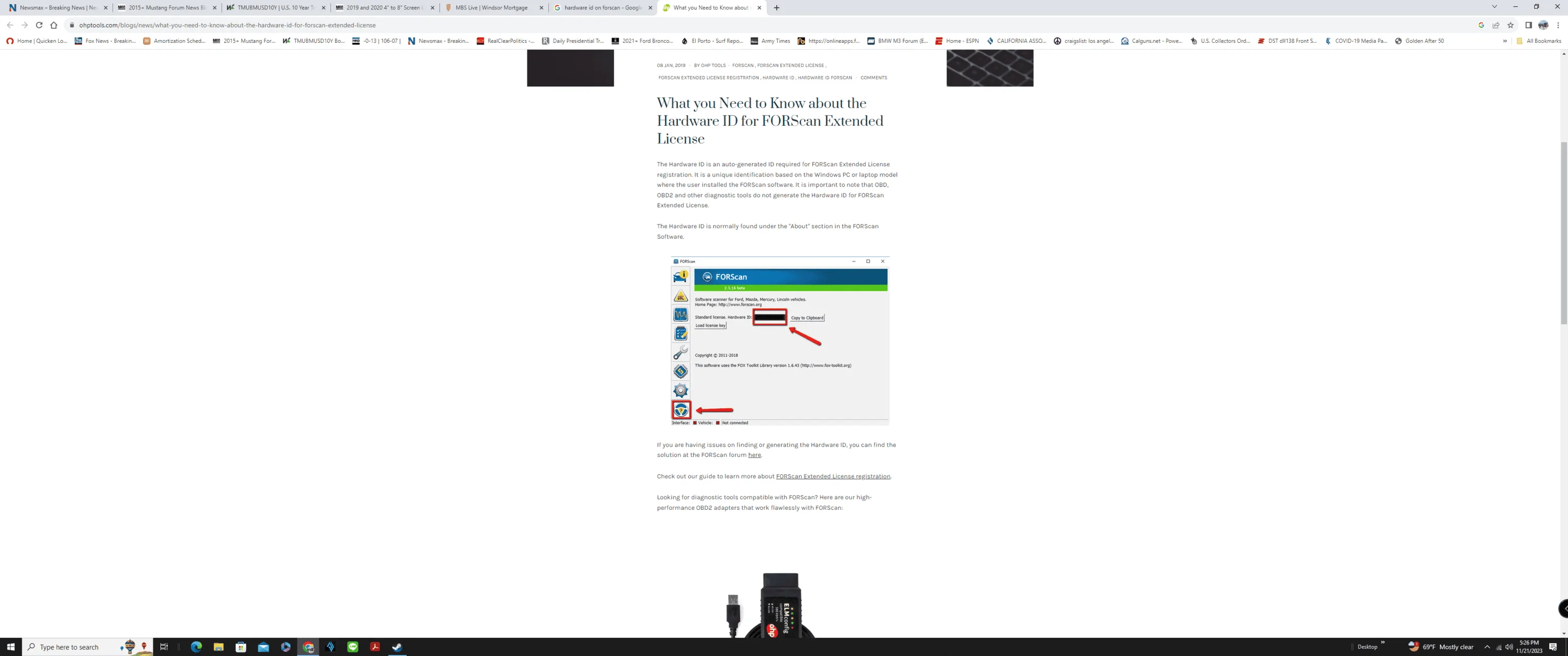

Hello again. Can anyone tell me how to get my Hardware ID on FORScan? I am trying to sign up for the Free 2-month trial but cannot for the life of me find the Hardware ID? Tia
You need to go to the "About" section. Its been awhile since I used it.

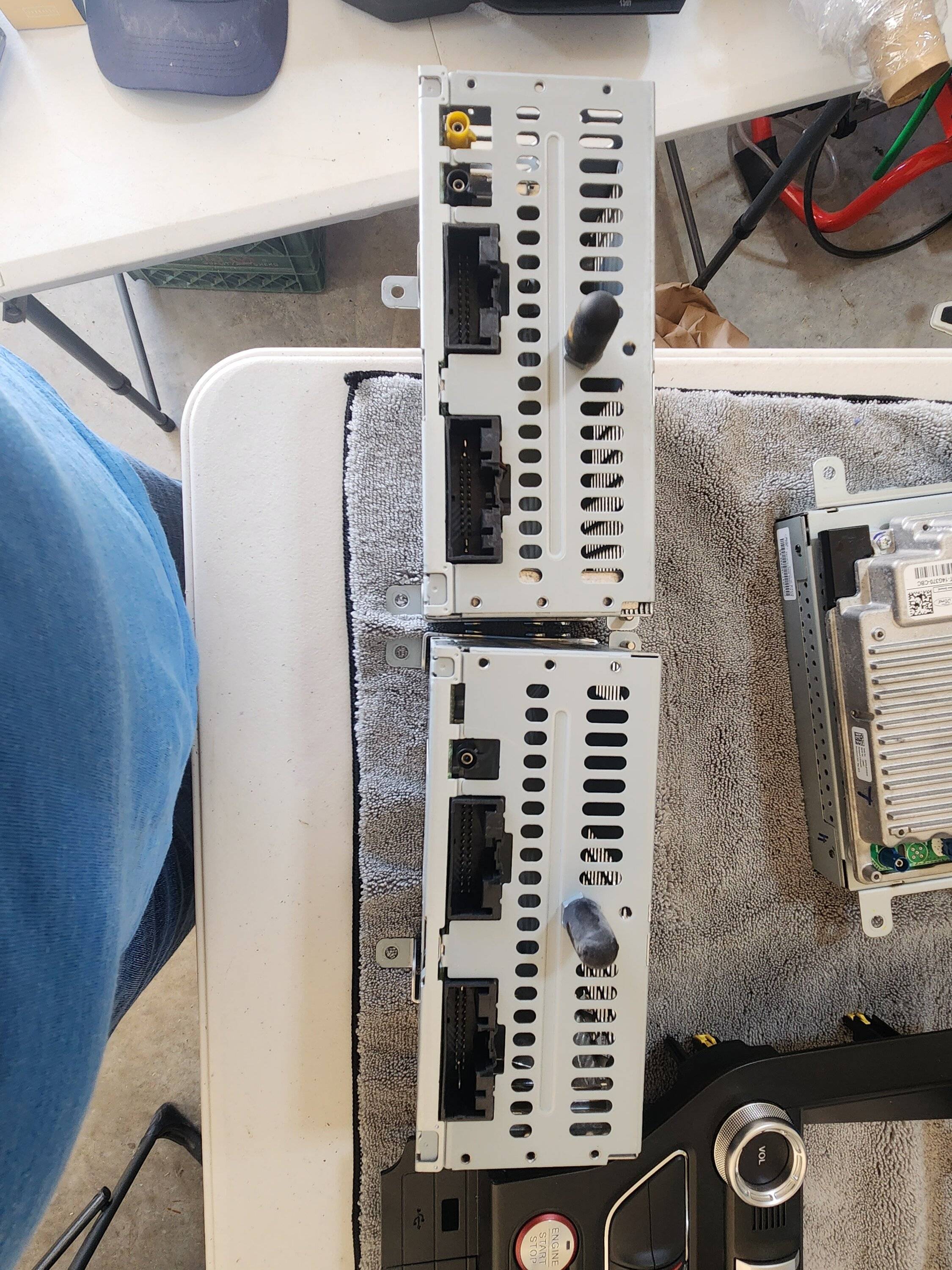

Just curious if you already had a CD player before? Just bought the 8 screen, APIM, Bezel and ACM with a CD player. Because of the new set up having a CD player I have to swap the ACM. Did you have any problems? Tia
