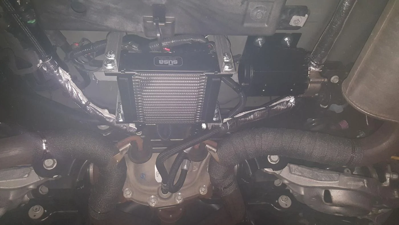

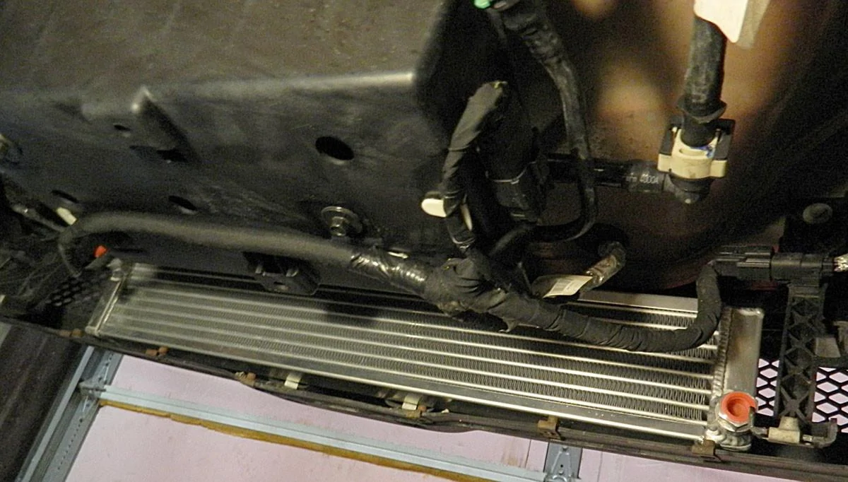

I have compiled aftermarket and custom components to install the differential cooler, while I wait to see what the market will offer for the transmission. Since the differential is less critical and less involved, I figured that I would start with the back end and be able to apply some lessons learned when I get to the transmission cooler. I am wiring the systems so I can turn them on and off from the cockpit, I expect to use them primarily at the track.

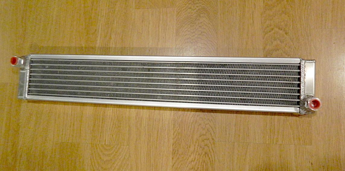

I started with a custom radiator from Fluidyne, this was made to my specifications and has about 40% more capacity than the factory cooler.

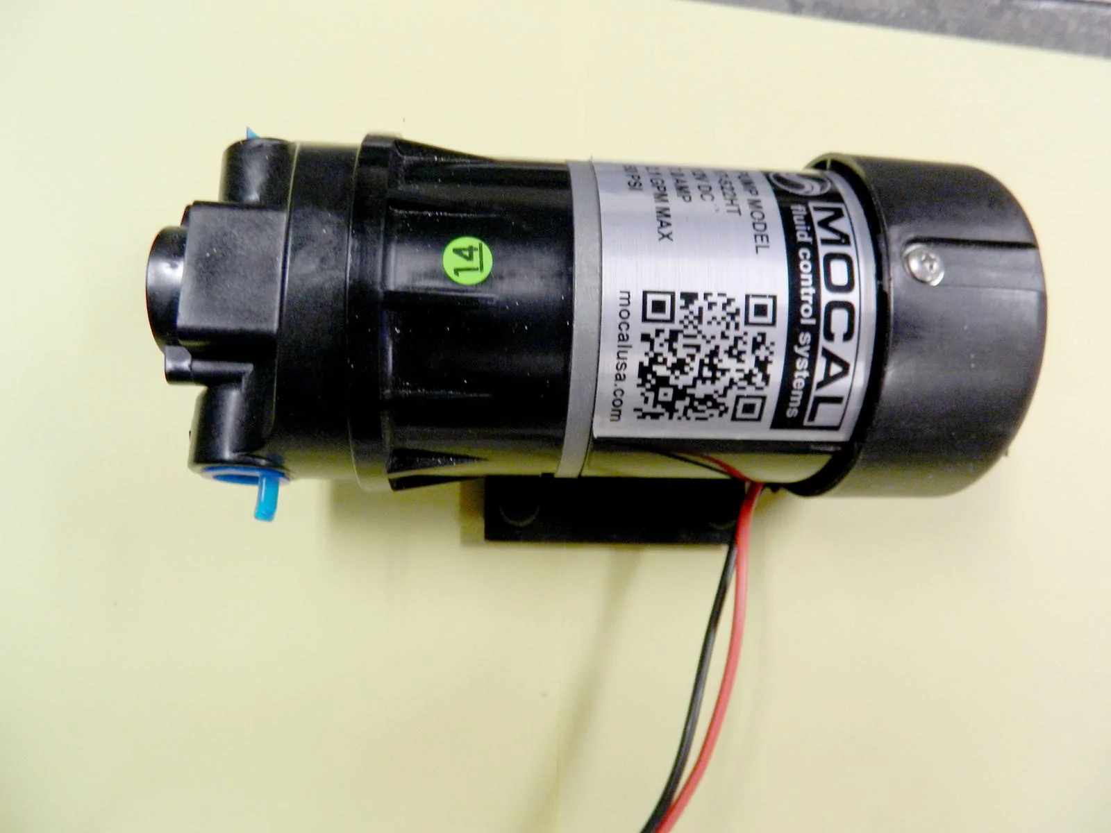

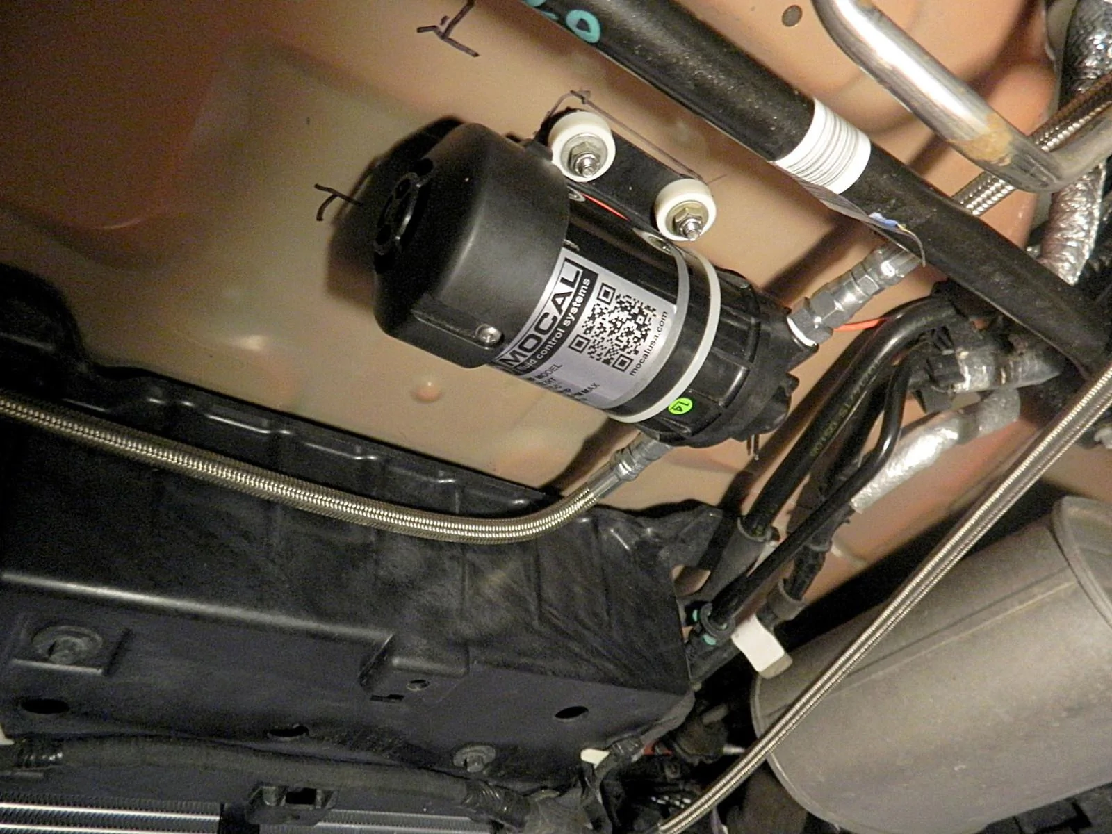

I am starting with the Mocal 2 GPM pump to see how I like it.
The pump will be controlled by a relay I will mount inside the housing under the spare tire space.

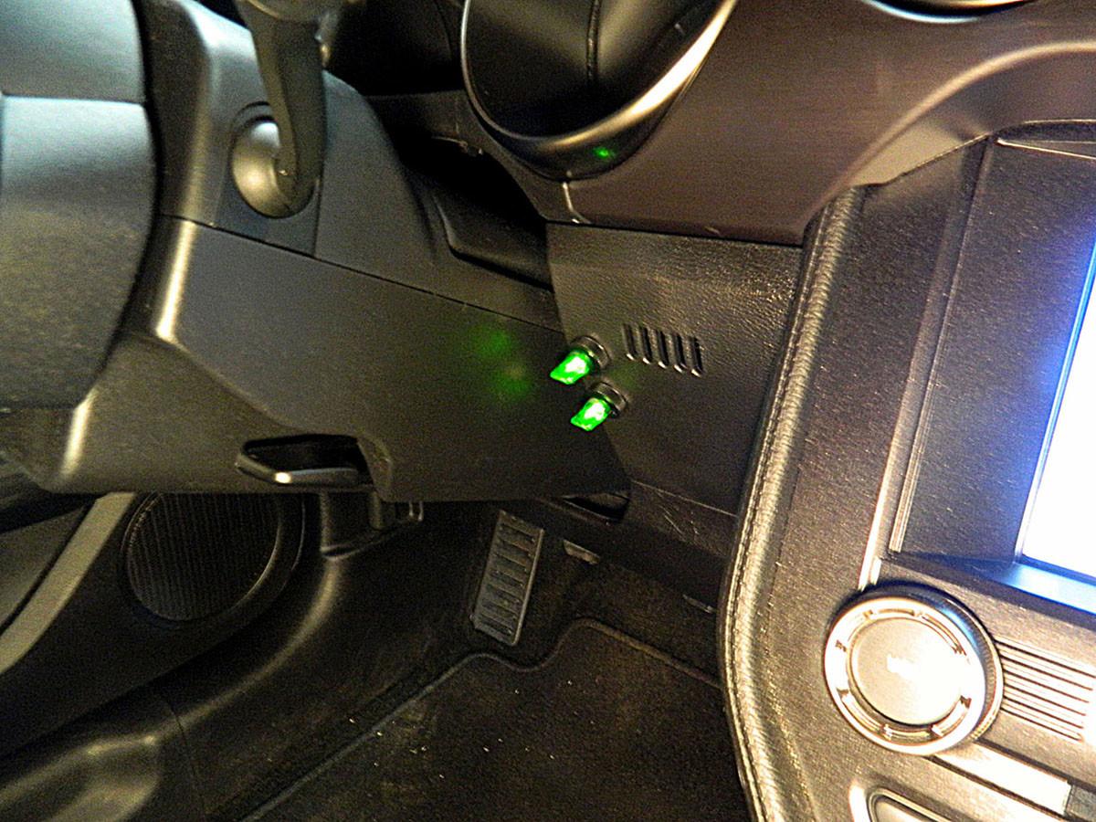

I mounted switches in the cockpit for the 2 pumps, top for the transmission, lower switch for the differential.

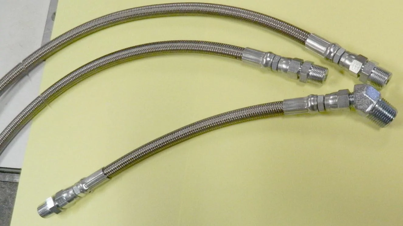

Had a local hydraulics service shop make the hoses.

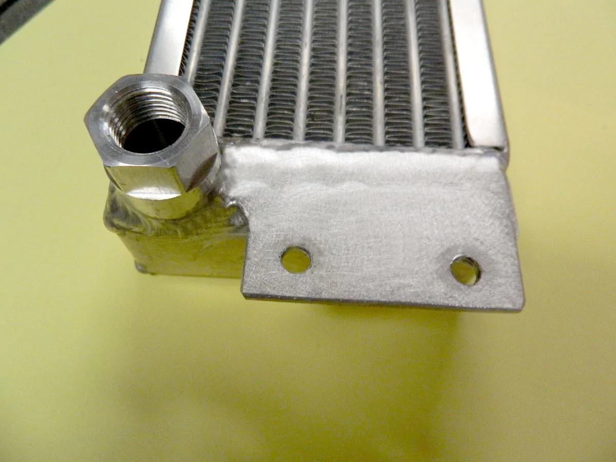

I welded mounting tabs on the radiator hosing.
I made a center support for the radiator, this mounts to the steel flange for the plastic housing.
Mounted the pump under the spare tire compartment. The hoses connect to the fill and drain holes in the differential. An inline filter will be added before the pump inlet.
Here is the system mounted in place
Cost of the system:
Radiator $405
Hoses and connectors $115
Pump $165
Relay and switches $12
Wire $10
Brackets , about 3 hours fabricating.

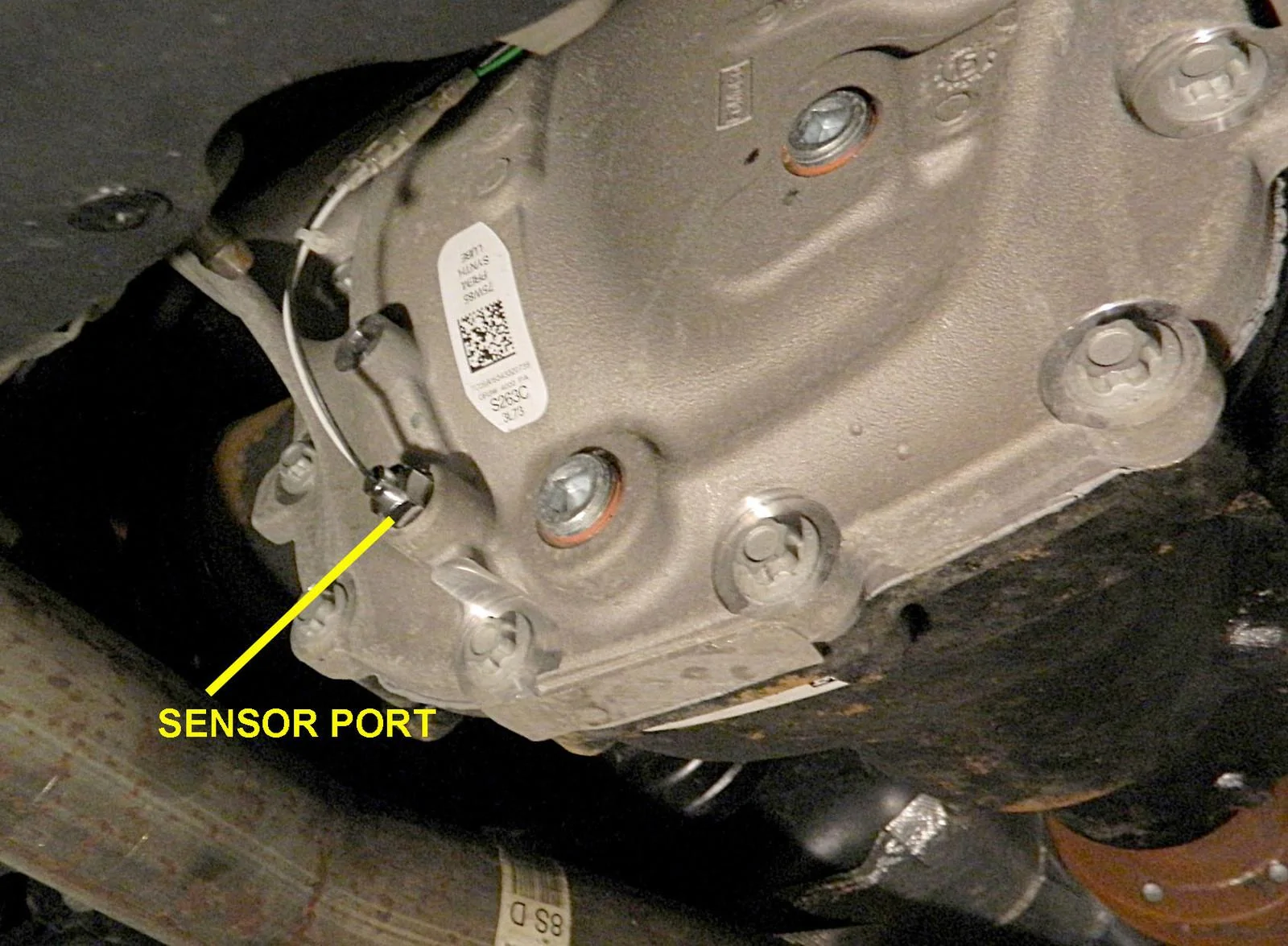

What temps have you seen without the cooler for the differential? (IR measured or thermocouples).
I have a differential temperature sensor mounted in the factory hole with a Glowshift gauge in the cockpit. The highest I have seen the differential get in hot weather is about 210F. I am looking to keep that under 180 under any circumstances.

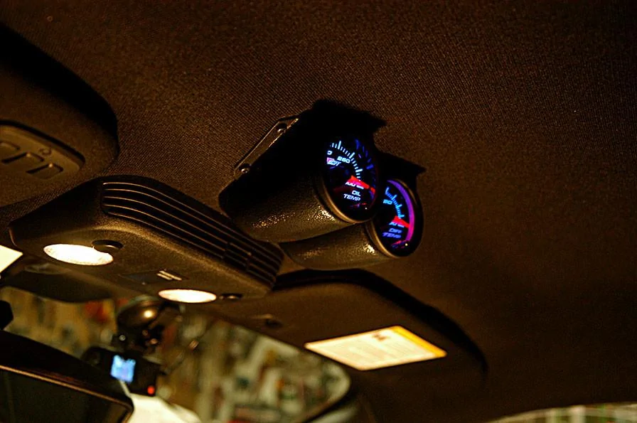

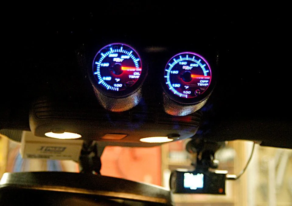

Hi GT Dave,
Can you post a pic of the Glowshift light in the cockpit? Did you run the sensor from the fill hole?

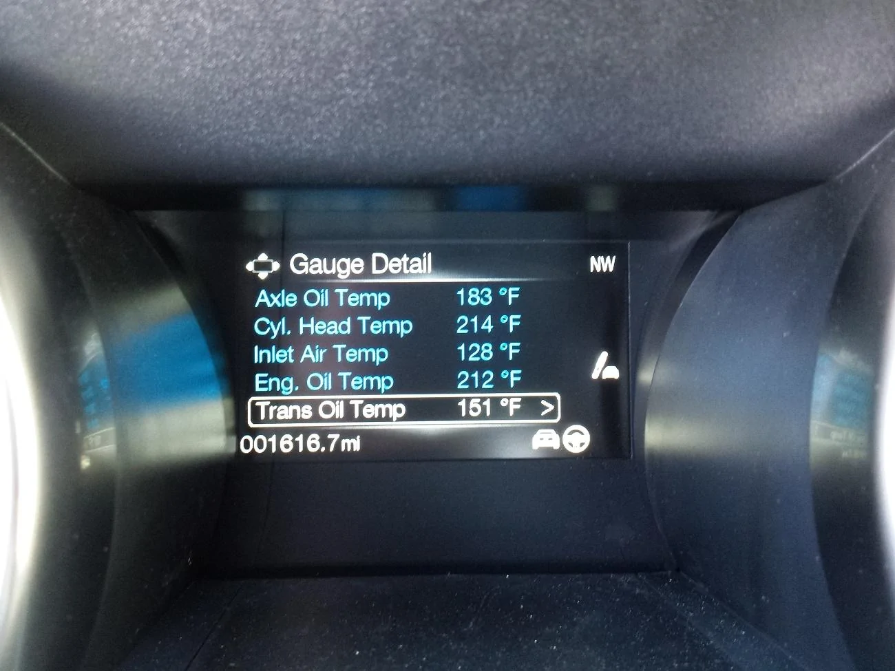

Here is how I mounted gauges in the headliner as an upper center console of sorts. At the time, 2 years ago, this was before we knew about the Forscan capabilities. If done today I would most likely do it different and just use the dash display. But it is nice having these gauges as a backup at the track.
The sensor uses the factory sensor port in the stock cover.

Wow, your setup is impressive. I had the idea of installing the AutoMeter Indiglo or something like that. Based on the pic, and the Forscan tweaks, I am now under the assumption that the factory sensors are installed for both differential and tranny? All we need to do is turn on with the Forscan tweak? If so, that’s easier than the OEM kit and the time involved to install it. Thanks
