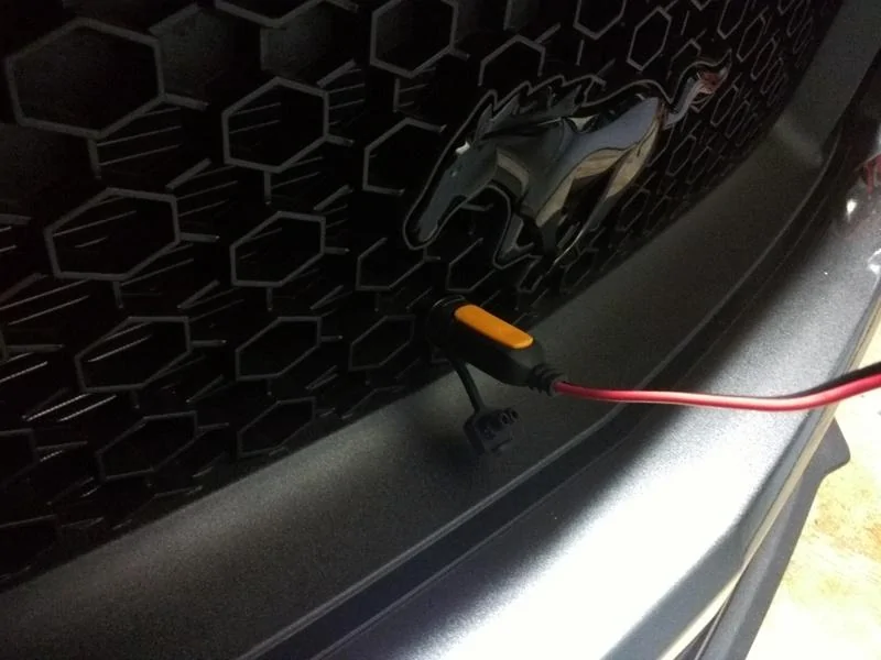

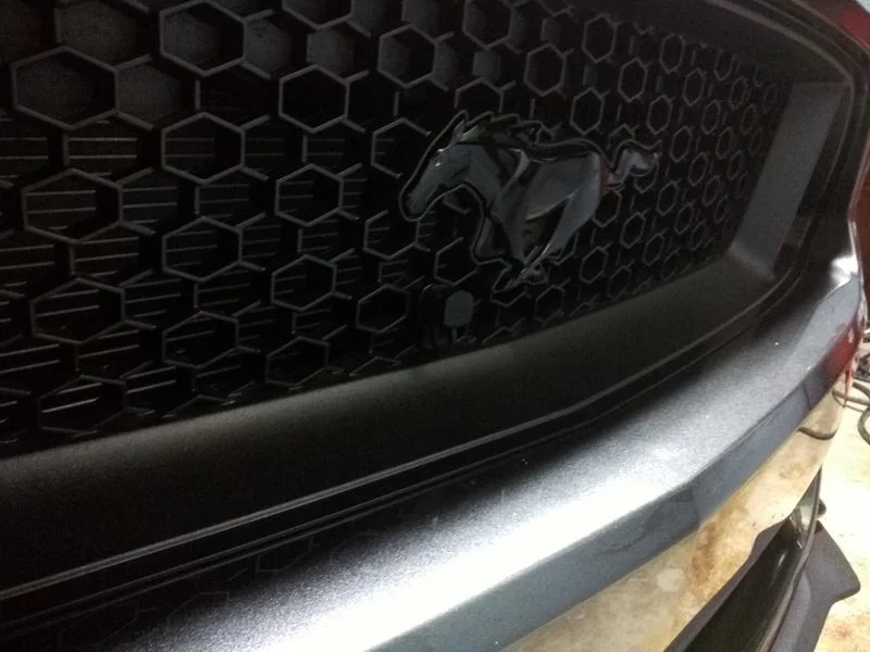

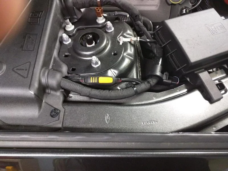

I tried it, the lighter ports on the GT350 are always hot so a charger will work with the car off.
As far as Battery Tender vs CTEK. I have had BT's for 12+ years. Never one problem. I also have a CTEK 3300. Both extension cables are expensive. The BT has much longer cords. You need more shorter cables if you want to use the CTEK.
The CTEK tends to get pretty warm, Not sure if that is normal or not, It also seems to have some QC issues. The case seems flimsy. It does work fine and it does do desulfination (sp?). Not sure that matters unless you run your battery dead often.
On my 16, I hardwired my CTEK to the battery and used an extension to run the cable through the grille. On my 17 GT350, The connector is routed under the spoiler so it's very cover friendly and no need to keep your window cracked or your hood up. Below are he pics from my 16. My 17 is wired the same except the connector is under the splitter.
