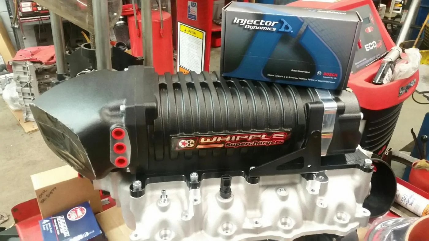

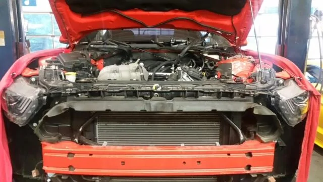

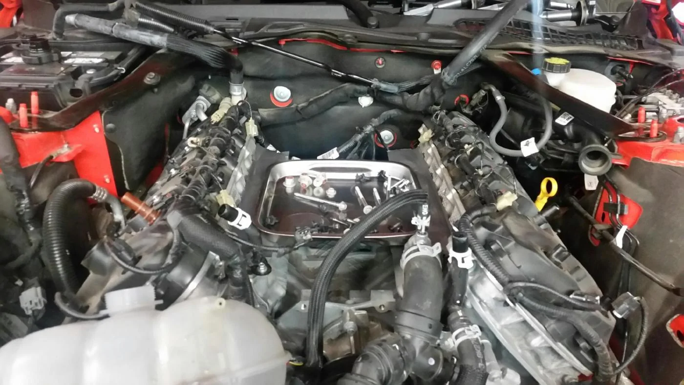

Tom dropped off his S550 for just a couple things
our partners at Finish Line got to work right away this monting on...
Whipple Install
Fore e85 Fuel system
ID1300s
TSS Oil Pump Gears
MMR Crank Sprocket
Reische Thermostat
Few little Drivetrain upgrades!!!
Mcleod RXT
Mcleod Billet Flywheel
Barton Shifter
And topping it all off with a lund remote on our Chassis Dyno
like i said, just a couple things!!!!!

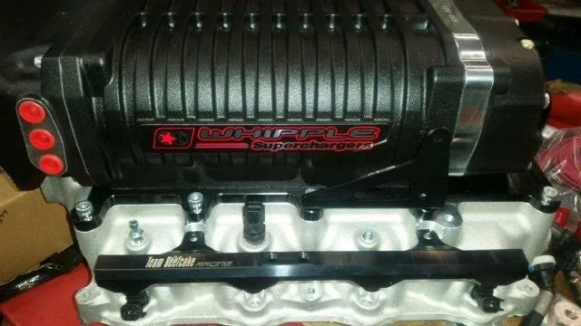

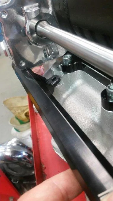

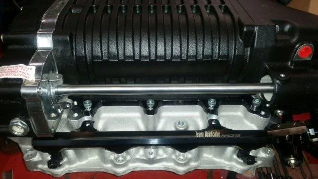

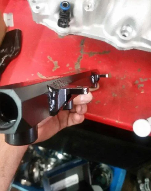

tom is wanting big power down the road, so he went with our custom level 3 fore setup. the whipple comes with -6 rails, but with wanting all he can get, we went with the fore -8 rails.
the trick with this setup is the fore rails are too tall and hit the jack shaft
no worries, a little measuring, fabrication, and knocking out the spacers, and voila! perfect rail height!

Only thing I disliked about the Whipple so far is having to remove the head unit to get to the passenger fuel rail.
