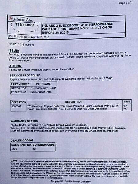

Hi all,
Sorry if this is a repost, but if anybody needs it, here is the TSB concerning the brake noise on slow, sharp turns; just print it and bring it to your Ford dealer - new front rotors and pads, covered under warranty :)

If my car is eligible I might just wait a few thousand miles to redeem this TSB. :)
Yeah, if they actually didn't change the manufacturing of the items and no diff, at least I rolled back the front brake ODO by 10.5k miles ;)

I've had a lot of Brembo's on cars in my history and they all Squeak... its kinda the thing about them. This is kinda something you just get with Brembo's.

It's not just a "squeak" it's a loud piercing noise. Definitely not normal.

I have the brembos and the squeal, but I also have the grinding noise that happens only on rare occasions. I have not been able to duplicate it either.

And this TSB is not for the Brembos, its the 4 piston ones :)

Yeah i was just going to say...dont we have the 6 pistons!? Was not about to go in for a downgrade!

I'm going in Friday for my GT with the PP, I bought it on labor day and the brakes have been dragging ever since. They're going to fix them, not sure if it's related to this or not.
