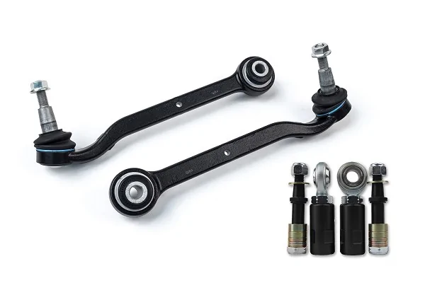

By lowering your S550 Mustang, you have consequently lowered the front roll center and introduced more pronounced bumpsteer. This leads to symptoms you have likely experienced: reduced steering response, increased body roll, and reduced cornering grip.
With an increased ball stud height, Steeda's Lateral Link (555 4906) has eliminated the adverse effects of lowering your vehicle by raising the front roll center. This, in turn, helps to increase steering response, decrease body roll, and increase cornering grip, helping you turn even better lap times! Coupled with our S550 Bumpsteer Kit (555 8133), your front suspension geometry will remain intact, with a significant reduction in bumpsteer.
These are a must for any S550 Mustang owner looking a bolt-on suspension upgrade to increase handling performance.
Product Benefits:
Corrects the front roll center on vehicles lowered 0.5" or more
Reduces bumpsteer
Increases steering wheel responsiveness
Decreases body roll
Improves tire contact patch with the road
Increased cornering grip
Sold as pair

Aren't these the factory Shelby links?
No. The GT350 has a different seat angle (ask me how I found out). The description of these should be corrected as they won't fit properly in the GT350 knuckle because of that.

Like [MENTION=10281]BmacIL[/MENTION] said, the knuckle on the Shelby GT350 is different and the lateral links nor the bumpsteer kit fit.

But, the GT350 links already have extended studs like these.

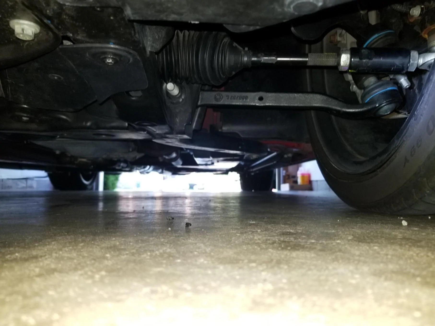

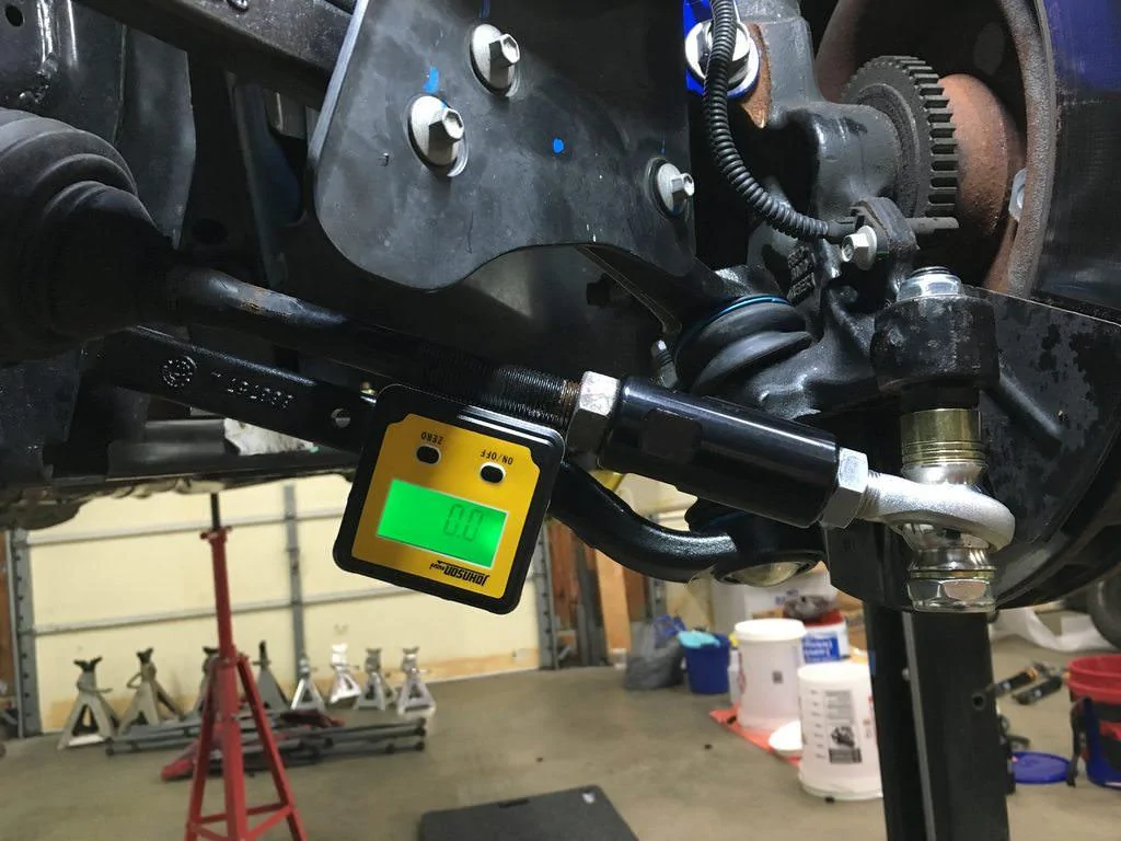

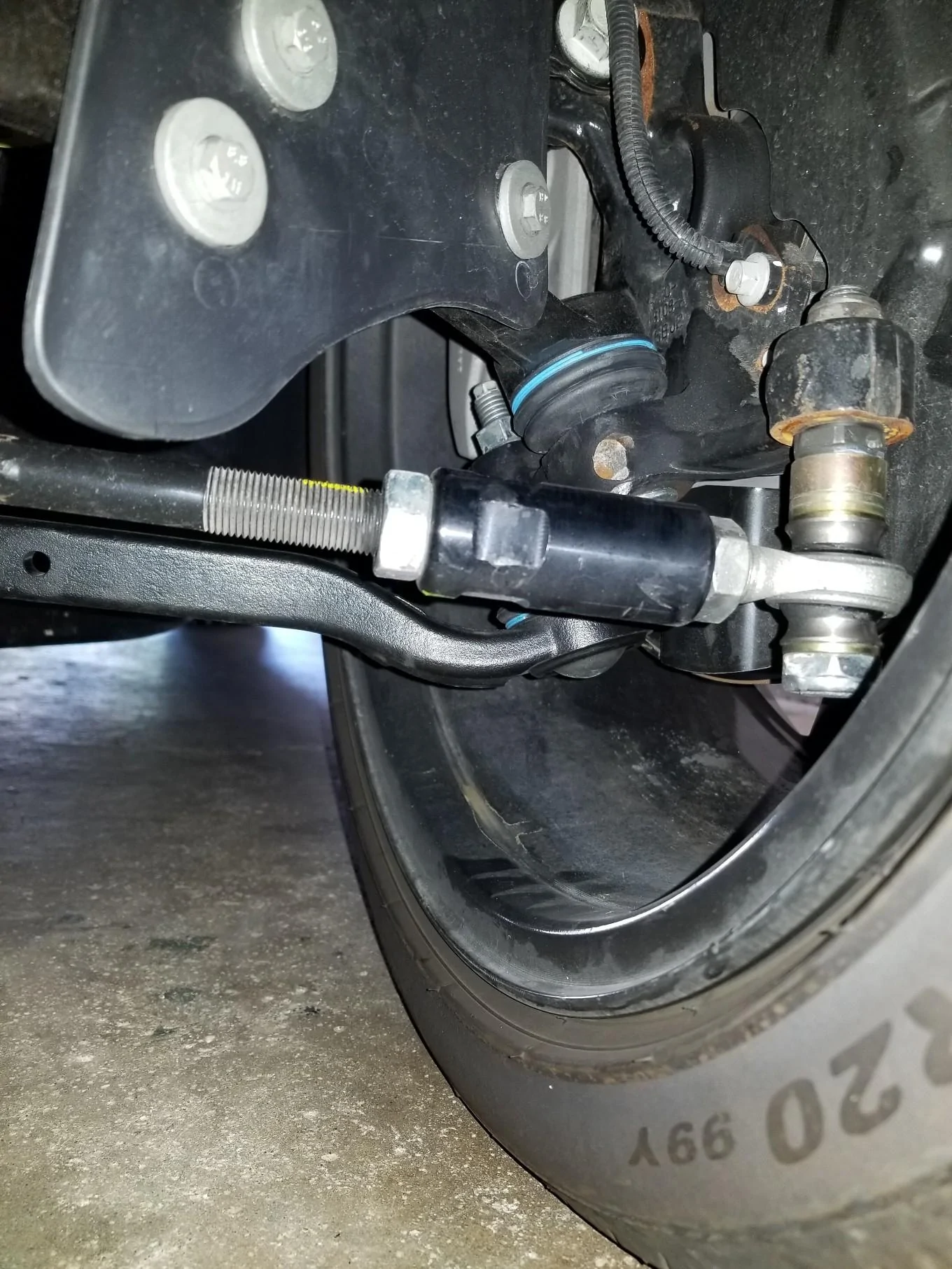

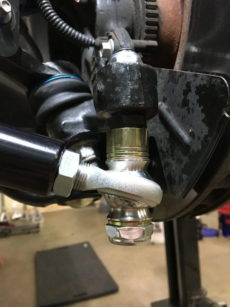

Some pics of steeda's bumpsteer kit showing correct installation / reference angle to lateral links / bushing stack.
All installed @steeda.ca!

I'm most certain someone will correct me if I'm wrong here, but I would not install this kit on a stock ride height car. The intention of the kit is to 'correct' the geometry issues you cause when lowering the car. Not lowered? You have not negatively impacted the geometry (roll center & tie rod angle) this kit is intended to correct. You will do more harm than good if you install on a car that has not been lowered.

regarding the roll center correcting arms. can anyone explain why its a one size fits all? i mean if you are lowered 0.5 in v 1.5 inch wouldnt you need a differing length of ball joint extension?

Its probably not one size, but close enough is good enough since the suspension is designed to work in a range anyway.
You’re shifting the sweet spot. Lowering springs are usually 0.75”-1.2” lower or so, and if you only lowered the car 0.5” you really wouldn’t need to move the sweet spot anyway.
