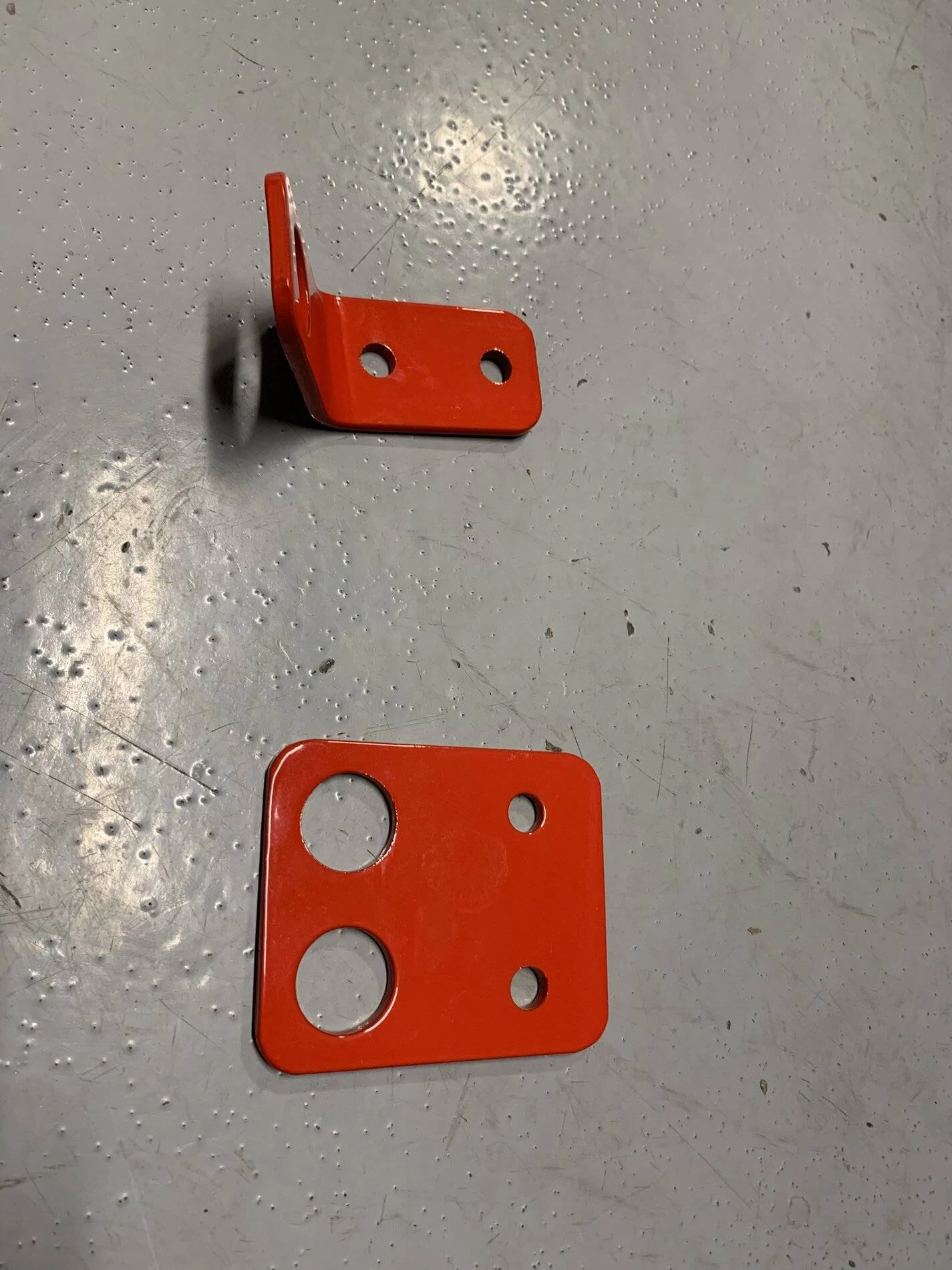

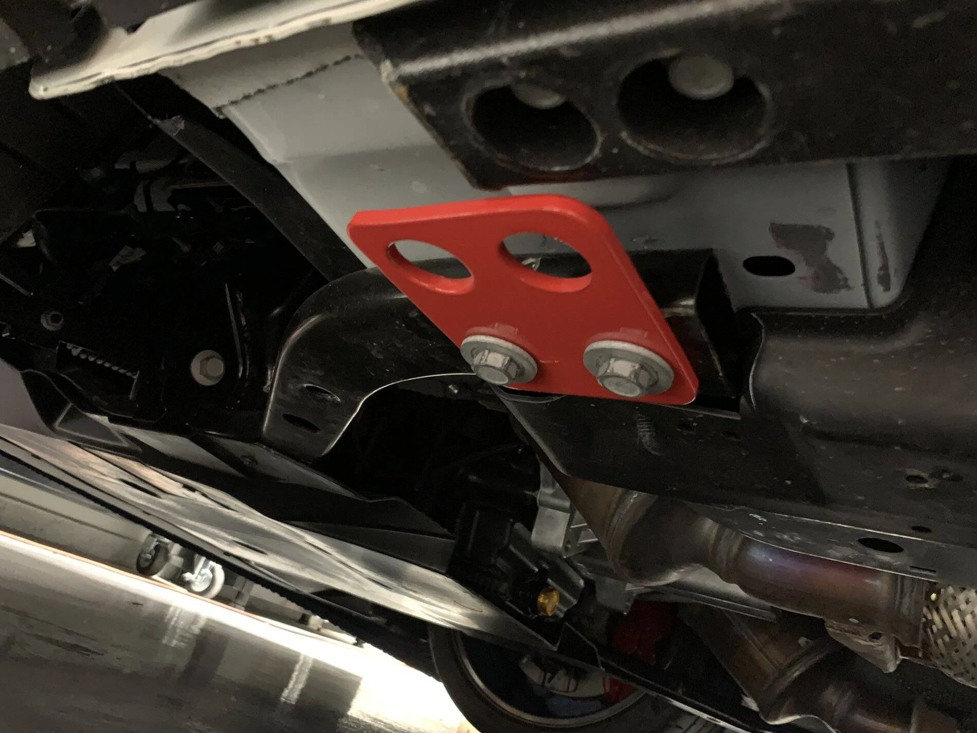

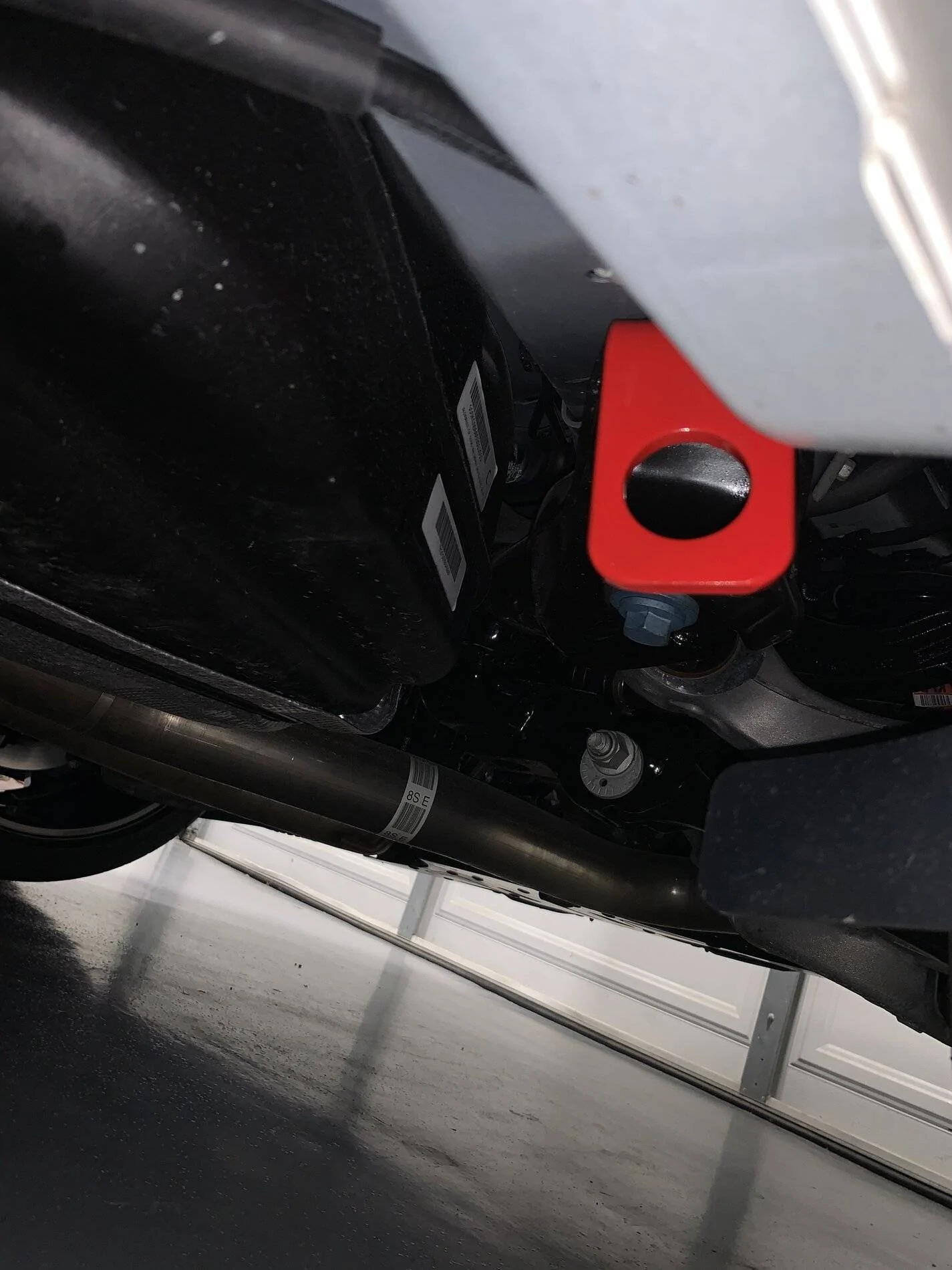

The Ford performance tie down kit might be an option.
So I did install the tie down strap attachment points from ZL1 products under the car. The front ones have two attach points coming off the k member. Then two points in rear. My plan would be to potentially get a strap made in the shape of a Y. 36 inches for each part of the top of the Y with some J hooks. The base or bottom of the Y would be about 4 feet to give me 1 foot of extra strap in the front of the car to attach to the winch. Other points would be use to secure the car down.
