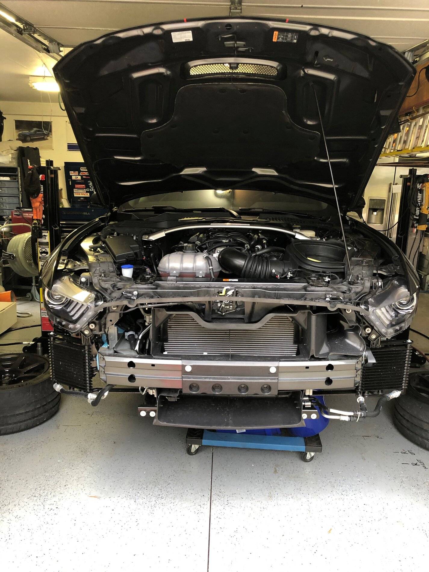

Agree with other installation notes and suggestions, particularly that this was a fairly massive PIA. I found that removing the push pins in both front fender liners (wheels removed of course) allowed for better access to the dreaded fender bolt. Used the dewalt right angle attachment to both remove and reinstall. I went with keeping the belly pan attached to the front bumper cover and r & i both as a unit. This also required removing the push pins holding the brake ducts to the fender liners as well so they stayed attached to the bumper cover. Thus, is really a two person operation in reinstalling the cover as the ducts need to align and clear the cooling lines and cross members correctly.
The other major issue that I had was that the tow hook receiver did not extend far enough forward into the grill to allow for the tow hook to then screw in far enough to have sufficient gripping power. Thus, had to remove everything and add in several stainless washers as spacers. This pushed the receiver more towards the honeycomb grill so that the hook could screw in enough to hold securely. Blue thread lock also used. Here's hoping will never have to find out if an actual tow hook retrieval will be successful.
If had to do again, may try and find a body shop to tackle this, although I feel the end result is most likely superior. Again, cannot understand why Ford didn't install these from the get go. I had recently corresponded with Ford Performance via chat and asked them why was not installed - their response was only that this was a common question they received and would take to engineering, or something along those lines.

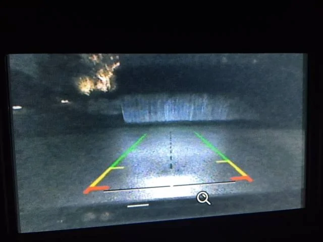

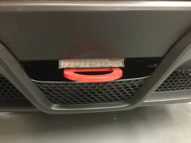

Here’s a pix with the rear hook & light installed. Used double sided tape to stick to the tow hook, and wired into the harness. Works great!

Somewhere on this site is a pix of a guy who took off the front bumper cover on a ‘20 GT350 and discovered the same nut welded to the front bumper we GT500 owners have. I doubt its on the ‘19 GT350’s though due to timing.
I had the same issue with mine with the receiver not being long enough to make it through the grill. I ended up going to home depot and buying a much longer bolt as well as a bunch of washers in order for the receiver to be close enough to the grill for the hook to screw into.

Probably too late for you, but I pulled my front bumper off for the ZL1 towhook before I installed the splitter. It was such a breeze. Installing the splitter was not a breeze though. It might be easier to remove the bumper cover, belly pan, and splitter as a single unit than to remove the splitter and belly pan.
