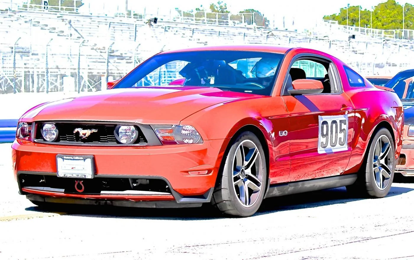

Blowfish Racing makes a nice kit for the S197 cars that was easy to install with no cutting of the bumper. They're working on a kit for the S550 that should be ready before the 2016 track season.
https://www.blowfishracing.com/towi...-front-tow-hook-kit-with-splitter-mounts.html
The grill has to be cut a little bit on 13&14's on the front and a slot has to be cut in the rear (under the license plate). I installed both on my 13/Boss...it was easier to do than I thought! Planning on getting them for my GT350...if it ever gets here! Ordered 6/4.

Yep. I'm not planning on installing one on the rear this time around. I had the cooltech's on my GT but like the simple install of the Blowfish better. They make nice quality products. Hopefully they have an updated fire extinguisher mount out soon as well.
