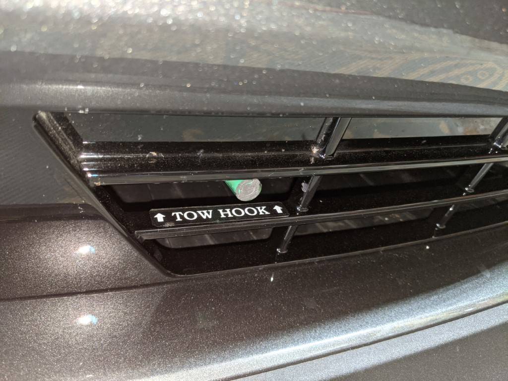

I was waiting for something like this. Makes me wonder now if I need to take it all apart and redo it. The only thing is, if I do, the mounting bracket will be even closer to the grill, and it's almost touching it right now. *Insert string of random cuss words here*. Really makes me wonder if I did it right or wrong now. *Insert second string of random cuss words here*
The Feather Lite version instructions didn't mention this. Even the poor pic that comes with the instructions shows it just going over the bolts once the nuts have been pulled. Mine has some counter sunk slots on the side of the bracket that touches the bumper and goes over the two washers/spacers that were under the nuts.

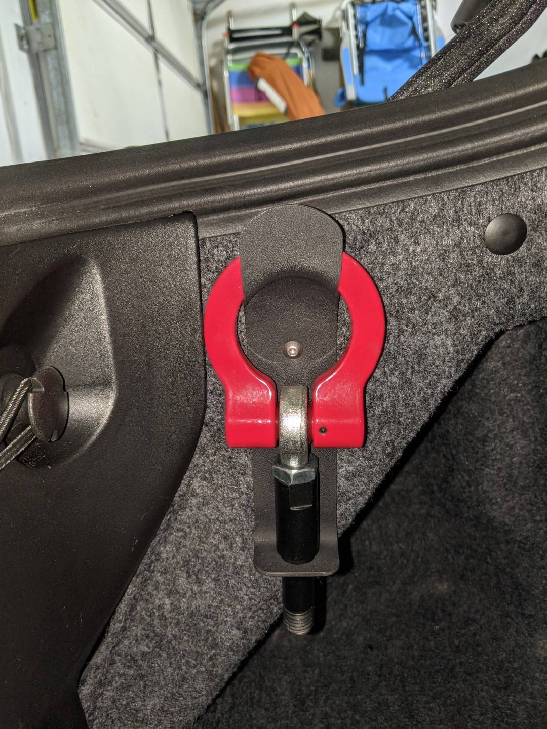

I am thinking about grabbing one, in black, but dont want to look corny being on my car that isn't tracked Lol but if I need a tow.. well, ya know. so mainly aesthetic reasoning, with some functionality that I will prob never need.
I keep my hook in the trunk until needed.
Ooohhh I like that. Details on the mounting bracket please. That is very slick.
Mine has the same counter sunk slots. When I get back up under there I'll try and get a better picture of what it looks like.

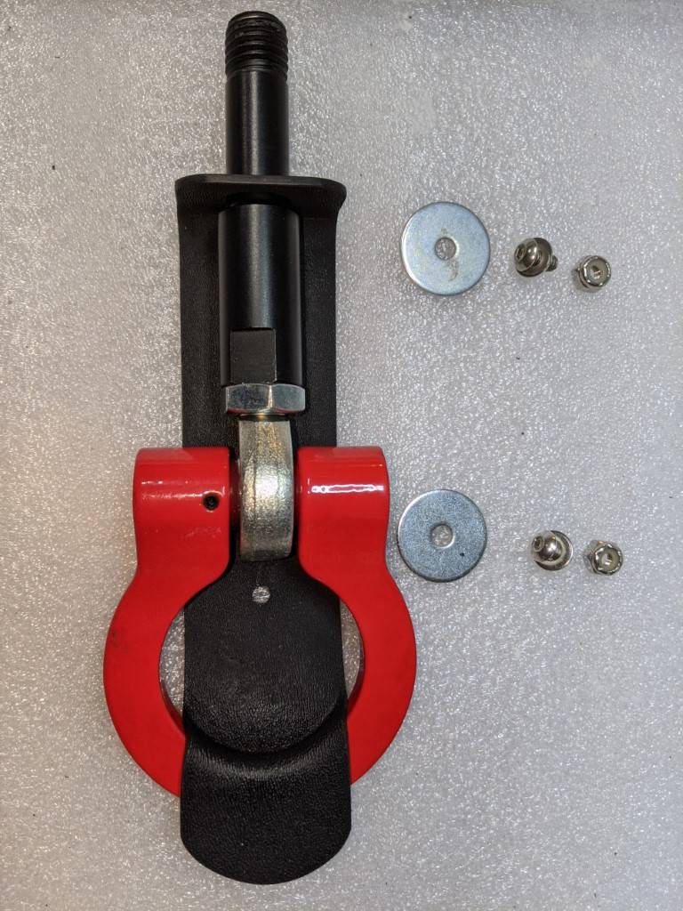

I made it out of .093 Kydex cut to 7.5 x 1.5 inches. Then I used a heat gun to soften it and formed it to the hook.
