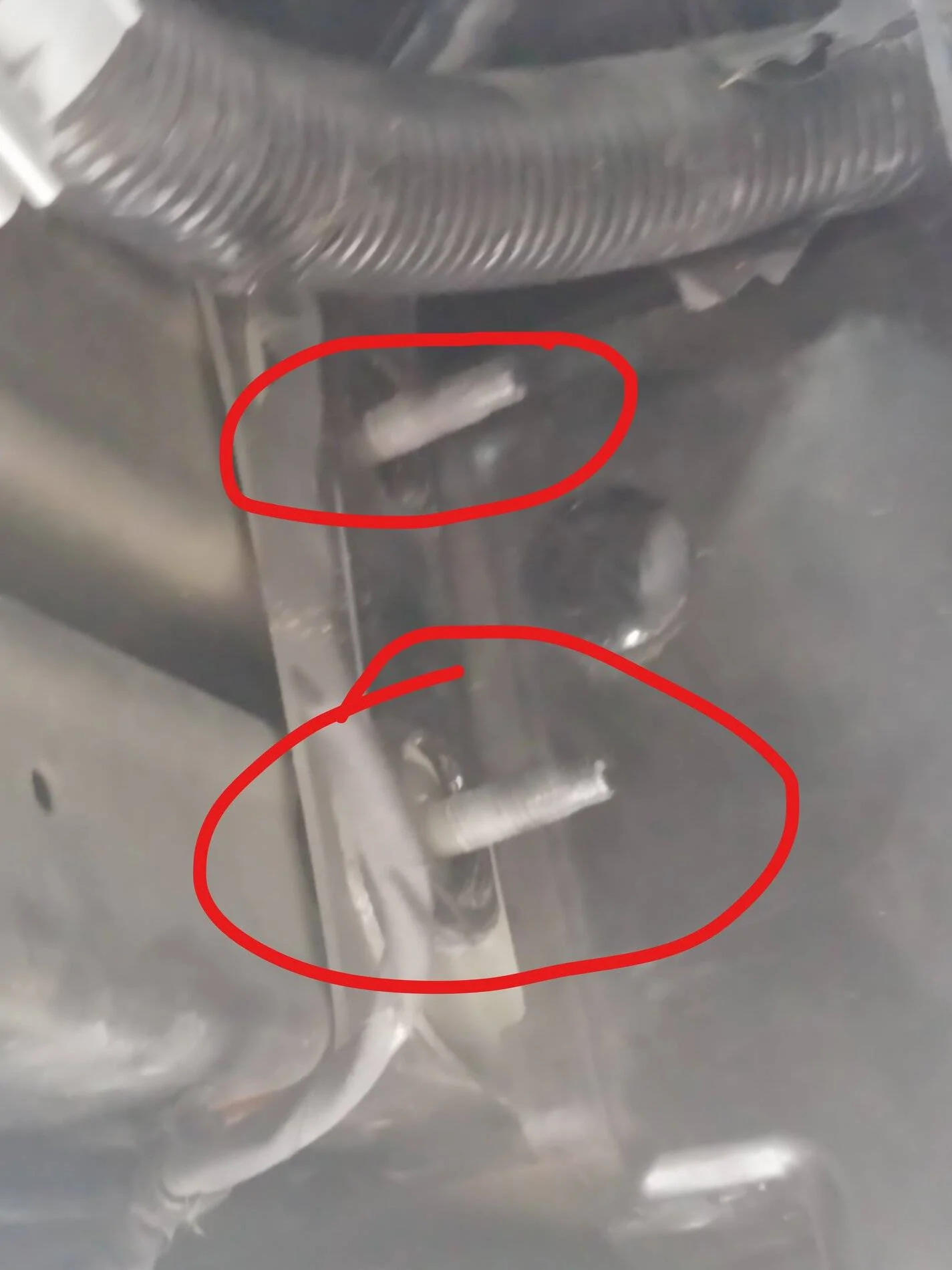

3. Once that is off, it's pretty straight forward. You have to remove the two 13mm nuts

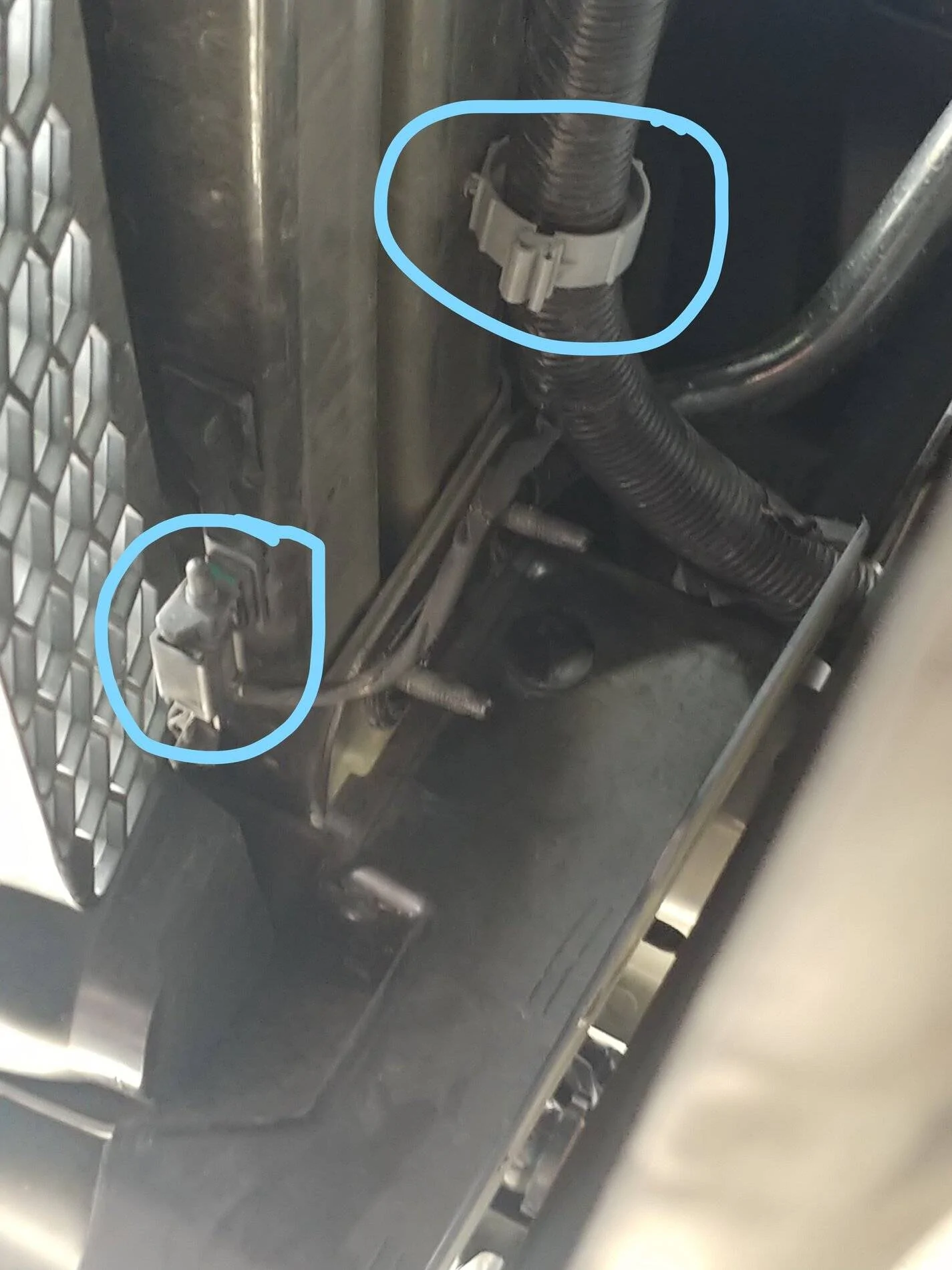

3. You also need to unplug this plug and move this wire bundle. Edit: **The radiator support bracket needs to come off of the bolts, then the tow hook bracket, then the radiator bracket goes back on, and then bolt it all down. Don't just slip it over the bolts, like someone, who shall remain nameless did**
4. slip the mounting bracket over the two bolts and re-install the nuts. loosely, so make sure everything lines up on the front side.

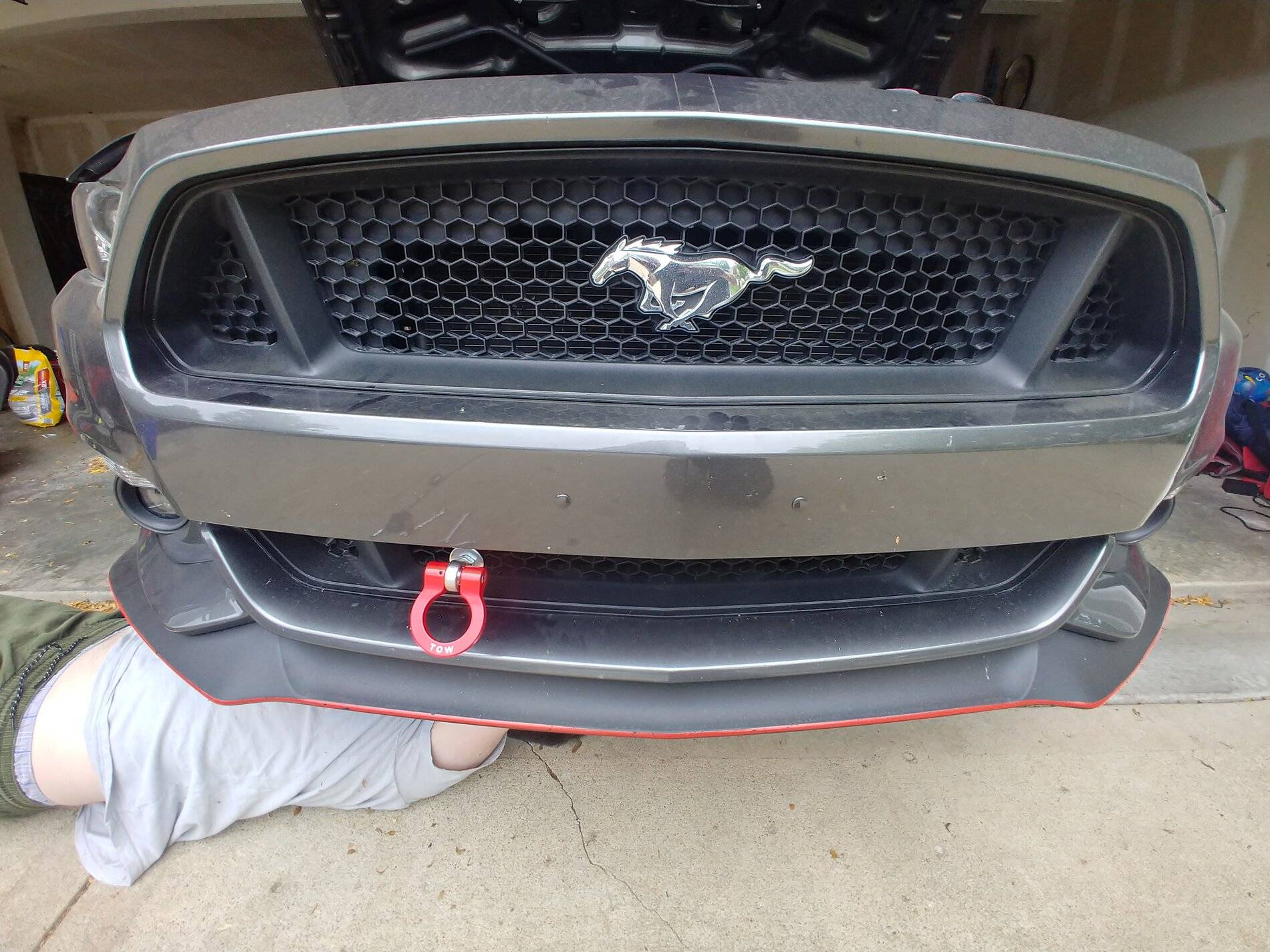

5. Once you have the post for the hook started, tighten everything up. I did not have to trim any of the grill. YMMM.
6. Re-stall the belly pan, and tighten up the hook and post, and you're good to go.
My younger son helping out.
I plan on removing the post, moving it to the lower of the two mounting holes shown in picture 3, so i can get the camera mount on and adding a little dab of blue Loc-tite to everything.

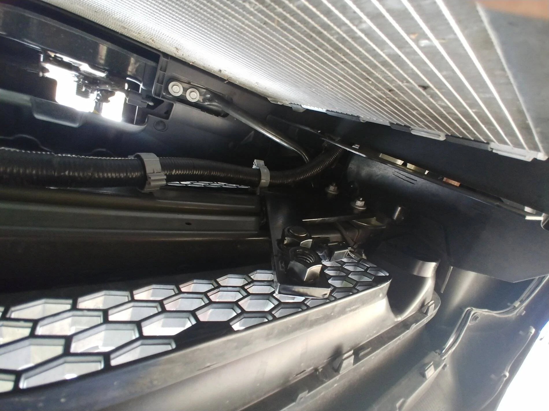

The reason I removed the bumper is because the online video said to pull the radiator bracket off the two studs and the insert the tow plate over the studs and against the crash bar. The radiator bracket then goes back over the studs and against the tow plate. It was a pain to do that with the bumper on.
I was waiting for something like this. Makes me wonder now if I need to take it all apart and redo it. The only thing is, if I do, the mounting bracket will be even closer to the grill, and it's almost touching it right now. *Insert string of random cuss words here*. Really makes me wonder if I did it right or wrong now. *Insert second string of random cuss words here*

Maybe that being on top of the bracket it isn't flush and is angled toward the grill?
