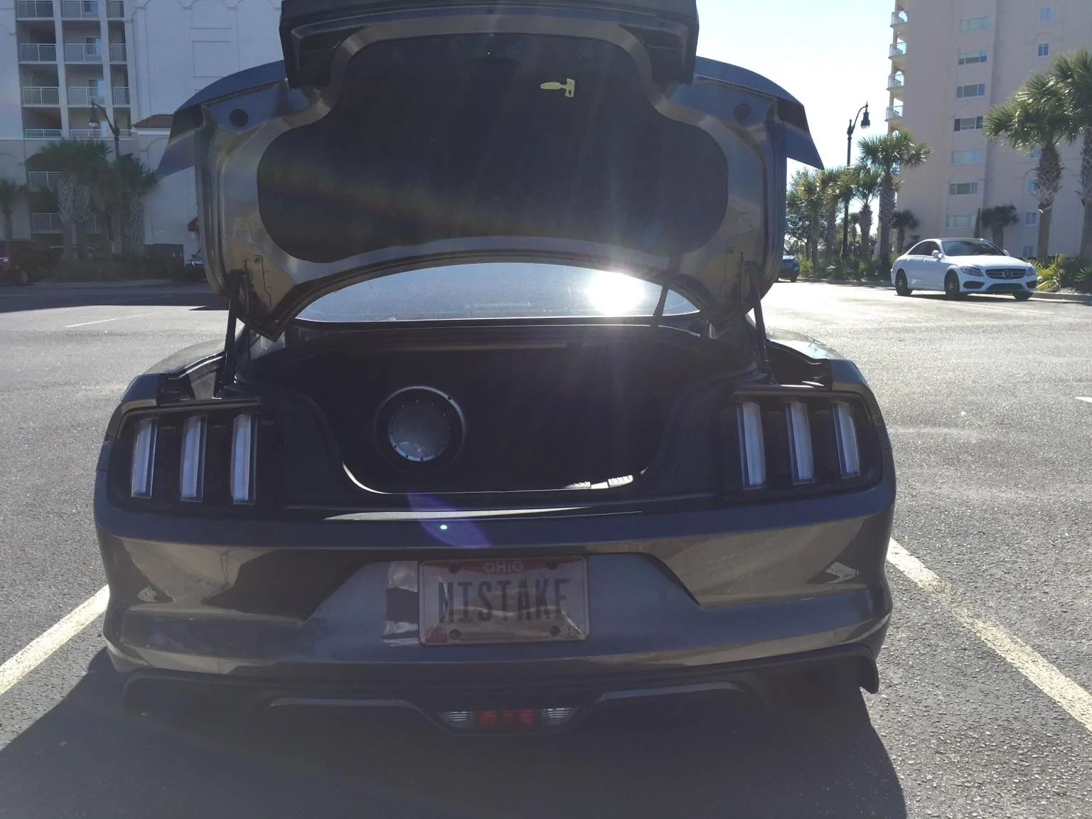

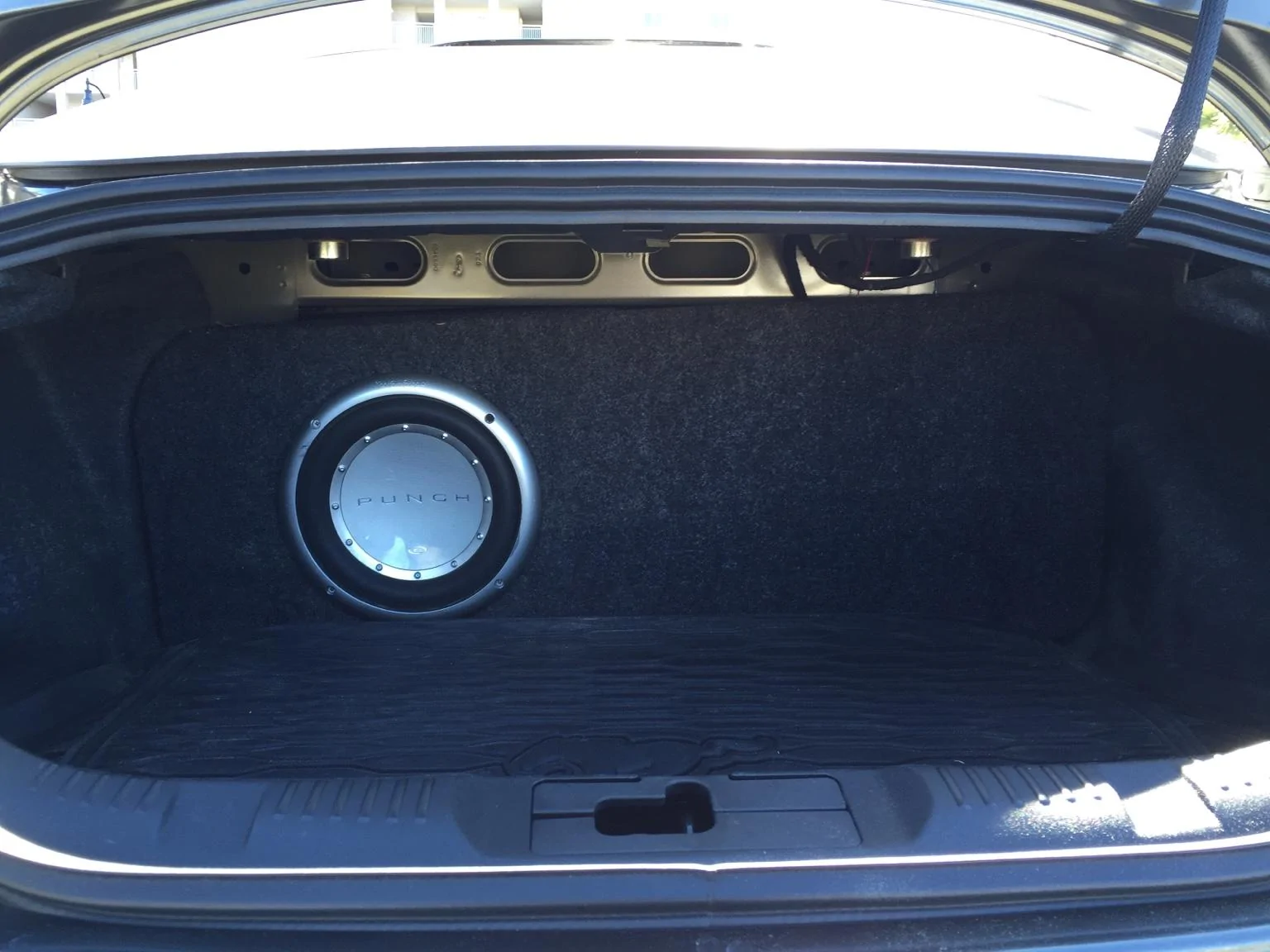

From the looks of my zenclosure it appears I could simply flip the box around and make mine front firing if I chose to. I haven't gotten to that point as I'm still making the hole for the bigger
-_-
--side note if you know what sub you're installing make sure to tell them so they get the diameter for the hole correct. My older Rockford p3 I guess needs a bigger diameter hole then the standard 10inch subs.

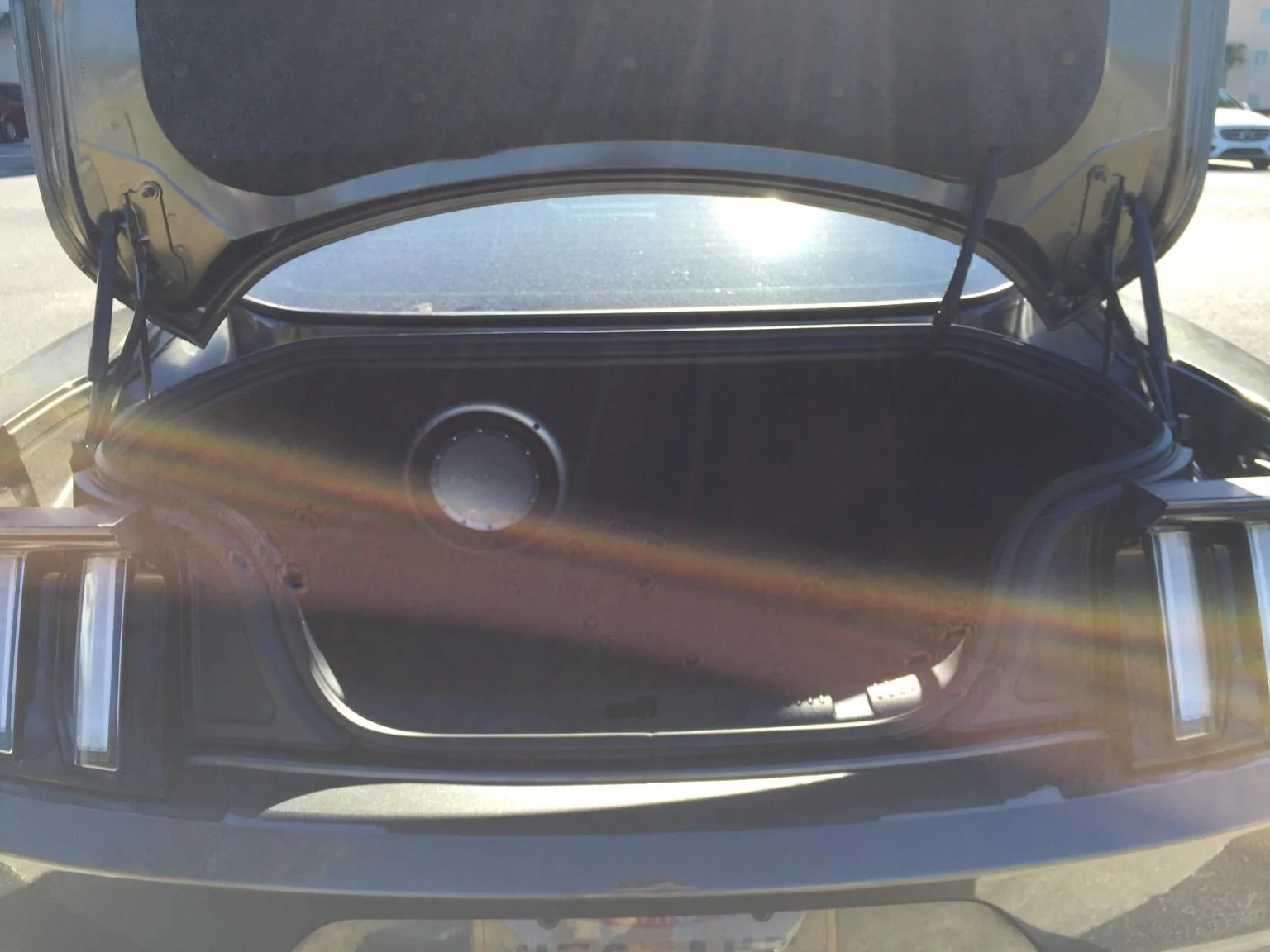

Got the hole big enough to fit the sub. Got the sub mounted to the box, I need to mess with mounting the amp and getting that squared away.

Looks very nice!
Question: It appears to be off center as far as top to bottom. Is that due to the actual enclosure size in relationship to the baffle?

Lol that is because my floor is rasied about 1.5 inches due to my air ride. I braced my floor board up to keep everything hidden underneath without it sitting ontop of it. The hole is actually centered top to bottom
