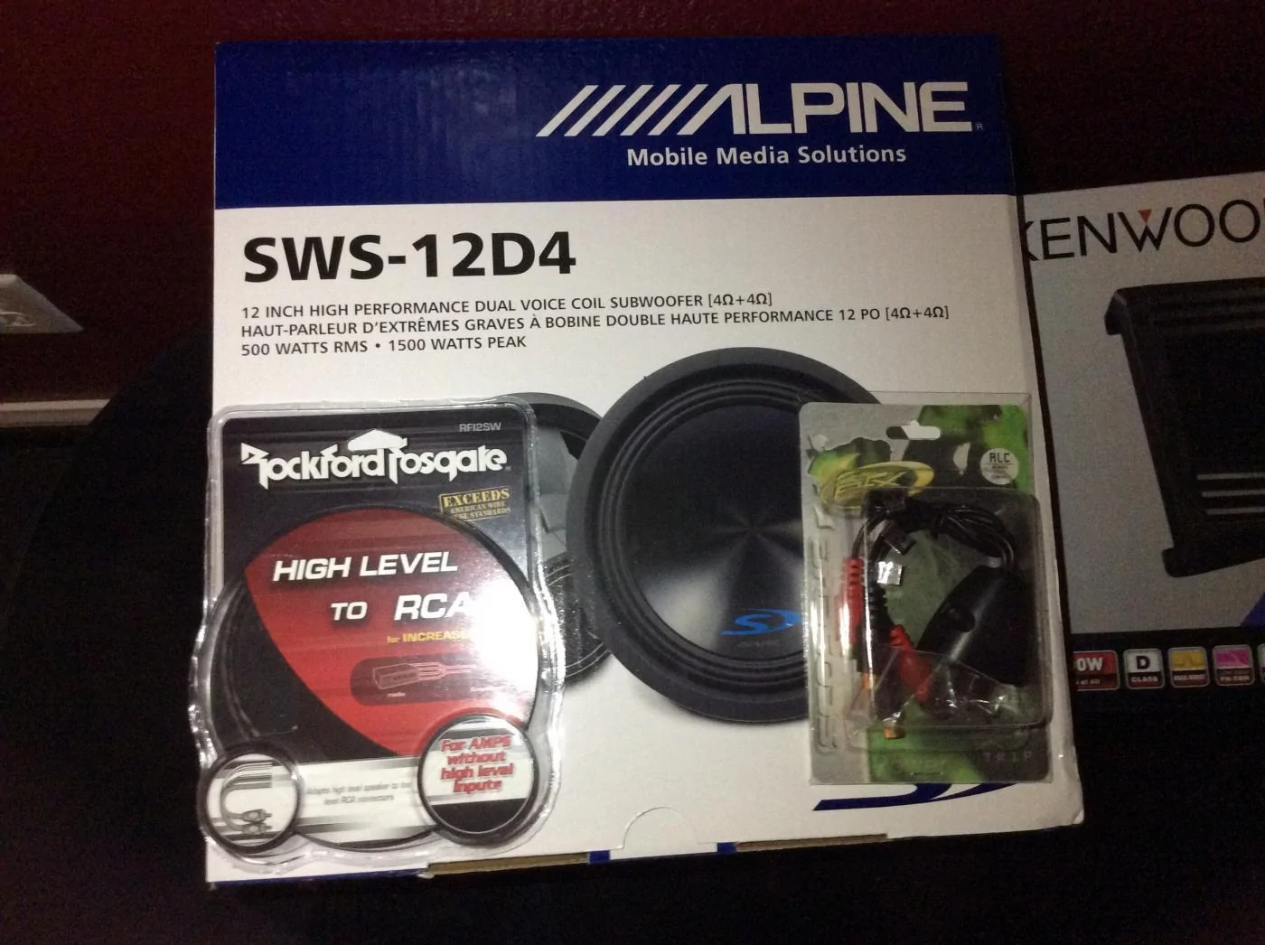

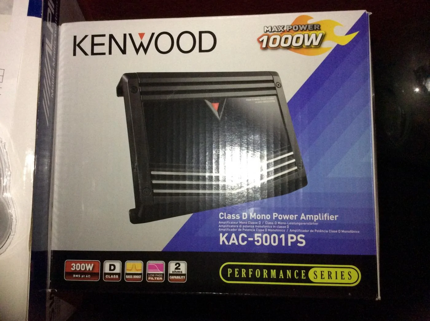

I have received everything except the box (should be here on Thursday) and ready for an install this weekend. I just don't know how I'm going to wire every thing. I'm setting my sub up to 2ohms for 500w. I also bought a LOC and a gain knob with 4rca. Not sure where those four go. Also wondering how I would tune everything being my amp only has input sensitively, bass boost, and lpf frequency... This is all to confusing haha

Here's the amp

The sub, LOC, and remote bass knob

Welp, apparently I cannot use the bass control knob since there is no line out on my amp. Does that mean I can't control how loud the sub is? That sucks :/ also there is no gain setting on the amp unless that's what the bass boost is.

The input sensitivity IS the gain. Yes, you can use the control knob, but why does a modern sub amp not have one already or at least available as an option? Make sure there's not a little plug for an optional remote, that's the way you want to go if you can. To use your control knob, you have to run RCA's from the line level converter all the way up to under the dash where you mount the knob, then another set from the knob back to the amp.
And make sure you do your setup with the remote knob set to MAX. Pretend it's not even there. It's there to cut the signal if you need to. If later you find you need a little more bass with some music, then increase the 'input sensitivity' a little.

Hey,
You can use the bass control knob
here is how I did it:
Connect the speaker cables to the LOC,
connect RCA cables to LOC and then connect to "bass control knob"
Connect second set of RCA cables from "bass control knob" to amplifier
Then you are done :)
I hope that made sense, it works perfectly for me :headbang:

I thought the LOC is to convert the L/R speaker wires at the rear deck speakers, to line-in for your sub? But if the rear speakers have any sort of high-pass filter, then that will not work.
It is was me, I would skip the extra level control. I would just use the controls at the sub amp. After a time, you will arrive at the best overall setting, and then leave it there. At that point, you could use the regular head unit tone controls, if necessary.
The Bass Boost control is probably a parametric EQ filter at a set frequency and set 'Q' value. Or it might be an underdamped HPF2 filter. Then you can boost at that particular frequency if desired. Start with this control at 0. If its center frequency is low enough, it can be used to boost the bottom end of the subwoofer and pull it up back to flat.
As for the low-pass filter setting, that is best determined with an acoustic measurement of the inside of the car first. Again, rear seats up will already provide an acoustic lowpass filter, but I don't (yet) know that characteristic. IOW, it may be best to set the LPF artificially high so as to prevent a "hole" in the mid- or upper-bass band.

Ok it's kinda making sense lol. So here's what I'm getting.
1. Hook up rear deck speakers to LOC
2. Hook up rca cables from loc to remote knob "in"
3. Connect another set of rca cables from remote knob "out" to line in on amp.
Am I correct? Thanks!

Correct. Have fun.
Otherwise, skip the remote volume, and you won't have to run ANY wires to the front and back!
