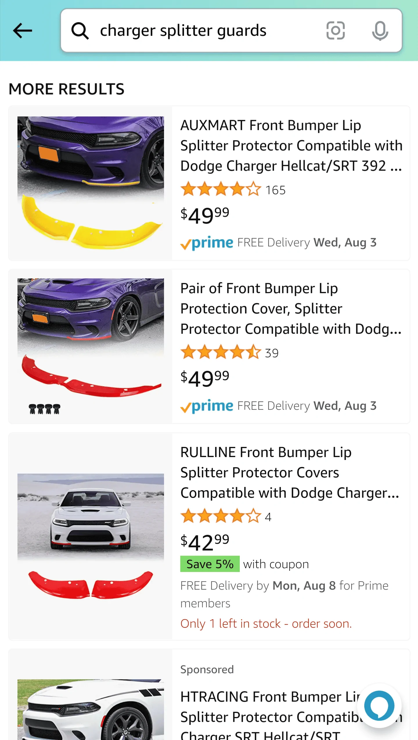

This must be Ford's version of Dodge's yellow splitter guards. lol
It's amazing how many of those Mopar yellow bumpers you see driving around. Sometimes I see someone with only one side on, and tell them they are just for shipping on the truck. Not one person I have mentioned it to, had any idea they were supposed to come off. Some of them wear them as a fashion statement, I guess.
Magnetic Stang
Jun 13, 2022
198
386
Ohio
Chad
2018 Mustang GT
It's amazing how many of those you see driving around. Sometimes I see someone with only one side on, and tell them they are just for shipping on the truck. Not one person I have mentioned it to had any idea.
Classic case of "human see human do". It's turned into an aftermarket demand as well!
