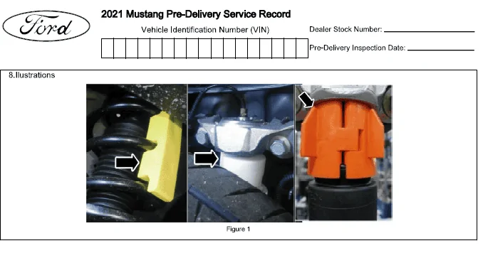

Shocks, red or white, there is another thread in this Mach 1 forum with the PDI sheet showing pictures of the blocks that the dealer service personnel fail to read or even look at the pretty pictures.Top of rear shocks or top of rear springs? Color?
I hope you're right. I don't have a jack that goes low enough to fit under the car. I couldn't see it behind the wheel, tried video with my phone but it was to dark. I could feel near the top of the dust boot but not good enough to say yes or no.So I pulled off my rear wheels tonight after work to check for spacers in the rear shocks and none were there. I could tell my dealer had not taken off my wheels to check this, so I have to conclude that they do not come on the rear shocks of our Mach 1's. If anybody finds different, please advise.
Wheels dont have to be removed to check, rear tires just have to be off ground so that suspension drops.So I pulled off my rear wheels tonight after work to check for spacers in the rear shocks and none were there. I could tell my dealer had not taken off my wheels to check this, so I have to conclude that they do not come on the rear shocks of our Mach 1's. If anybody finds different, please advise.
Did you have the ones on top of the rear shocks too?My blocks were left in too, I reported it to the nice lady that follow up contacted me the next day and asked her for a copy of my PDI sheet, she said she would send it to me and she did. Sure enough the Tech signed off that he removed them, (he did not) and the Service Manager never did a sign off on the PDI sheet nor QC the car in any manner. The nice lady said she would have one of the managers contact me........Never heard a thing from anybody........I think they even blocked my Survey from Ford as that never came either........Second Mustang I purchased from them........
