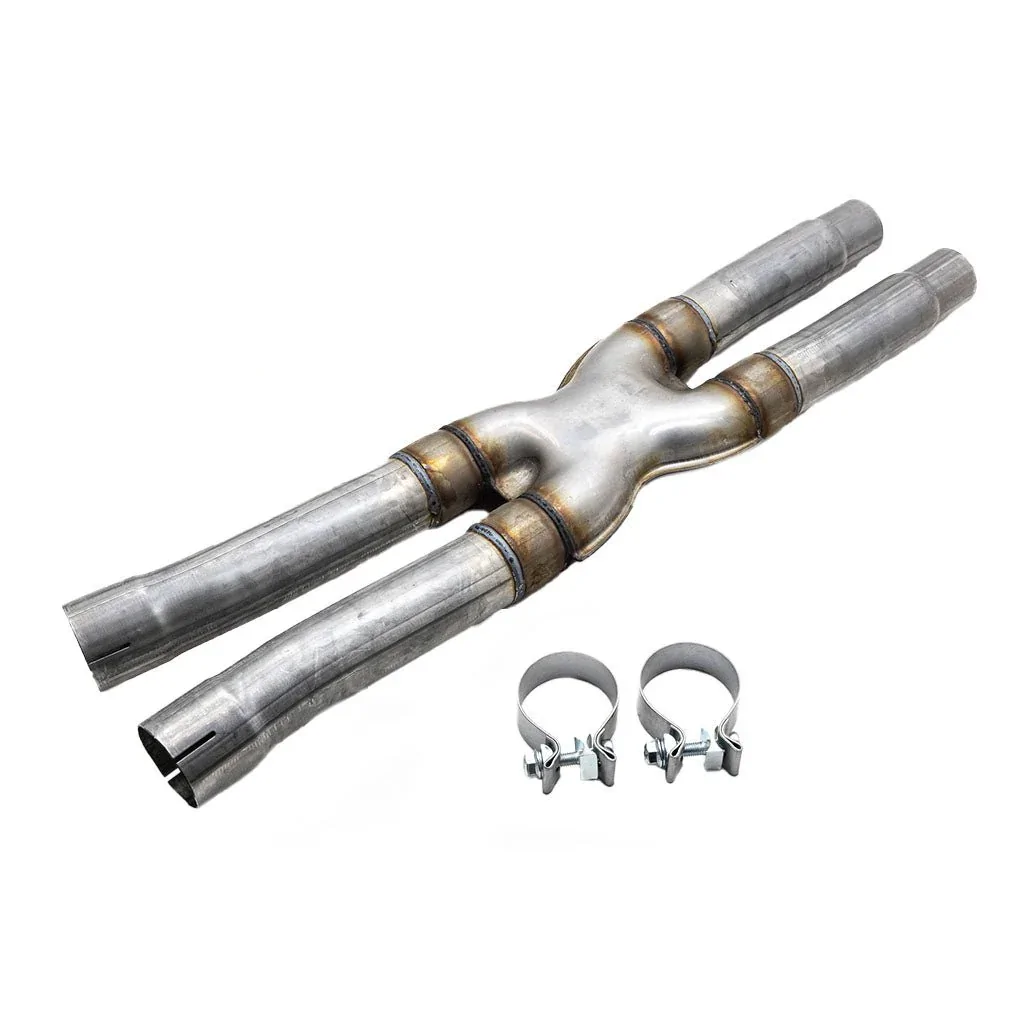

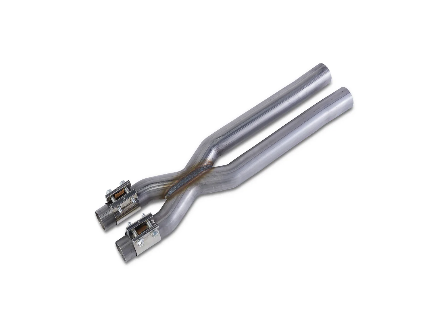

Hi everyone,
I’m hoping someone with expertise can help clarify this.
I currently have a Roush axle-back installed and I’m looking to enhance the sound a bit more. I’m torn between two options: the Ford Performance X-pipe (M-5251-M8) and the MBRP Armor Plus Resonator Delete X-pipe. Both do the same job but both have a different design so my question is: Does the shape/ design of an X-pipe affect sound, drone, or performance?

The top one looks like it would flow better to me. Probably not enough to matter on a NA car but I had the borla x pipe on my turbo set up and wasn't happy with the design so I put a bigger more open x pipe in there and the turbos definitely spool quicker.

Roush, steeda and ford performance x pipes are the same exact design. So I guess it won’t matter.
