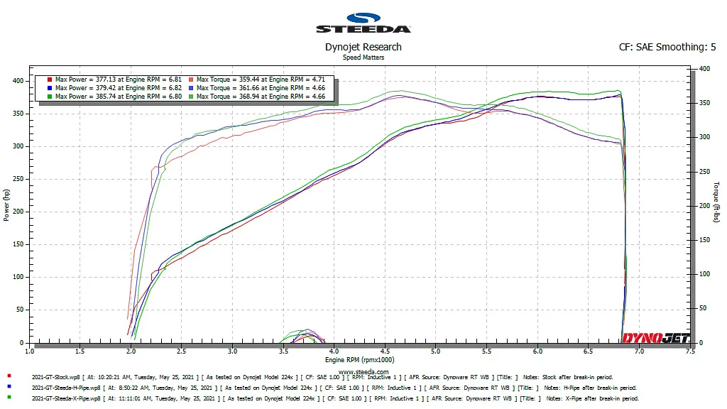

6500 rpms and up on a cross plane crank V8 the true X becomes an issue.
What does 'becomes an issue' mean? I don't see anything happening at 6500 rpm on either of these X pipe dynos
Steeda is a Sweep X design not a True X.
There’s still the designed waist area to be cautious about that it’s not undersized.
