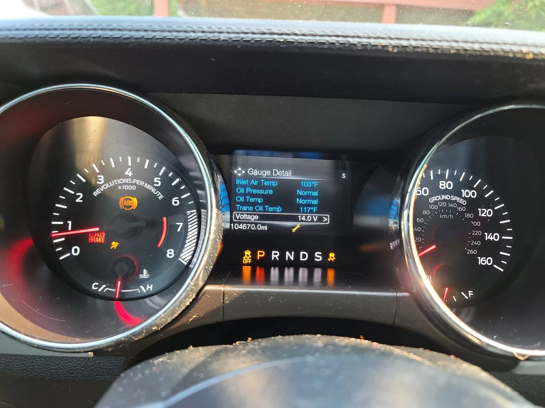

Please help. Power steering got heavy. Drives fine other than that.

How heavy? Like no power steering?
I have to put quite a bit more effort into making a turn especially from a stop. When the car sits and I turn it back on everything appears normal. I put the car in drive or reverse and move. Hill start assists, service traction control, abs, and steering assist. Due to current situation I do not have the luxury of taking it apart, finding a broke part, and fixing it. Really need to diagnose buy part, do it that day. ****ing renting a house at the moment with a steep ass driveway and shitty small garage.
I removed the ground wires, scuffed the with sand paper, made sure I had good metal and contact. I am pretty sure it is not a ground.
Car drives normal other than the power steering. I bounced ideas off a friend, he said sounds like ABS module or power steering rack as well.
