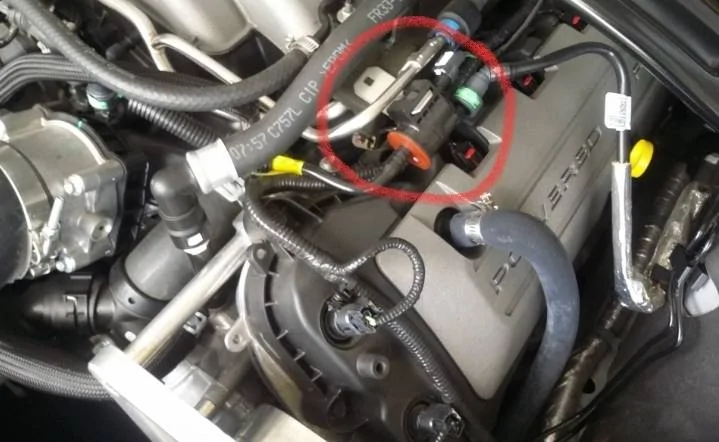

Is it that part? I have a GT so I believe its a whole different part. I have been trying to look for the part online and it doesn't come up and cant even seem to find it on the engine bay
That may well be it. I checked my service manual and it's not on the firewall. It's under the beauty cover on the drivers side just above the fuel rail. It looks very much like what you show.

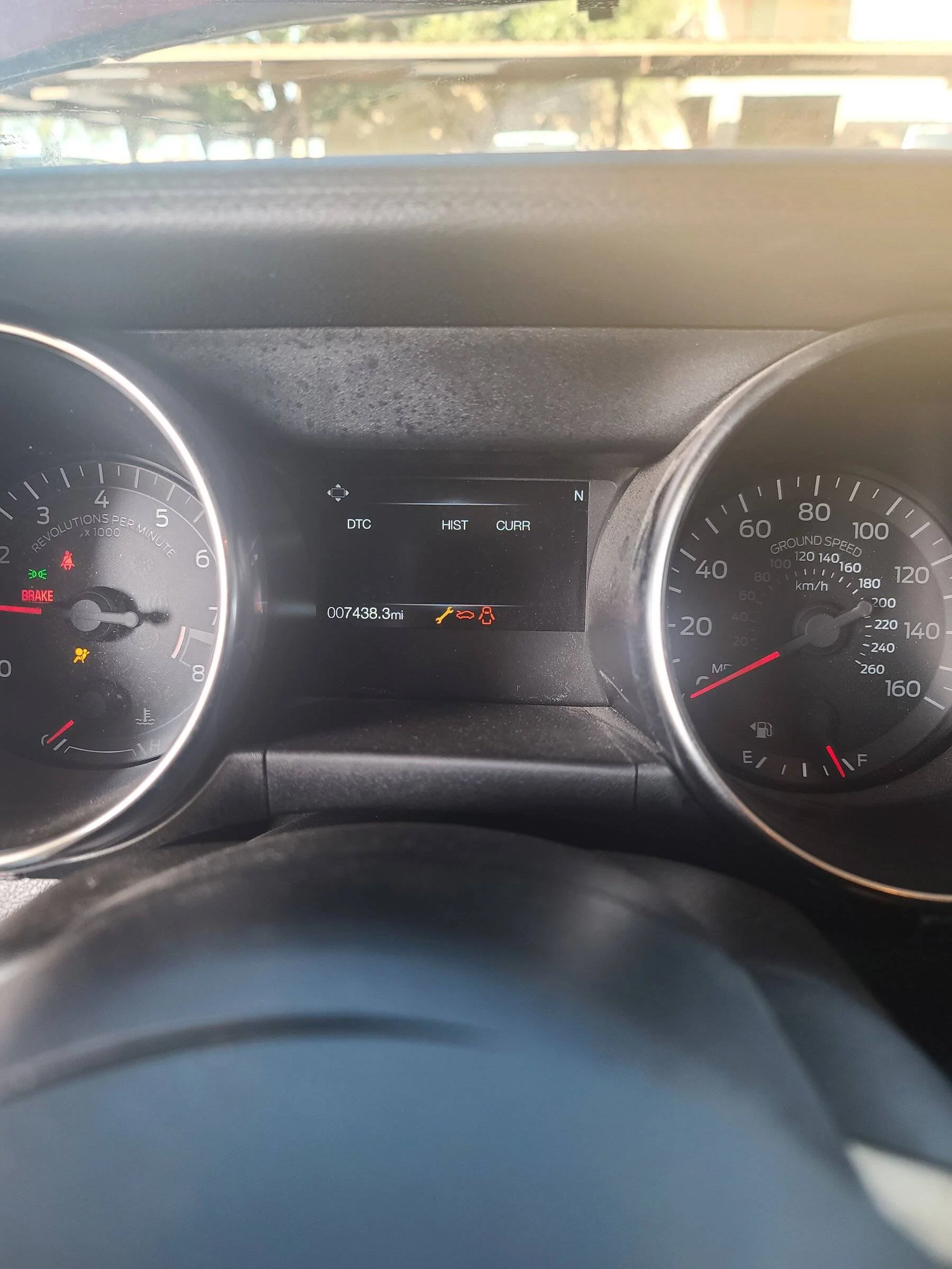

Aside from the above, you should be able to extract DTC's if any are stored even if you're not getting a full on DTC illumination in the dash.
Try getting the DTC using either of these methods based on which dash cluster is in the vehicle. You don't need a code scanner to grab codes you can do it via the Engineer Test Mode:
If you have a 2015-2020 with the ANALOG gauge cluster, you should be able to enter the “Engineer Test Mode”.

If you you have a 2018-2020 with the DIGITAL cluster, you should be able to access the same test mode found here:
https://www.mustang6g.com/forums/th...n-18-digital-dash-old-way-doesnt-work.115231/

No codes at all, that was right after pulling purge valve out and spraying it with some carburator cleaner so I may as well just try get the replacement part. The problem is I can't seem to fins the exact part. The only purge valve sold is the one for 2011-17ish that looks totally different
