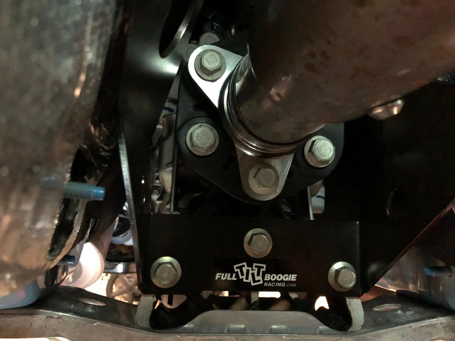

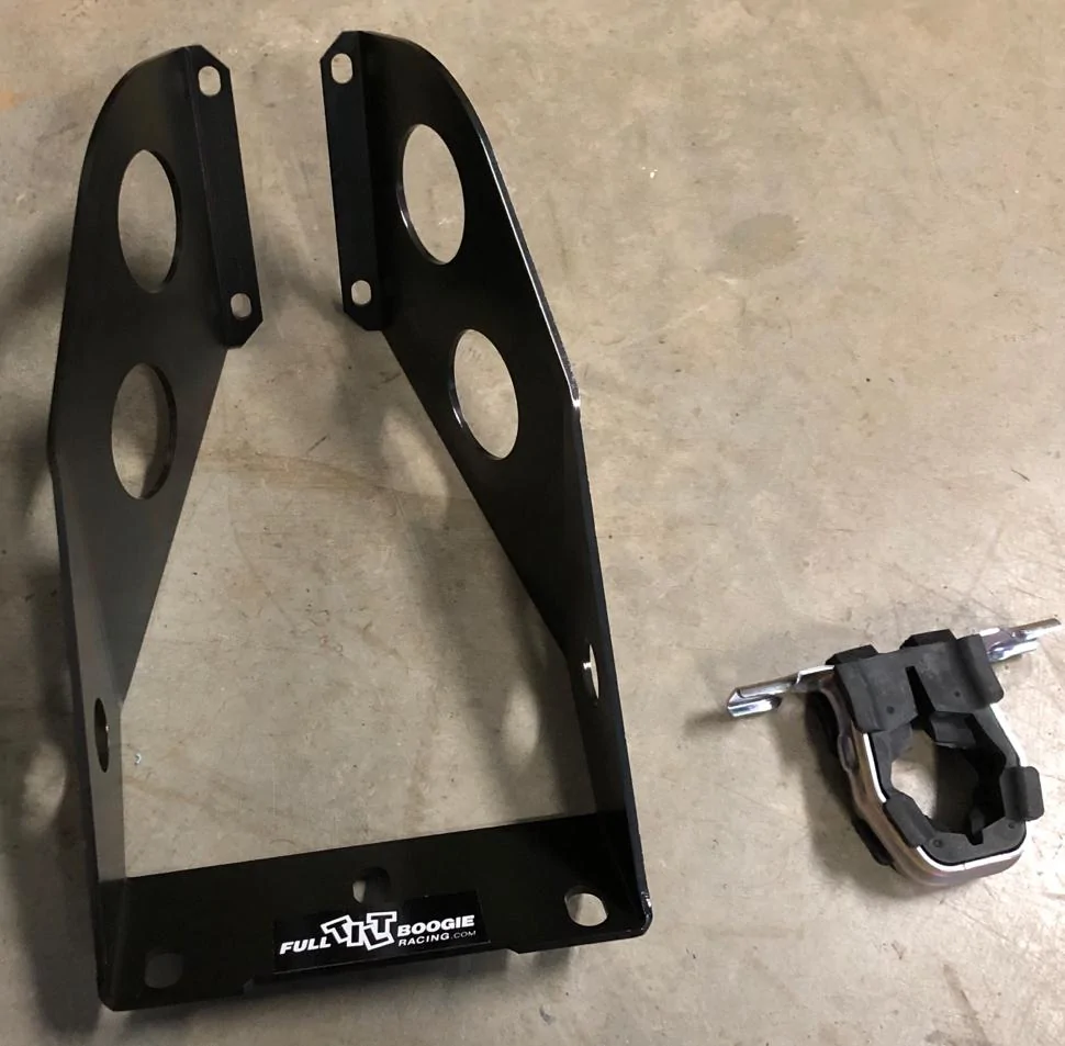

I also completed the install of the FTBR shifter support bracket. Their instructions are good, and as you noted BamcIL, they also tell you to remove the stock bracket. I also removed the Whiteline trans mount insert while I was at it (thanks for the advice). I haven't had a chance to drive it yet (was working on this late in the evening following work) but can say all the slop is gone when just test shifting. Here is an image of the brackets for comparison sake and of the completed install.
For anyone else considering this, it's a top notch piece of work from FTBR, the install is straight forward, and can be done on jack stands in your garage. Have several extensions, a swivel for the small bolts on the shifter body (unless you plan to drop the drive shaft), a little patience and boom!
