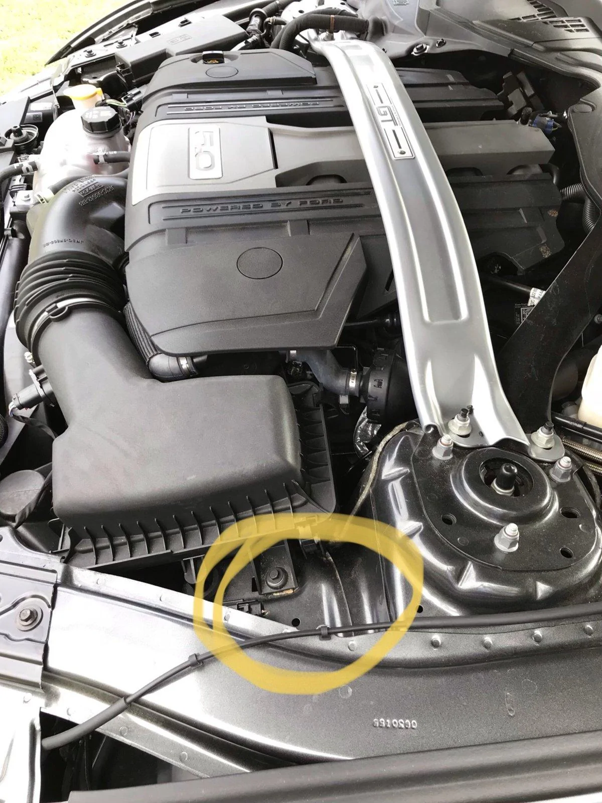

Left my 18 GT in storage while deployed. Came back and noticed stability trac & traction control lights were on dash. Took her in for an oil change and tech said there was a rat nest on driver side, under the hood. Wiring harness could be repaired for $250, but it’s only a $40 part... Anyway, can somebody send me a picture of their harness?? Part number is 3u2z-14s411-feab.

I’m not at home but I know that plug is used to turn off abs and other stuff for dyno use. The wire plugs back into itself. Like a u shape

Your all good. That connector is supposed to be like that.

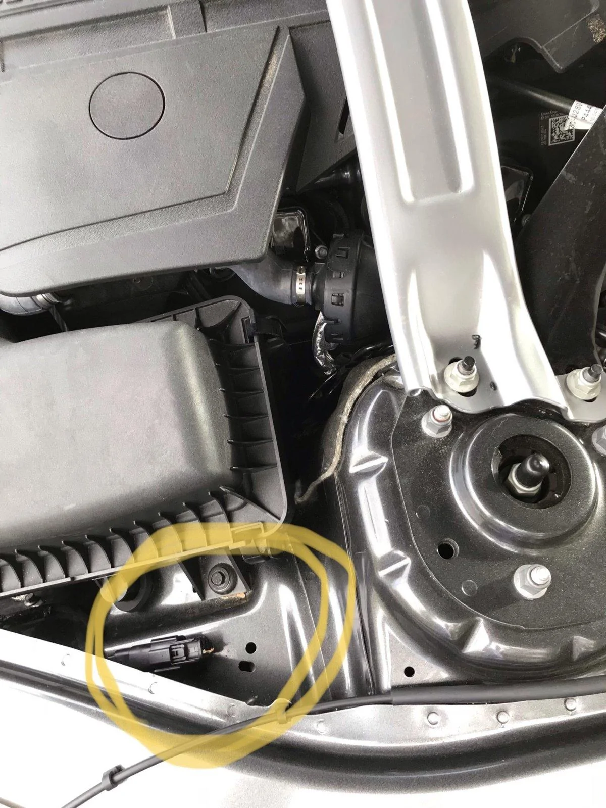

That connector is missing the small wire, like others said, it’s just a “loop” that is normally on the end of that connector - it doesn’t go to anything other than back into itself.
$40 part for $250 repair just for the Tech to unplug, discard and plug the new part in, in less than 2 mins??
Just buy the part and save yourself the $250!
