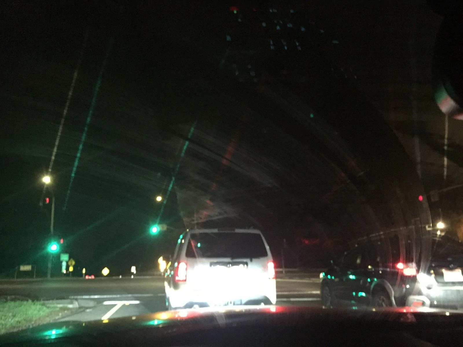

My ‘19 GT is only a month old. If I use the wiper spray when driving, the streaks left by the wipers makes it worse.
Am I missing something?

Check the edges of the blades for stuck on crap or irregularities.

Contamination on windshield clean it
Yep, go to YouTube & search for any number of how-to vids for a squeaky-clean windshield. Also use isopropanol to wipe down the blades or swap-out for a high-quality set of blades. If you use an automated car wash don’t get spray wax...it mucks up the windshield.

Ok thanks for replies. I’ll clean the blades. Have never gone thru a car wash or waxed the car yet. I do have a glass cleaner bottle in the garage that I clean the windshield with and it works well.

Also verify what is in the res.
One time the (vw) dealer used concentrate instead of the diluted solution and it was a mess...

My passenger blade left a couple of small lines (like there were nicks in the blade) from day one. On my previous car I used Bosch blades, the ones without a frame. They lasted forever and always wiped perfectly and never chattered.

I'm with the OP. It should wipe clean. Ford needs to work on wiper arms and springs, and even the blades.
